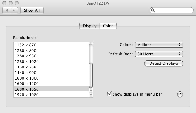

But I accidently got my M2600 running at full HD :D:unsure::D :D :D :D
I opened the ATIRaedon2000.kext/contents/info.plist and changed two values

The line:
"<string>0x94001002 0x94011002 0x94021002 0x94031002 0x95871002 0x95831002 0x95881002 0x94c41002 0x94c91002</string>"
I change one value to 0x98571002 and another to 0x94c41002
both being id's for 2600 hd agp and the other is the 2600 mobility.
the attachment below shows this.
The only thing now is I'm lost to get it working on the laptop screen :wacko: :wacko:
