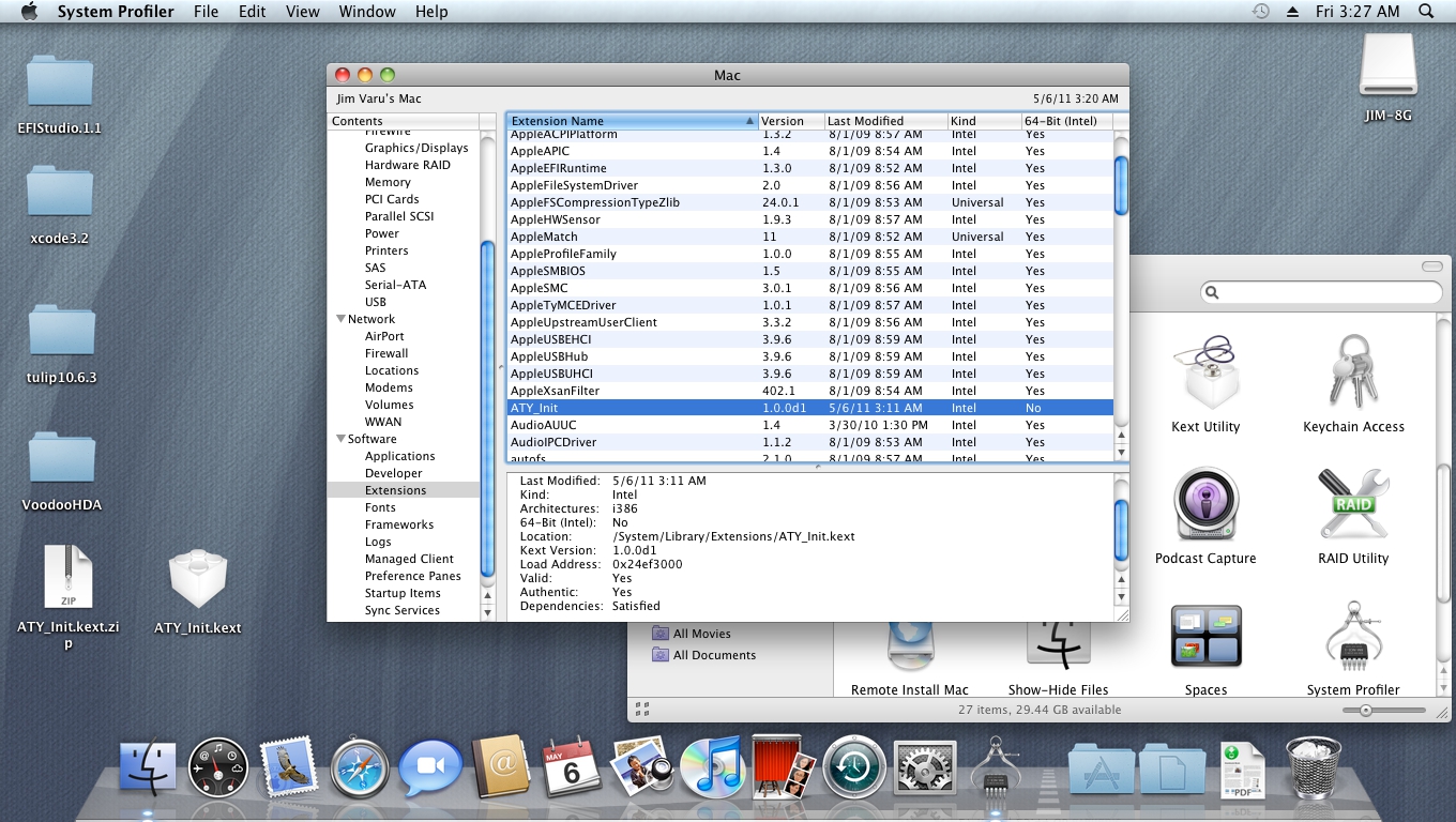

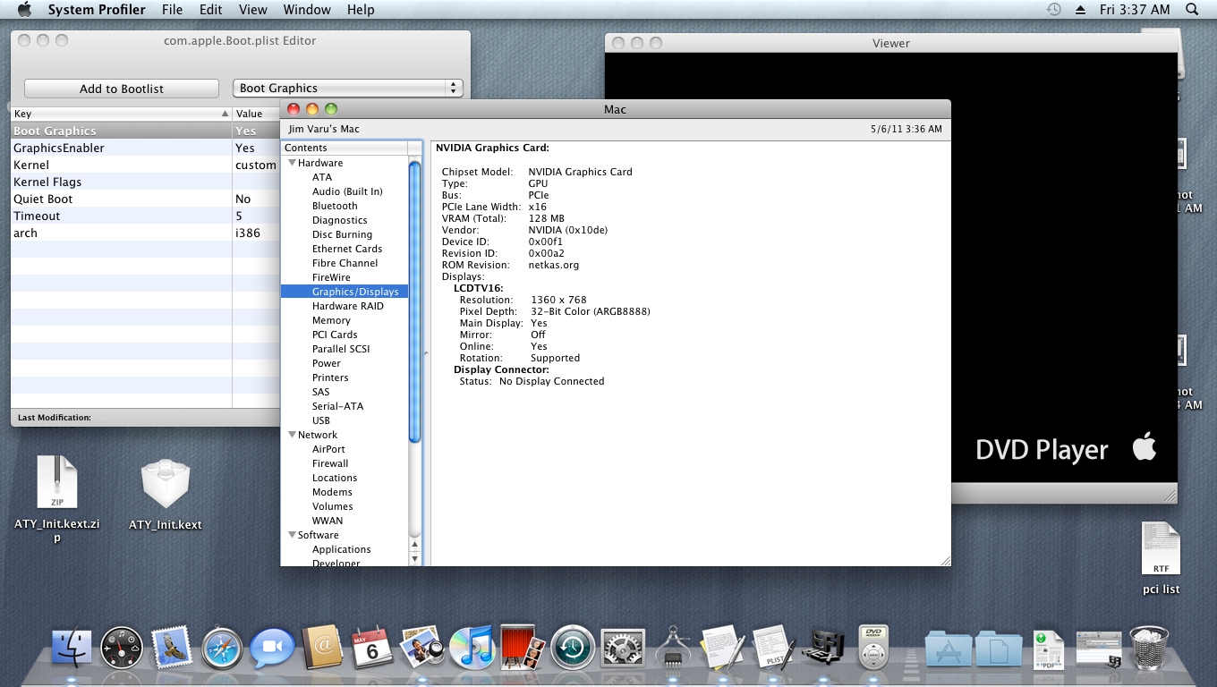

wonderbgr Posted May 6, 2011 Share Posted May 6, 2011 NV43 GeForce 6600GT AGP [DVI/VGA} Works fine!!! QE-CI Working!!! with ( ATY_Init.kext 32bit ) on SnowLeopard 10.6.3 TNX!!!!!! output: 19" LCDTV DVI Display , vga out must work too , not tested My system spec: iatkos S3 V2 (10.6.3) Pentium4 3.0Ghz Prescott (478pin) sse3.. Albatron PX865PE PRO (Intel 865PE/ICH5) 2 GB Ram Kingston nVidia 6600Gt AGP 128MB 01:00.0 VGA compatible controller [0300]: nVidia Corporation NV43 [GeForce 6600 GT] [10de:00f1] (rev a2) installed options: iATKOS S3 Main System , Bootloader(AsereBLN v1.19) , Bootloader Opt(32-bit boot,Graphics Enabler) , /Extra directory(fakesmc V2.5, Disabler, RTC(32bit), Modified Kernels(qoopz 10.3.0), EVO Reboot) , Main Hardware(Intel SATA, Voodoo PS/2, NTFS3G) I download ATY_Init.kext in desktop , i set chown-chmod and then drag'n'drop into KextUtility.v2.3.2(great tool!!!) then restart and QE/CI Enabled!!! DVDPlayer Starts without any error!!! Ill upload 2 screenshots... Link to comment https://www.insanelymac.com/forum/topic/185428-geforce-6200-agp-on-sl/page/4/#findComment-1679720 Share on other sites More sharing options...
