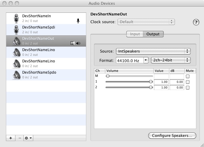

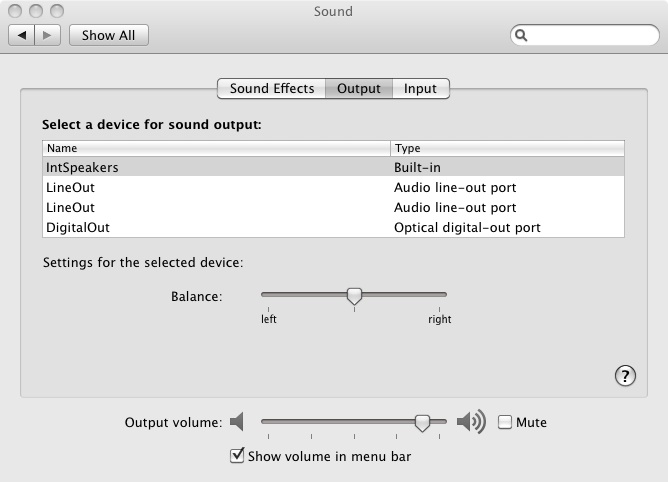

Thanks for all your help, just one more thing:
Is there a way to edit the names in Audio Midi Setup??
Regards,
Steve.
Regards,
Steve.
Since these are the OS X system default devices and hence default names, I think that you may have to create a new Aggregate Audio Device (with the device names you choose) for each of your external MIDI devices (although I would expect an external MIDI device to 'report' its name to OS X) and select the input and outputs device(s) associated with each new device name……..

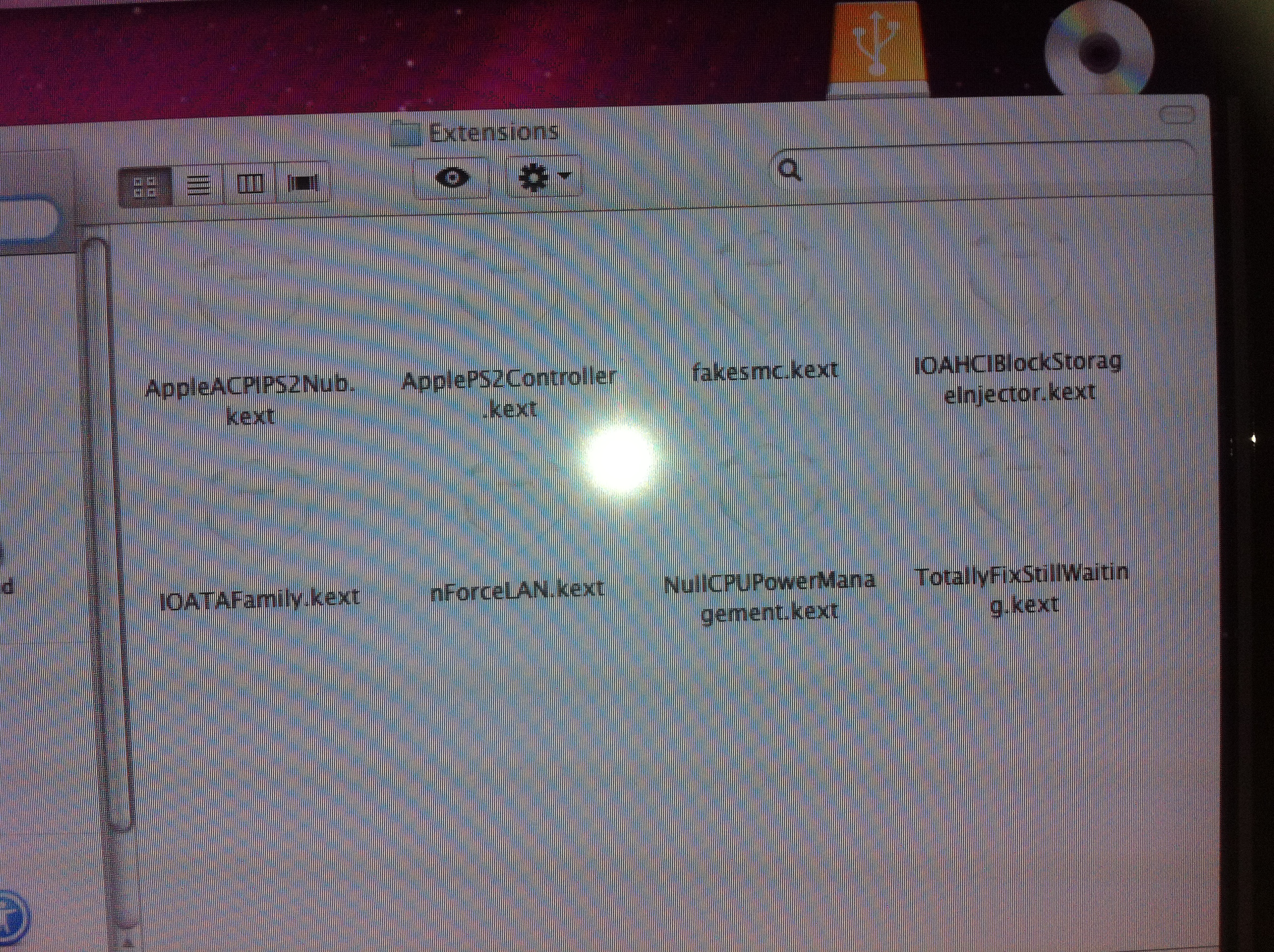

I wanted to add another PCI NIC known to work OTB. I got tired of eno's nForceLAN causing problems with some NFS shares, causing a long lag before shutdown, etc; so I went out and purchased a Rosewill RC-401-EX. I was going to originally get the Netgear GA311 since I knew it would work, but I read Lion has some issues with it and it now requires an additional kext, but the RC-401-EX works with both SL and Lion OTB. It works great, but I did have an issue with it not showing up as "built-in" and therefore the Mac App Store and other programs had some problems, but this was resolved by adding the Ethernet to my EFI Strings using EFIStudio. The
<key>EthernetBuiltIn</key>
<string>Yes</string>
portion of the com.apple.Boot.plist would not work for me, but EFI Strings did.
I have had no problems with eno's nForceLAN.kext (version 0.64.5)........my connected onboard LAN port is picked up as Ethernet (en0) even with
<string>No</string>
in org.chameleon.Boot.plist......thus I see in System Report:

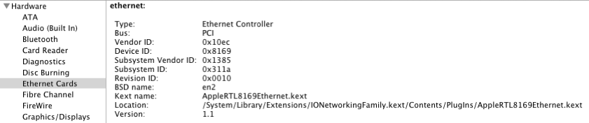

while for my Netgear GA311, all I had to do was put the AppleRTL8169Ethernet.kext from 10.6.8 in the PlugIns folder of the Lion IONetworkingFamily.kext, from which it is/was missing i.e. no longer included in OS X Lion IONetworkingFamily.kext........the Netgear GA311 is recognised as en2:
and both ports are connected to the internet:
and I can connect to the App Store......

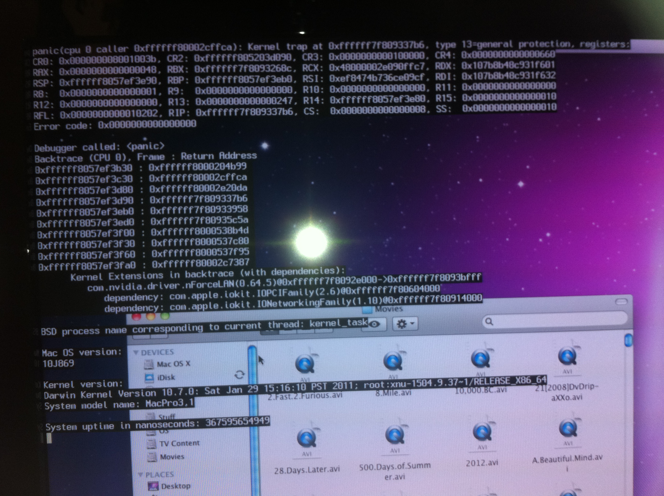

eno's nForceLAN.kext worked great for 99% of time. Everything shows up just fine. The issues that I had might be uncommon and it is hard to figure out where the blame it.
I have an unRAID server (which runs a modified version of Slackware Linux) sharing out all of my media (including all of my iTunes collection) via SMB and NFS shares. My Mac Mini never has issues using either SMB or NFS shares, but my hackintosh, with eno's kext, would freeze at certain heavy load times when using NFS shares. It never had an issue with SMB shares. When I mention heavy load times, this would be while transferring a 20GB+ file or doing anything with my iTunes library (220GB+ with ~20k songs). Again, oddly, never had an issue with SMB. Since I installed the PCI NIC, I haven't had a single problem with the NFS shares. Like I said, it is probably an uncommon issue, but enough of one for me to look for a better solution. Also, since my NIC works OTB, the decision was made even easier allowing me to dump one more kext.
All of this was with using 0.64.5. Of course, 0.64.6 never had a chance....it was way too problematic. 0.64.6 would lose connection, forcing me to bring down the connection and back up again, but 0.64.5 did have the issues with NFS.

What kexts have you got in /Extra/Extensions/.......?
Are you using a USB keyboard and USB mouse.......?
I am using USB mouse and Keyboard, and have taken a photo of the contents of E/ E, as i dont know of any other way of telling you other than typing them in.
In which case you do not need AppleACPIPS2Nub.kext, ApplePS2Controller,.kext in /E/E/.........and set up your BIOS as in my OS X 680i template........
1. You should only need (with SATA HDDs) to have in /Extra/Extensions/:
AppleNForceATA.kext (AppleNForceATA.AnV.kext or AppleNForceATA.slash.kext from Snow Support Files v2.3 .....see post #1)
FakeSMC.kext
NullCPUPowerManagement.kext
OpenHaltRestart.kext or EvoReboot.kext
and nothing else if you are using Chameleon 2.0 RC4 or 5 as your bootloader........

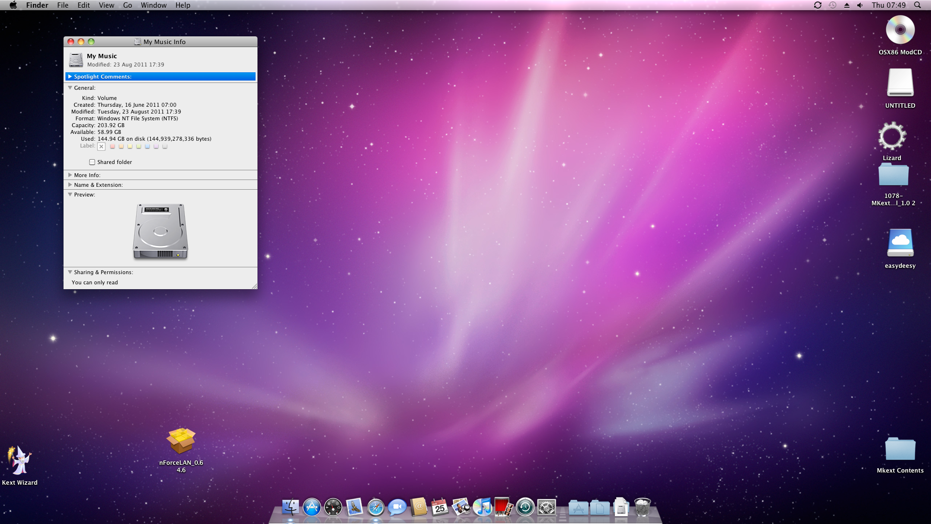

Okay great, done everything above - im now booted into 32bit mode.
Are there any tests that you would recommend i do to test the system?
EDIT - i notice that i only have Read access to all the SATA drives....
Glad you up and running in 32bit mode.......:)
You can check for full CI/QE......see post #1
You can do some heavy data transfers / downloads
I presume you have checked USB mounting/unmounting; sound; networking; Firewire (if you have it/use it) etc.
Right-click HDD volume icons and select Get Info......click on padlock in bottom RHS corner.......then look at Sharing and Permissions......see if you can change to read:
system = Read & Write
admin = Read & Write or wheel = Read & Write
everyone = Read Only
'Ignore ownership on this volume' box left unchecked
There is no padlock displayed bottom right.... Is that because drives are formatted NTFS?
EDIT - When watching a video, I get about 2 mins in and the pc locks up. However there is no obvious kernel panic, and the clock continues to change!
I thought you were referring to OS X on a SATA HDD.........yes, there is no padlock displayed bottom right for non-OS X volumes......OS X is set up to naturally read/write FAT32 volumes but only to read NTFS volumes......to read/write NTFS volumes see here and here for commercial solutions and here for freeware solution...
What app are you using to watch videos.....?
Boot with debug=0x100 debug=0x144.....use debug=0x100 first and watch a video and then use debug=0x144 and watch the same video.......you may see what error messages pop up when the lockup occurs......
