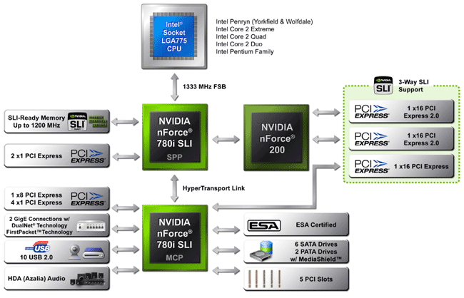

So I don't mean to get into the middle of this conversation, but I've done some research, and one member suggested deleting the IOFireWire kexts to make all 4 cores work. I tried this, and it worked. However, I use OS X mainly for Logic and music production, and I need my firewire audio interface to work. Is there any way around this? deleting those kexts is the only way that I could make the system stable for more than 5 minutes.
The interface is a PreSonus Firebox, not sure if that information is needed.
Running a 780i 3-way SLI mobo w/ Q9300 CPU and 4 GB ram.
Option [1] See if you can get a x16 PCI-e Firewire card because the x16 PCI-e bus runs to the Northbridge of the processor, which provides more reliable access to the processor because it only manages the data from the x16 PCI-e slots and RAM.......
Or [2] Boot with cpus=1 maxmem=2048 when using Firewire ports.......see here.
