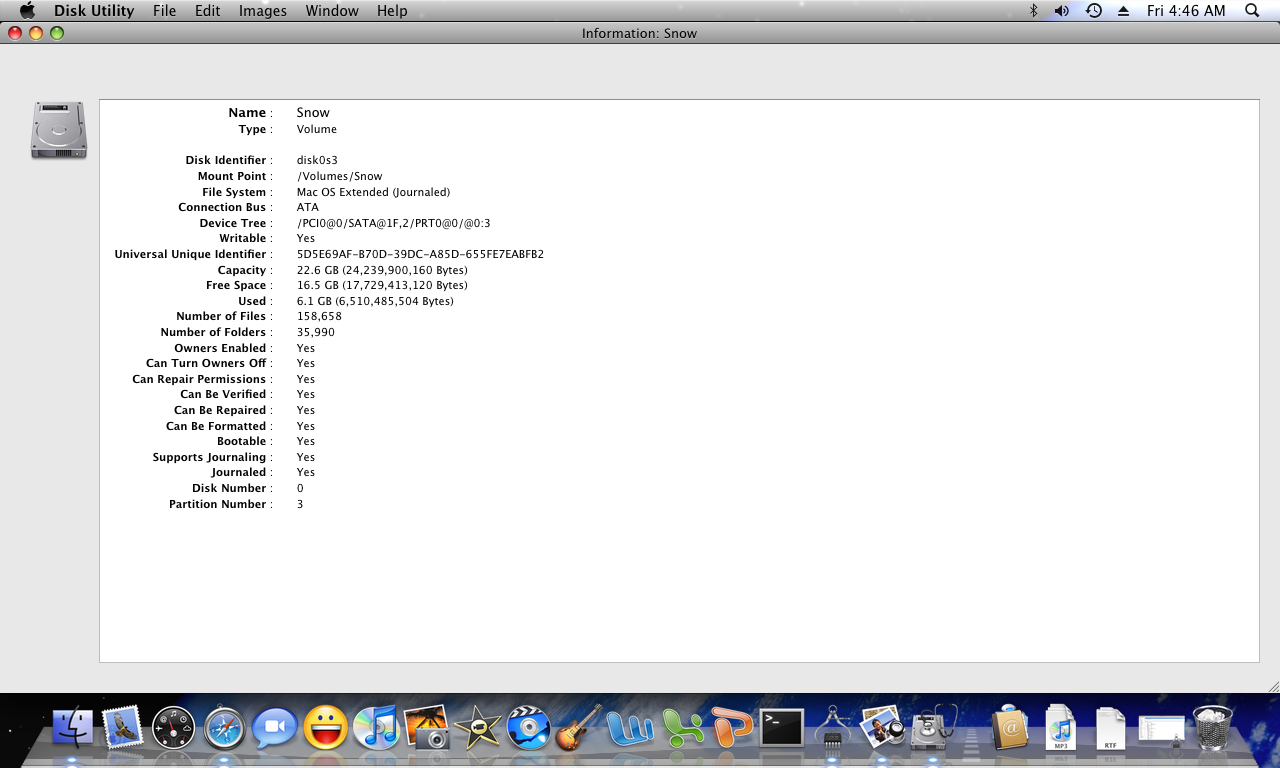

Flashe Posted September 6, 2009 Share Posted September 6, 2009 Hi, Why not work with an IDE HDD>>>>Open Disk Utility select the drive Snow, click [info] look at the UUID (Universal Unique Identifier), eg UUID=xxxxxxxxxx and mode IDE Bios ? Thank you for your explanation. Link to comment https://www.insanelymac.com/forum/topic/183720-guide-snow-leopard-106-retail-on-abit-ip35-e/#findComment-1253775 Share on other sites More sharing options...
Arial Posted September 6, 2009 Author Share Posted September 6, 2009 @Flashe: sorry I can't help you. it would be better if you post on new topic "Snow 10.6 on HDD IDE problem" Link to comment https://www.insanelymac.com/forum/topic/183720-guide-snow-leopard-106-retail-on-abit-ip35-e/#findComment-1253930 Share on other sites More sharing options...

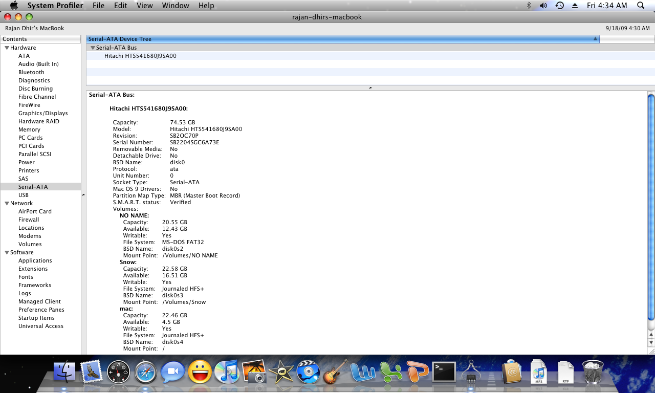

osx psychodude Posted September 17, 2009 Share Posted September 17, 2009 hey hi i tried using your method i dont understand some parts of it though the first part says "HDD must be installed on the SATA port #1/#2. This is because of the limitations AppleIntelPIIXATA.kext not support SATA port #5-#6 in the mobo Intel non-AHCI like Abit IP35-E. Not sure if with IDE-HDD, it could be working with fixed JMicronATA.kext . If Snow will be installed into a single HDD with GPT scheme together with the other OSX (eg OSX 10.5) then Snow partition must be at the top/beginning. This is to avoid KP (bootloader conflict or mislead Extension.mkext) like this" i am attaching screen shot of sys profiler ( i have ich7 945 gm chipset) the next part i dont understand is the preparation part 3 the info looks like this and where do i add the platform uuid. where are these files found? com.apple.Boot.plist - smbios.plist - info.plist PlatformUUID.kext and do i prepare the vga enabler before or after the install? where should i install? on snow or on my leopard Link to comment https://www.insanelymac.com/forum/topic/183720-guide-snow-leopard-106-retail-on-abit-ip35-e/#findComment-1269992 Share on other sites More sharing options...
Arial Posted September 17, 2009 Author Share Posted September 17, 2009 I have the problem with sleep as well.Btw very nice guide, except sleep everything works fine sorry, I've never get 'sleep' to work in L/SL hey hi i tried using your methodi dont understand some parts of it though i am attaching screen shot of sys profiler ( i have ich7 945 gm chipset) the next part i dont understand is the preparation part 3 the info looks like this and where do i add the platform uuid. where are these files found? - com.apple.Boot.plist - smbios.plist - info.plist PlatformUUID.kext and do i prepare the vga enabler before or after the install? where should i install? on snow or on my leopard you are using MBR (not GUID), then set active Snow partition. find smbios.plist com.apple.Boot.plist PlatformUUID.kext in my package file. download it. VGA enabler should be prepare before you boot Snow. Link to comment https://www.insanelymac.com/forum/topic/183720-guide-snow-leopard-106-retail-on-abit-ip35-e/#findComment-1270042 Share on other sites More sharing options...
osx psychodude Posted September 19, 2009 Share Posted September 19, 2009 sorry, I've never get 'sleep' to work in L/SL you are using MBR (not GUID), then set active Snow partition. find smbios.plist com.apple.Boot.plist PlatformUUID.kext in my package file. download it. VGA enabler should be prepare before you boot Snow. hey i installed snow leo but i cant boot up ( i still get the same kernel panic) you got any idea? am i missing kext or something? i am posting my lspci output 00:00.0 Host bridge: Intel Corporation Mobile 945GM/PM/GMS, 943/940GML and 945GT Express Memory Controller Hub (rev 03) 00:02.0 VGA compatible controller: Intel Corporation Mobile 945GM/GMS, 943/940GML Express Integrated Graphics Controller (rev 03) 00:02.1 Display controller: Intel Corporation Mobile 945GM/GMS/GME, 943/940GML Express Integrated Graphics Controller (rev 03) 00:1b.0 Audio device: Intel Corporation 82801G (ICH7 Family) High Definition Audio Controller (rev 02) 00:1c.0 PCI bridge: Intel Corporation 82801G (ICH7 Family) PCI Express Port 1 (rev 02) 00:1c.1 PCI bridge: Intel Corporation 82801G (ICH7 Family) PCI Express Port 2 (rev 02) 00:1c.2 PCI bridge: Intel Corporation 82801G (ICH7 Family) PCI Express Port 3 (rev 02) 00:1d.0 USB Controller: Intel Corporation 82801G (ICH7 Family) USB UHCI Controller #1 (rev 02) 00:1d.1 USB Controller: Intel Corporation 82801G (ICH7 Family) USB UHCI Controller #2 (rev 02) 00:1d.2 USB Controller: Intel Corporation 82801G (ICH7 Family) USB UHCI Controller #3 (rev 02) 00:1d.3 USB Controller: Intel Corporation 82801G (ICH7 Family) USB UHCI Controller #4 (rev 02) 00:1d.7 USB Controller: Intel Corporation 82801G (ICH7 Family) USB2 EHCI Controller (rev 02) 00:1e.0 PCI bridge: Intel Corporation 82801 Mobile PCI Bridge (rev e2) 00:1f.0 ISA bridge: Intel Corporation 82801GBM (ICH7-M) LPC Interface Bridge (rev 02) 00:1f.2 IDE interface: Intel Corporation 82801GBM/GHM (ICH7 Family) SATA IDE Controller (rev 02) 00:1f.3 SMBus: Intel Corporation 82801G (ICH7 Family) SMBus Controller (rev 02) 02:00.0 Network controller: Intel Corporation PRO/Wireless 3945ABG [Golan] Network Connection (rev 02) 04:00.0 Ethernet controller: Marvell Technology Group Ltd. 88E8038 PCI-E Fast Ethernet Controller (rev 14) 05:09.0 CardBus bridge: Texas Instruments PCIxx12 Cardbus Controller 05:09.1 FireWire (IEEE 1394): Texas Instruments PCIxx12 OHCI Compliant IEEE 1394 Host Controller 05:09.2 Mass storage controller: Texas Instruments 5-in-1 Multimedia Card Reader (SD/MMC/MS/MS PRO/xD) 05:09.3 SD Host controller: Texas Instruments PCIxx12 SDA Standard Compliant SD Host Controller Link to comment https://www.insanelymac.com/forum/topic/183720-guide-snow-leopard-106-retail-on-abit-ip35-e/#findComment-1273162 Share on other sites More sharing options...
