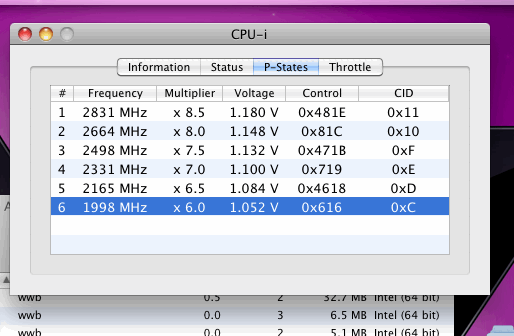

hackcat Posted September 6, 2009 Share Posted September 6, 2009 Anybody working on speedstep through dsdt? Found some sites, but values are CPU specific. And dsdt entries vary greatly by motherboard manufacturer. Anybody found anything for the Q9550 on a gigabyte board? TYIA Check outDSDT - Vanilla Speedstep - Remove _cst errors for MB without C-states If you install cpu-i (check linked thread) and your board has p-states you can get the values for your cpu easily. You can also use a calculator posted in that thread. I had speedstep working but i think I ended up with a pretty bad stutter case on audio and choppy dock animations. Also sleep no longer worked. Although strangely if I moved my mouse a lot, the stutter went away. Despite all those problems it did transition nicely to the different speedsteps. You might have better luck. Link to comment https://www.insanelymac.com/forum/topic/182925-uhciehci-built-in/page/2/#findComment-1254289 Share on other sites More sharing options...
tapper00` Posted September 6, 2009 Author Share Posted September 6, 2009 Check outDSDT - Vanilla Speedstep - Remove _cst errors for MB without C-statesIf you install cpu-i (check linked thread) and your board has p-states you can get the values for your cpu easily. You can also use a calculator posted in that thread. I had speedstep working but i think I ended up with a pretty bad stutter case on audio and choppy dock animations. Also sleep no longer worked. Although strangely if I moved my mouse a lot, the stutter went away. Despite all those problems it did transition nicely to the different speedsteps. You might have better luck. Thanks hackcat, Found that thread. CPU-i shows 6 p-states for my CPU. Gonna give it a try. I have SL running so solid right now and if I end up with the stutter issue I will just have to live without speedstep. Link to comment https://www.insanelymac.com/forum/topic/182925-uhciehci-built-in/page/2/#findComment-1254362 Share on other sites More sharing options...
hackcat Posted September 6, 2009 Share Posted September 6, 2009 Well it turns out the problem isn't with defining p-states but borrowing c-states from MacPro3,1. Using a dsdt with only p-states I don't have the stutter problem, nor do I have problems going to sleep. Link to comment https://www.insanelymac.com/forum/topic/182925-uhciehci-built-in/page/2/#findComment-1254621 Share on other sites More sharing options...
Master Chief Posted September 6, 2009 Share Posted September 6, 2009 Well it turns out the problem isn't with defining p-states but borrowing c-states from MacPro3,1. Using a dsdt with only p-states I don't have the stutter problem, nor do I have problems going to sleep. As in you didn't add the _CST snippets? Link to comment https://www.insanelymac.com/forum/topic/182925-uhciehci-built-in/page/2/#findComment-1254688 Share on other sites More sharing options...
tapper00` Posted September 7, 2009 Author Share Posted September 7, 2009 Well it turns out the problem isn't with defining p-states but borrowing c-states from MacPro3,1. Using a dsdt with only p-states I don't have the stutter problem, nor do I have problems going to sleep. I will keep that in mind. I just dumped all the acpi tables on my system. I did not get any cst table though. Also, what processor are you using? Link to comment https://www.insanelymac.com/forum/topic/182925-uhciehci-built-in/page/2/#findComment-1254961 Share on other sites More sharing options...
hackcat Posted September 7, 2009 Share Posted September 7, 2009 As in you didn't add the _CST snippets? I chose to avoid appending ssdt tables to the dsdt, so yes no _CST method. You can still declare your p-states at the beginning of your dsdt, there are examples of that on the speedstep thread. I will keep that in mind. I just dumped all the acpi tables on my system. I did not get any cst table though. Also, what processor are you using? Using an e6750, overclocked to 3.2Ghz. Have only 3 p-states (x6 x7 x8). Are c-states processor dependent? Link to comment https://www.insanelymac.com/forum/topic/182925-uhciehci-built-in/page/2/#findComment-1255476 Share on other sites More sharing options...
tapper00` Posted September 7, 2009 Author Share Posted September 7, 2009 I chose to avoid appending ssdt tables to the dsdt, so yes no _CST method. You can still declare your p-states at the beginning of your dsdt, there are examples of that on the speedstep thread. Using an e6750, overclocked to 3.2Ghz. Have only 3 p-states (x6 x7 x8). Are c-states processor dependent? Yes, Each CPU is different. mine has 6,6.5,7,7.5,8 and 8.5. Link to comment https://www.insanelymac.com/forum/topic/182925-uhciehci-built-in/page/2/#findComment-1256020 Share on other sites More sharing options...
