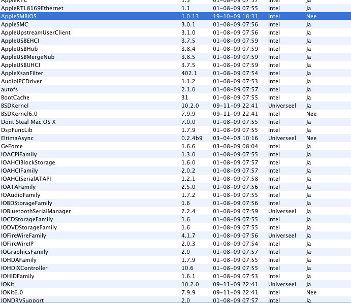

Luky Luke Posted November 29, 2009 Share Posted November 29, 2009 For i while i cant boot in 64 bit, i couldn't get it t work but now im noticing something that my AppleSMBios doesn't support 64 bit. I ussing osx 10.6.2, could maybe somebody help me fix this ? Thx Link to comment https://www.insanelymac.com/forum/topic/181903-guide%EF%A3%BFretail-snow-leopard-106-on-a-ga-ep45-ud3r%EF%A3%BF/page/65/#findComment-1345611 Share on other sites More sharing options...
Squirrelf Posted November 29, 2009 Share Posted November 29, 2009 For i while i cant boot in 64 bit, i couldn't get it t work but now im noticing something that my AppleSMBios doesn't support 64 bit. I ussing osx 10.6.2, could maybe somebody help me fix this ? Thx do you have smbios.kext (or similar) in your extra folder (or compressed in the mkext) delete that kext, you don't need smbios kext anymore... all you need is smbios.plist inside the extra folder Link to comment https://www.insanelymac.com/forum/topic/181903-guide%EF%A3%BFretail-snow-leopard-106-on-a-ga-ep45-ud3r%EF%A3%BF/page/65/#findComment-1345647 Share on other sites More sharing options...

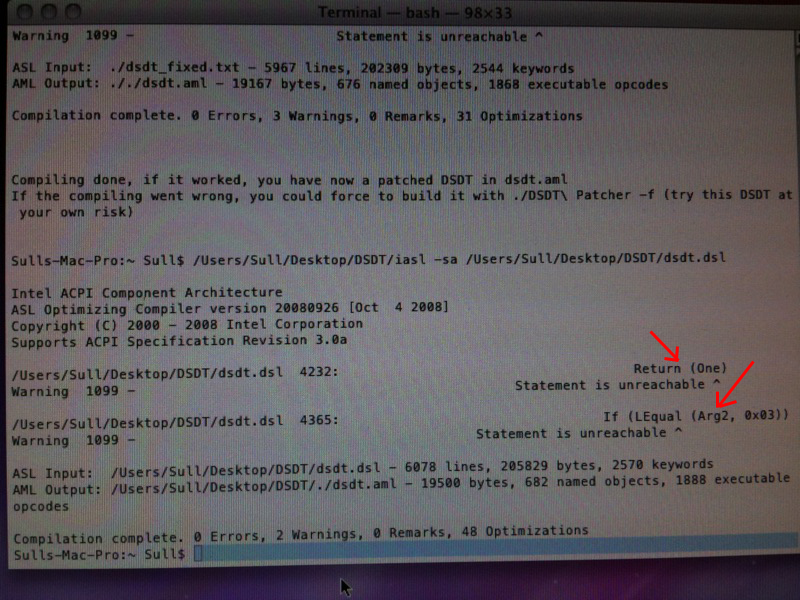

Sull Posted November 29, 2009 Share Posted November 29, 2009 Alright I have made a little more progress. I thought I should think out of the box.. ( other guides ) I was reading this thread HERE and I guess stellarola has patched a DSDT for the UD3P. I tested that out and instant gratification Sleep is working, I think shutdown and restart + Those video issues I spoke about are gone and I have translucent top bar. Sound is detected, but not working yet... I'll continue reading that thread and see what I can come up with. Whats weird is I have patched DSDT 3 different times and get the same each time. Link to comment https://www.insanelymac.com/forum/topic/181903-guide%EF%A3%BFretail-snow-leopard-106-on-a-ga-ep45-ud3r%EF%A3%BF/page/65/#findComment-1345842 Share on other sites More sharing options...
