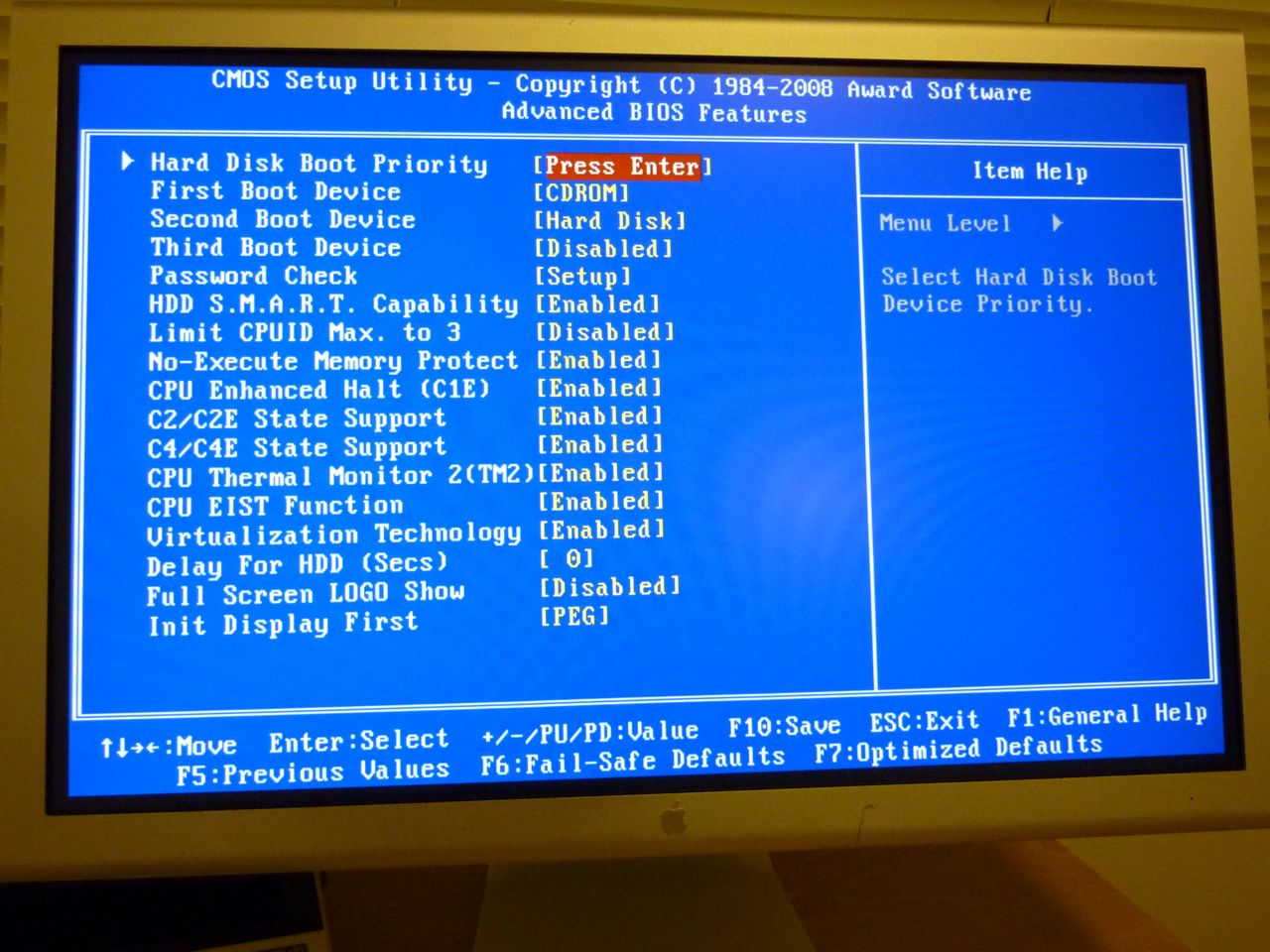

WinstonAce Posted September 17, 2009 Share Posted September 17, 2009 no I didn't get c-states, that why I used MP3.1 c-states...Strange... are you talking about the EP-45-UD3R with bios F11 atrr al c-states enabled in your bios? the speedstep thread (page 3) noted that if we add the ICH10R to the device list, temperature would be cooler and supposedly openhaltrestart would not be needed (haven't tested that yet...) I tried it, temps are still high, about 7-10 degrees more than with nullcpupowermanagment Link to comment https://www.insanelymac.com/forum/topic/181903-guide%EF%A3%BFretail-snow-leopard-106-on-a-ga-ep45-ud3r%EF%A3%BF/page/45/#findComment-1270175 Share on other sites More sharing options...
Squirrelf Posted September 17, 2009 Share Posted September 17, 2009 so you did get c-states from your dump? what is the file called? I'm on ep45-ud3r F11, optimised default (besides ahci), c states and speed step are enabled when you tried my legacy kext, did you get that extra option in energy saver about "start up automatically after power failure"? just to be sure that the kext actually loaded Link to comment https://www.insanelymac.com/forum/topic/181903-guide%EF%A3%BFretail-snow-leopard-106-on-a-ga-ep45-ud3r%EF%A3%BF/page/45/#findComment-1270359 Share on other sites More sharing options...
WinstonAce Posted September 17, 2009 Share Posted September 17, 2009 SSDT_r1-PmRef-Cpu0Cst-3001-INTL-20040311 SSDT_r1-PmRef-Cpu1Cst-3001-INTL-20040311 etc.. make sure you enabling all c states in bios before dumping including c4 states and yes, I did get the extra option in energy but the temp are unaffected the only thing that lower them down is disabling cpupowermanagment Link to comment https://www.insanelymac.com/forum/topic/181903-guide%EF%A3%BFretail-snow-leopard-106-on-a-ga-ep45-ud3r%EF%A3%BF/page/45/#findComment-1270461 Share on other sites More sharing options...

Squirrelf Posted September 17, 2009 Share Posted September 17, 2009 SSDT_r1-PmRef-Cpu0Cst-3001-INTL-20040311SSDT_r1-PmRef-Cpu1Cst-3001-INTL-20040311 etc.. make sure you enabling all c states in bios before dumping including c4 states and yes, I did get the extra option in energy but the temp are unaffected the only thing that lower them down is disabling cpupowermanagment how do you disable it by using the cpupowermanagment from the sl pack ? because I tried that, but that would mess up the speed step my geekbentch score would drop down from 7000 to 5500, because it was not returning to a full x9 multi when it was under load, only two out of four... but didn't have the c-state at the time, I'll try again later Link to comment https://www.insanelymac.com/forum/topic/181903-guide%EF%A3%BFretail-snow-leopard-106-on-a-ga-ep45-ud3r%EF%A3%BF/page/45/#findComment-1270683 Share on other sites More sharing options...

Squirrelf Posted September 18, 2009 Share Posted September 18, 2009 I decided to remove the MP3.1 cstates, temperature was great, but I wanted to watch a movie tonight, and couldn't, sound and image would lag contently, as soons as I removed cstates, problem was gone... but temperature is back up to 47 idle instead of 37 with or without appleLPC there's no difference now that cstate are not there, sleep now works again An update on my speedstep attempt: Compiled DSDT, no errors or problems. I've removed disabler kext but my temps have gone through the roof! Havent installed AppleLPC as not sure if its compatible with my system. I've attached some pics and my SSDT for review Is there a way of testing this to see if the speedstepping is working? i.e. is there a utility which stresses the processor? post your full dsdt.dsl, I'll yake a look at it to see if you got everything right Think the hard bit is done but not quite working yet. Any suggestions anyone? that part of ssdt seems just fine, but you will need to keep everything else that came with the ssdt well if you have "start up automatically after power failure", in energy preference appleLPC is already loaded... as I said I noticed the appleLPC lower my temps only if I also have c-states added to the dsdt do you know your geekbench score when speedstep was disabled in the bios with dsdt that had no ssdt added to it... if so compare it to what you have now in my case it was 7000 but if the system doesn't handle speedstep well I would lose 1500 points (5500), that's when I had speedstep enabled in bios along with NullCPUPowerManagement (with or without ssdt added to dsdt), because only two core would go up to x9, the other two would stay at x6 hence the loss in performance... download mprime to stress your cpu (download link at step 3, 32 and 64 bit in separate download) http://mersenne.org/freesoft/ to check speedstep: (32bit kernel only) cpu-i (if it doesn't KP your system at boot, so have a backup way to boot your system, I used my usb HD with Snow leo installation disk and chameleon, to boot back into my system and remove the kext that comes with cpu-i) works well to show you at what step your cores are running, I think my system would not KP when I had NullCPUPowerManagement along with it... when idle status window will show the multi drop when speedstep is active so for now when I don't have NullCPUPowerManagement I use MSRtools for SL it will only show you two cores, but if your geekbench is back to normal , then you know your four cores will have all the multi back to get maximum speed under load.... found it in another thread: MSR_Tools.app.zip Link to comment https://www.insanelymac.com/forum/topic/181903-guide%EF%A3%BFretail-snow-leopard-106-on-a-ga-ep45-ud3r%EF%A3%BF/page/45/#findComment-1271063 Share on other sites More sharing options...

keeza Posted September 18, 2009 Share Posted September 18, 2009 I decided to remove the MP3.1 cstates, temperature was great, but I wanted to watch a movie tonight, and couldn't, sound and image would lag contently, as soons as I removed cstates, problem was gone...but temperature is back up to 47 idle instead of 37 with or without appleLPC there's no difference now that cstare are not there, sleep now works again that part of ssdt seems just fine, but you will need to keep everything else that came with the ssdt well if you have "start up automatically after power failure", in energy preference appleLPC is already loaded... as I said I noticed the appleLPC lower my temps only if I also have c-states added to the dsdt do you know your geekbench score when speedstep was disabled in the bios with dsdt that had no ssdt added to it... if so compare it to what you have now in my case it was 7000 but if the system doesn't handle speedstep well I would lose 1500 points (5500), that's when I had speedstep enabled in bios along with NullCPUPowerManagement (with or without ssdt added to dsdt), because only two core would go up to x9, the other two would stay at x6 hence the loss in performance... download mprime to stress your cpu (download link at step 3, 32 and 64 bit in separate download) http://mersenne.org/freesoft/ to check speedstep: (32bit kernel only) cpu-i (if it doesn't KP your system at boot, so have a backup way to boot your system, I used my usb HD with Snow leo installation disk and chameleon, to boot back into my system and remove the kext that comes with cpu-i) works well to show you at what step your cores are running, I think my system would not KP when I had NullCPUPowerManagement along with it... when idle status window will show the multi drop when speedstep is active so for now when I don't have NullCPUPowerManagement I use MSRtools for SL it will only show you two cores, but if your geekbench is back to normal , then you know your four cores will have all the multi back to get maximum speed under load.... found it in another thread: MSR_Tools.app.zip OK so I can conclude that my Speedstep part of my DSDT should run....but doesn't yet. It has compiled without errors which is a good start. So gonna take a step backwards and make sure my BIOS settings are correct - could you confirm that they are correct? I don't have "start up automatically after power failure", in energy preferences so I assume that my AppleLPC Kext isn't loading so need to find out why. i will run a Geekbench test when I can confirm my BIOS settings are correct for speedstepping. I have two backup partitions just in case...... Link to comment https://www.insanelymac.com/forum/topic/181903-guide%EF%A3%BFretail-snow-leopard-106-on-a-ga-ep45-ud3r%EF%A3%BF/page/45/#findComment-1271453 Share on other sites More sharing options...
kdawg Posted September 18, 2009 Share Posted September 18, 2009 OK so I can conclude that my Speedstep part of my DSDT should run....but doesn't yet. It has compiled without errors which is a good start. So gonna take a step backwards and make sure my BIOS settings are correct - could you confirm that they are correct? I don't have "start up automatically after power failure", in energy preferences so I assume that my AppleLPC Kext isn't loading so need to find out why. i will run a Geekbench test when I can confirm my BIOS settings are correct for speedstepping. I have two backup partitions just in case...... Not sure if you've seen this article on SpeedStepping: http://www.ztex.de/misc/c2ctl.e.html#c1 You can also track some SpeedStepping effort here, but it's not Snow Leopard. The principles are the same. http://www.insanelymac.com/forum/index.php...t&p=1171825 SpeedStepping shouldn't be a problem. However I think you'll run into a wall if you try to get C-States going via DSDT alone. I ended up using VoodooPower.kext which I don't has been ported to 64-bit yet. As far as your "start up automatically after power failure" problem take a look at my attached DSDT I have no problems. You shouldn't need the AppleLPC.kext for that. kdawg_dsdt.dsl.zip Link to comment https://www.insanelymac.com/forum/topic/181903-guide%EF%A3%BFretail-snow-leopard-106-on-a-ga-ep45-ud3r%EF%A3%BF/page/45/#findComment-1271585 Share on other sites More sharing options...

Squirrelf Posted September 18, 2009 Share Posted September 18, 2009 ....As far as your "start up automatically after power failure" problem take a look at my attached DSDT I have no problems. You shouldn't need the AppleLPC.kext for that. kdawg_dsdt.dsl.zip I don't care for the option "start up automatically after power failure" but is just an easy/fast way to know if that AppleLPC is loaded. the device id for the ud3r is not in the kext, so by default on the ud3r it is not loaded... having pstates+cstates my idle temperature I very high, having appleLPC loaded reduced my temps by about 10C, and speedstep would still work, but I sound and image would lag/shuttler (used MP3.1 c-steps) so I removed cstates, which in that case appleLPC ia not needed, but temperature is high again I tried VoodooPowerMini, worked great, excepted that idle temperature are also high so only way is to use NullCPUPowerManagement to have low temperature, then speedstep is either messed up (geekbentch score lower by 1500 point, when I don't have any p-steps and c-steps, but speedstep is enabled in bios) or doesn't work (stays at multi 9x all the time, that's when I have p-steps in dsdt) So I don't know what to do anymore and don't see the point of speeds step, with c-steps my system is slow for movies, without them (only p-steps) temperature is higher at idle compared to no speedstep at all... the whole point of this is lower temps at idle (i.e. lower power consumption), isnt it? SSDT_r1-PmRef-Cpu0Cst-3001-INTL-20040311SSDT_r1-PmRef-Cpu1Cst-3001-INTL-20040311 etc.. make sure you enabling all c states in bios before dumping including c4 states and yes, I did get the extra option in energy but the temp are unaffected the only thing that lower them down is disabling cpupowermanagment I have only one c-states option in the bios called C1E and it's enable, is that what you were talking about but I didn't those cst files wonder if the stuttering during the movie was due to the fact I wasn't using my own c-states dump (which I don't know how to get) did you use ubuntu ti get those files? just by using the command posted earlier? Link to comment https://www.insanelymac.com/forum/topic/181903-guide%EF%A3%BFretail-snow-leopard-106-on-a-ga-ep45-ud3r%EF%A3%BF/page/45/#findComment-1271817 Share on other sites More sharing options...
WinstonAce Posted September 18, 2009 Share Posted September 18, 2009 You should have c2 and c4 options in bios as well I've got the files through linux and through everest in windows (They are Identical) Link to comment https://www.insanelymac.com/forum/topic/181903-guide%EF%A3%BFretail-snow-leopard-106-on-a-ga-ep45-ud3r%EF%A3%BF/page/45/#findComment-1271912 Share on other sites More sharing options...
Squirrelf Posted September 18, 2009 Share Posted September 18, 2009 You should have c2 and c4 options in bios as well I've got the files through linux and through everest in windows (They are Identical) I looked at the bios screen posted above, I have the same screen but without c2 and c4, I only have C1E I think it is cpu dependent, my Q6600 is to old (time to change....i wish) I'm now in ubuntu live cd (I don't have windows, only in vmware) I reinstalled F11 (WOL works from full shutdown, I'll investigate what SL is doing to disable that feature, I think the lan fix is responsible) just did a new dump and I still don't have cst files by the way is it possible to get dsdt from linux, I want to create the cleanest dsdt possible ? edit for however is interested found a how to extract it: http://ubuntuforums.org/showthread.php?t=1...;highlight=dsdt indeed the dsdt is slightly different than the one extracted from osx the fix I did to get wake from keyboard , is not needed here, the dsdt from linux has everything it was always supposed to be, so no change for that, I wonder what other stuff is different (I believe for the better) Link to comment https://www.insanelymac.com/forum/topic/181903-guide%EF%A3%BFretail-snow-leopard-106-on-a-ga-ep45-ud3r%EF%A3%BF/page/45/#findComment-1271916 Share on other sites More sharing options...
