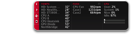

d-track Posted December 15, 2011 Share Posted December 15, 2011 ok it does work with p-states and c-states settings in chameleon just like vanilla but still no Q-fan control. I can live without that anyway, never crapped the cpu because of high temps. It might something to do with the windows xp dual boot - this is the only thing changed since then (hdd failure so no windows anymore) Link to comment https://www.insanelymac.com/forum/topic/181631-dsdt-vanilla-speedstep-generic-scope-_pr/page/77/#findComment-1778784 Share on other sites More sharing options...
Gringo Vermelho Posted December 15, 2011 Share Posted December 15, 2011 ASUS Q-Fan works via ACPI, you can clearly see all the code for it in your DSDT. On Windows, a driver is installed for an "ATK110" device that handles this. But OS X doesn't know what to do with it. There's a topic about how to get fan control to work via ACPI with Fakesmc and the ACPImonitor plugin over here: http://www.projectos...?showtopic=1593 This app might be useful in that context: http://www.eidac.de/?cat=40 (Note, smcFanControl will not work on its own on a Hackintosh) Link to comment https://www.insanelymac.com/forum/topic/181631-dsdt-vanilla-speedstep-generic-scope-_pr/page/77/#findComment-1778832 Share on other sites More sharing options...
