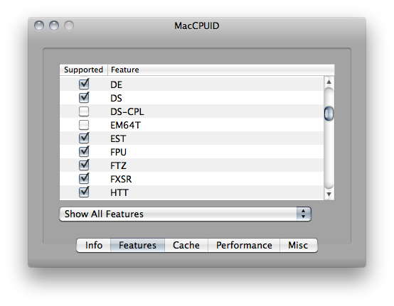

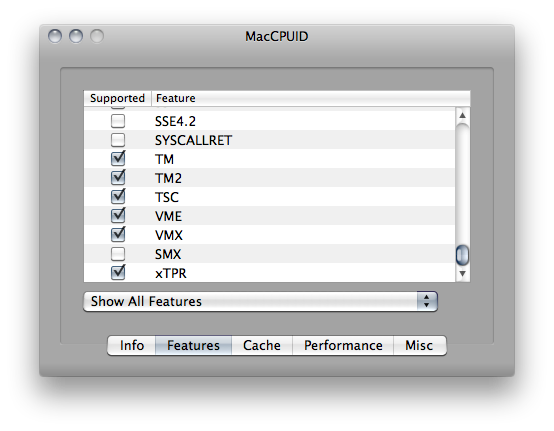

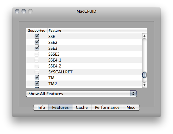

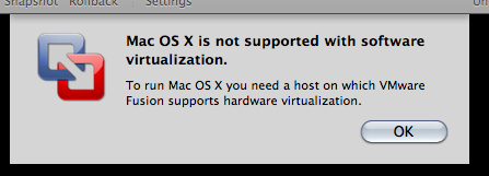

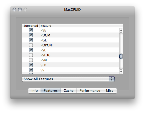

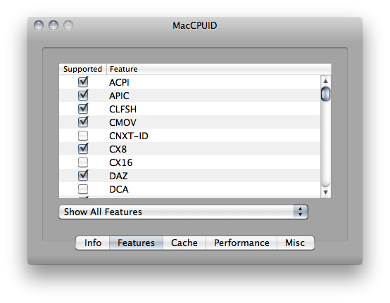

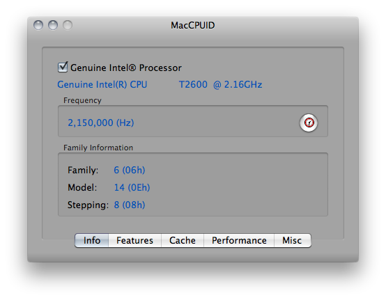

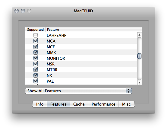

Alan L. Posted August 26, 2009 Share Posted August 26, 2009 I have a MacbookPro with the CoreDuo@2.16 (32 bit machine). I am running snow leopard but I need a VM with 10.5 due to some software which is incompatible with 10.6. I tried using both the 10.5 Server template and a FreeBSD-modded template both give me the error as seen in the screenshot from Fusion. Link to comment https://www.insanelymac.com/forum/topic/172474-vmware-mac-os-x-guest-package-for-esx-workstation-player-server-and-fusion/page/9/#findComment-1236643 Share on other sites More sharing options...
Atmosfear Posted August 26, 2009 Share Posted August 26, 2009 @Alan I think the CoreDuo lacks the required hardware virtualization features and it definitly lacks 64-Bit support. Btw. anyone had luck with installing tiger? I'm receiving a kernel stack error, cpu disabled with VMware Fusion 2.0.5 on a 2009 Mac Pro 8-core 16GB running 10.5.8. Both 10.5 and 10.6 installed fine. I tried both a retail 10.4 DVD that came with my MacBook Pro CoreDuo and a 10.4.8 JaS DVD for Hackintosh and GuestOS setting of darwin. (I need 10.4 for backward compatibility testing.) Link to comment https://www.insanelymac.com/forum/topic/172474-vmware-mac-os-x-guest-package-for-esx-workstation-player-server-and-fusion/page/9/#findComment-1236673 Share on other sites More sharing options...
Alan L. Posted August 26, 2009 Share Posted August 26, 2009 @Alan I think the CoreDuo lacks the required hardware virtualization features and it definitly lacks 64-Bit support. I has the VX-T components but not 64bit. I think it is some limit that Fusion as coded into it, that it is only able to run MacOS on 64bit host, even if the guest OSX is 32 bit. I have definately run WinXP with fusion on this host though. Link to comment https://www.insanelymac.com/forum/topic/172474-vmware-mac-os-x-guest-package-for-esx-workstation-player-server-and-fusion/page/9/#findComment-1236683 Share on other sites More sharing options...
Atmosfear Posted August 26, 2009 Share Posted August 26, 2009 I has the VX-T components but not 64bit. I think it is some limit that Fusion as coded into it, that it is only able to run MacOS on 64bit host, even if the guest OSX is 32 bit. I have definately run WinXP with fusion on this host though. Yea, but VMware uses software virtualization for XP (32-Bit). Probably the Core Duo supports only an older revision of the virtualization extension required or VMware just ignores it ... Link to comment https://www.insanelymac.com/forum/topic/172474-vmware-mac-os-x-guest-package-for-esx-workstation-player-server-and-fusion/page/9/#findComment-1236705 Share on other sites More sharing options...
Donk Posted August 26, 2009 Author Share Posted August 26, 2009 I have a MacbookPro with the CoreDuo@2.16 (32 bit machine). I am running snow leopard but I need a VM with 10.5 due to some software which is incompatible with 10.6. I tried using both the 10.5 Server template and a FreeBSD-modded template both give me the error as seen in the screenshot from Fusion. Some questions for you: 1. Give me the exact CPU processor number please so I can check what it is doing. 2. I assume you are using my files to run the desktop version of Leopard 3. Version of Fusion being used 4. Post the VMX file The message means that for some reason the VT-x extensions are not being used on your machine. I has the VX-T components but not 64bit. I think it is some limit that Fusion as coded into it, that it is only able to run MacOS on 64bit host, even if the guest OSX is 32 bit. I have definately run WinXP with fusion on this host though. No all VMware products use VT-x extensions for both 32-bit and 64-bit Leopard guests. Othe OS can use binary translation which do not use VT-x. Link to comment https://www.insanelymac.com/forum/topic/172474-vmware-mac-os-x-guest-package-for-esx-workstation-player-server-and-fusion/page/9/#findComment-1236755 Share on other sites More sharing options...

Alan L. Posted August 26, 2009 Share Posted August 26, 2009 Some questions for you: 1. Give me the exact CPU processor number please so I can check what it is doing. T2600 @ 2.16 2. I assume you are using my files to run the desktop version of Leopard yes. 3. Version of Fusion being used 2.05 4. Post the VMX file attached. Virtual_Machines.zip MacBook_Pro_System_Profile.zip Link to comment https://www.insanelymac.com/forum/topic/172474-vmware-mac-os-x-guest-package-for-esx-workstation-player-server-and-fusion/page/9/#findComment-1237053 Share on other sites More sharing options...
