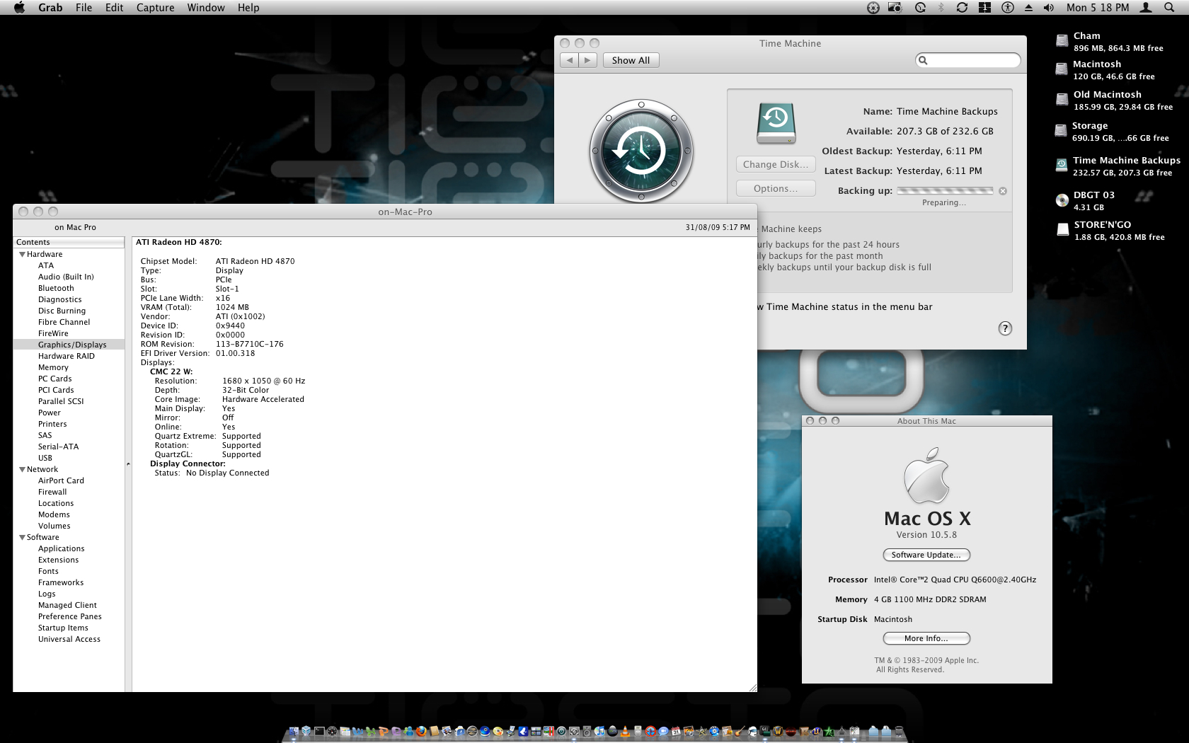

N00bishMacer Posted August 31, 2009 Share Posted August 31, 2009 I too would like to thank you for your assistance with my Asus EAH4870 graphics card. I recently purchased the card to replace my 8600 GT and l have to say the conversion from 1 type of card to another was kind of painful but in the end l had great success. Screenshot is attached. Link to comment https://www.insanelymac.com/forum/topic/170414-4870-1gb-working-sleepciqeresolution-change/page/2/#findComment-1243599 Share on other sites More sharing options...
surrealillusion Posted September 4, 2009 Share Posted September 4, 2009 I too would like to thank you for your assistance with my Asus EAH4870 graphics card. I recently purchased the card to replace my 8600 GT and l have to say the conversion from 1 type of card to another was kind of painful but in the end l had great success. Screenshot is attached. Sounds like you guys had success with getting your 4870 working. I gave up on mine a month ago and I'm currently running on my 9600GT. I might try and re-attempt to get it working though with this newfound success. Link to comment https://www.insanelymac.com/forum/topic/170414-4870-1gb-working-sleepciqeresolution-change/page/2/#findComment-1250466 Share on other sites More sharing options...
