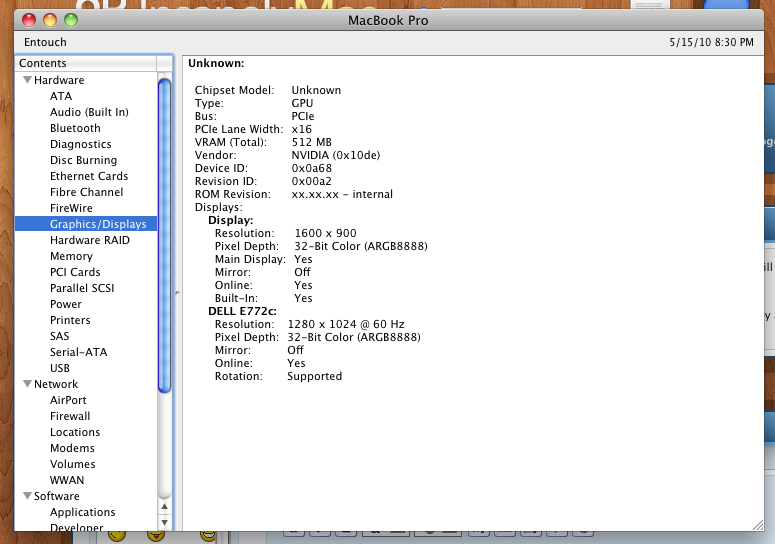

ZackMacAttack Posted May 16, 2010 Share Posted May 16, 2010 Anyone got this working with Snow? I have 10.6.3 running on my system and have working Graphics with the nVidia GeForce G 105m GPU. Working HDMI and VGA, o and 512 MB of vRam that OS X recognized. I am not using any special drivers or kexts just have my com.apple.Boot.plist looking like this: (Important things are bold) <dict> <key>Graphics Mode</key> <string>1600x900x32</string> - (This is just for the boot-loader and will not effect your res in 10.6) [b][i]<key>GraphicsEnabler</key> <string>y</string>[/b][/i] ............... </dict> </plist> Here is a Screen shot of System Profiler. Link to comment Share on other sites More sharing options...
