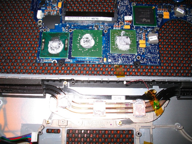

After a few weeks of serious suffering with the excessive heat from my new macbook, I was glad to stumble upon some forum topics referring the excessive paste problem.

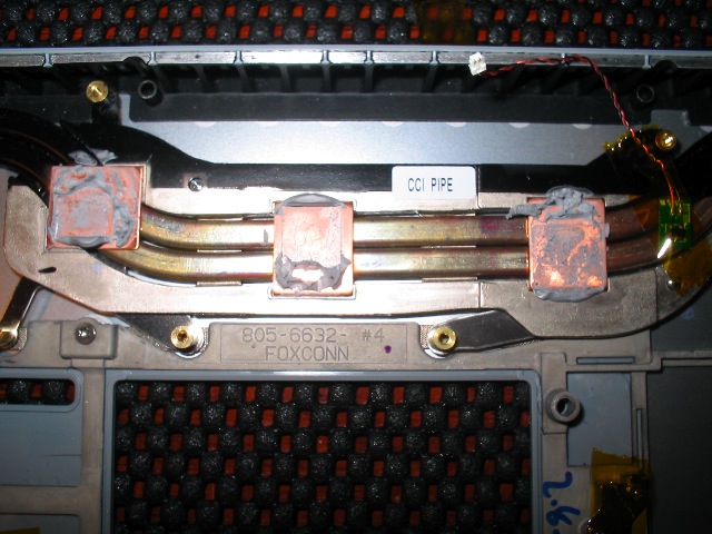

In all the situations where thermal paste is used it's really critical to use the thinest possible layer to ensure the best possible thermal contact between two surfaces.

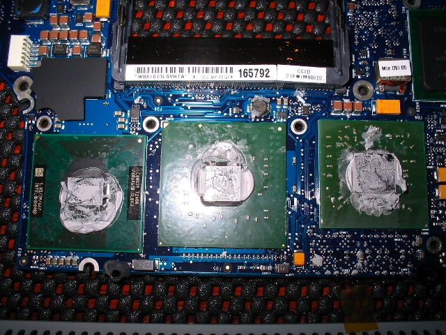

Having some experience in this field with PC's I decided to roll up my sleeves and open up my mac... What I found was truly amazing: not an excess of thermal paste but an industrial load of it, covering not only the die of the chips, but the area around them, leaking even onto the logic board.
After careful and proper removing of the original paste and replacing it with Arctic Silver 5 temperatures have significantly lowered, although I have no means to objectively measure them.

I really took my time, all in all maybe an hour to disassemble, clean and replace the thermal paste and reassemble the whole thing (and document the process with some photos). It's a long process and I recommend following the iFixit instructions (if possible having them open in another computer or printing them out). The Apple service manual will also do fine.
As for temperatures, and finding Cryptonome's kernel extension only after the "mod" I was suprised to see that they remain about 65ºC idle to 85ºC full load, and it still takes a while for my fans to kick in, but that could mean some crazed out hardware, even though the surface of the computer is significantly cooler to the touch.

OK - this time yesterday my cpu was idling at 70 degC. A little warm. This was an average over about an hour (65 to 75).
So last night I got some Arctic Silver 5 and today investigated the apple-inflicted damage on the heatsinks, and whilst not as bad as some photos I've seen, it was still too thick in my experience. What I guess happened was that they specified a smaller ball of paste placed on the heatsink, but are still squishing it into place rather than spreading, and to be 'safe' are still using too much.
Anyhoo, doing the same stuff as yesterday I'm sitting between 45 and 55 degC. This is even with photobooth running. It I turn that off I go down to about 40-45 degC. The area above the F-keys is a lot cooler, and the underside is also much cooler. I've also heard the fans on my MBP come on, which I hadn't before.

Good grief that's outragious. They must have thought you were supposed to use a whole tube on each cpu. That cleaner or solvent packaged by the same people that make artic silver is the perfect stuff for cleaning up that mess, after you carefully remove as much as possible.
From the MacBookPro service manual:
"Put a 0.2 - 0.3cc daub of thermal grease, in the center, on all three chip mating surfaces, as shown below.
NOTE: One syringe of the thermal grease (922-7144) contains about 0.2 - 0.3 cc. So use one syringe per pad."
