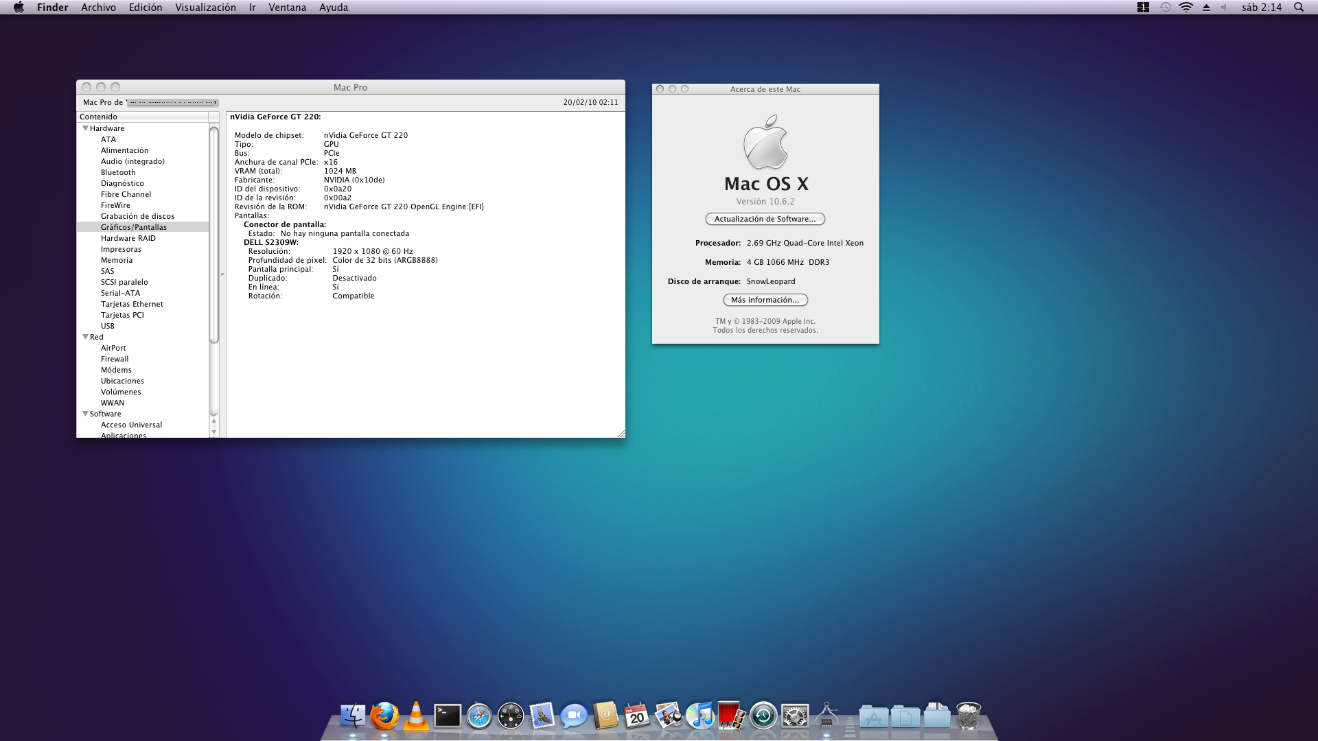

TheZoog Posted February 19, 2010 Share Posted February 19, 2010 Hi tzel2, I have SL 10.6.3 working on my Dell Studio XPS435T, installed with myHack Installer 1.0 RC5.1. Video: Nvidia GT 220 1G with EFI String (Full QE/CI) P.S. I can post my efi string for those who have GT 220 but for me it only works in 10.6.3, not on any prior version. please post your efi for the GT 220, I've been trying to get sleep to work and I think the 220 might get it done. Thx. Link to comment https://www.insanelymac.com/forum/topic/151117-guide-installing-leopard-on-dell-studio-xps-i7/page/10/#findComment-1413234 Share on other sites More sharing options...
yeraym Posted February 20, 2010 Share Posted February 20, 2010 please post your efi for the GT 220, I've been trying to get sleep to work and I think the 220 might get it done. Thx. My card is a Zotac GeForce GT 220 1G DDR3 This is my com.apple.Boot.plist com.apple.Boot.plist.zip <?xml version="1.0" encoding="UTF-8"?> <!DOCTYPE plist PUBLIC "-//Apple//DTD PLIST 1.0//EN" "http://www.apple.com/DTDs/PropertyList-1.0.dtd"> <plist version="1.0"> <dict> <key>Kernel</key> <string>mach_kernel</string> <key>Timeout</key> <string>5</string> <key>EthernetBuiltIn</key> <string>y</string> <key>GraphicsEnabler</key> <string>y</string> <key>device-properties</key> <string>6a02000001000000010000005e0200000d00000002010c00d041030a000000000101060000070 101060000007fff04001e00000072006f006d002d007200650076006900730069006f006e0000002d 0000006e5669646961204765466f72636520475420323230204f70656e474c20456e67696e65205b4 546495d22000000400030002c006400650076006900630065005f00740079007000650000000b0000 00646973706c6179100000004e0056004300410050000000180000000400000000000100060000000 0000000000000000e0000006e0061006d00650000000b000000646973706c61791400000040003000 2c006e0061006d0065000000120000004e5644412c446973706c61792d41100000006d006f0064006 5006c000000190000006e5669646961204765466f726365204754203232300e0000004e0056005000 4d0000002000000001000000000000000000000000000000000000000000000000000000140000004 00031002c006e0061006d0065000000120000004e5644412c446973706c61792d4220000000400031 002c0063006f006d00700061007400690062006c00650000000e0000004e5644412c4e564d6163220 000005600520041004d002c0074006f00740061006c00730069007a00650000000800000000000040 20000000400030002c0063006f006d00700061007400690062006c00650000000e0000004e5644412 c4e564d616322000000400031002c006400650076006900630065005f00740079007000650000000b 000000646973706c61791c0000006400650076006900630065005f00740079007000650000000f000 0004e5644412c506172656e74</string> </dict> </plist> Hope it helps Link to comment https://www.insanelymac.com/forum/topic/151117-guide-installing-leopard-on-dell-studio-xps-i7/page/10/#findComment-1413767 Share on other sites More sharing options...

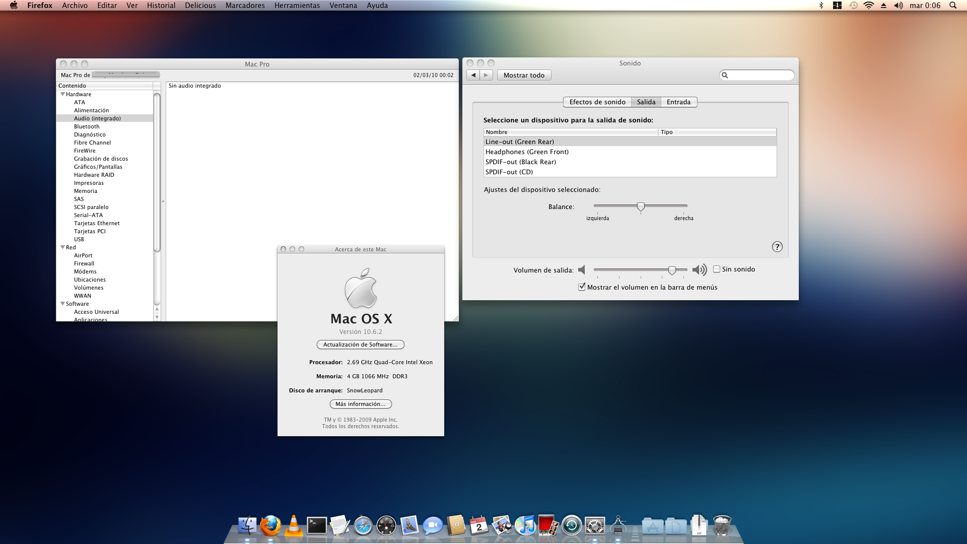

yeraym Posted March 1, 2010 Share Posted March 1, 2010 Hi,If you have an XPS-435T with ATi 4850 try this attached files. Tzel2.zip Thank You so mutch Those files did it for me, although I have an Nvidia GT 220 injected by an EFI string, I'm using your dsdt and VoodooHDA-255.kext and I get a clear and lovely sound. Thanks again P.S. Just to clarify, System Profiler can't see any integrated audio device, but I can see the connections in System Preferences Link to comment https://www.insanelymac.com/forum/topic/151117-guide-installing-leopard-on-dell-studio-xps-i7/page/10/#findComment-1421071 Share on other sites More sharing options...
tzel2 Posted March 2, 2010 Share Posted March 2, 2010 Thank You so mutch Those files did it for me, although I have an Nvidia GT 220 injected by an EFI string, I'm using your dsdt and VoodooHDA-255.kext and I get a clear and lovely sound. Thanks again P.S. Just to clarify, System Profiler can't see any integrated audio device, but I can see the connections in System Preferences Good, With voodoohda you will not see any integrated audio device. Link to comment https://www.insanelymac.com/forum/topic/151117-guide-installing-leopard-on-dell-studio-xps-i7/page/10/#findComment-1421171 Share on other sites More sharing options...
