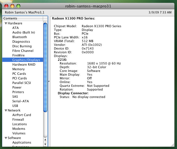

My only problems are audio & my video card. Audio is only working in 2 channel configuration (mic & line-in not yet tested). My ATI Radeon X1550pro works except QE :thumbsup_anim: (detected as Radeon X1300pro using ATIRadeonX1000.kext in iDeneb DVD)..Any help & suggestions is really appreciated.
My Video Card Specs:
