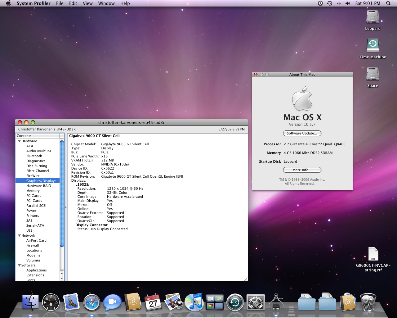

xopher Posted June 27, 2009 Share Posted June 27, 2009 I booted using another boot-132 CD and got past the spinning beach ball during retail Leopard install, successfully installed retail Leopard 10.5.6, and now updated to 10.5.7. Still the same problem persists. Can I conclude that the problem somehow lies in my graphic card setup? Because when I boot without the EFI string in com.boot.Apple.plist, stacks work without a hitch. If I'd try an injector, which one do you recommend? I'm still on the NVIDIA 9600GT 512MB. EDIT: I forgot to enter my PSU into my H/W-info, it's a Nexus 430W Ultra Silent. Thanks OK, I think figured it out. Removed the extra power cord from my GF 9600GT, so it would run 'half speed', it fixed the problem, and now everything's working smoothly. The problem must be my underpowered PSU, guess the only thing a 430W is good for nowadays is a HTPC with an integrated 3D card. So what I did was order a new 850W Nexus RX-8500 <15.5dB modular PSU The very best to all of you, Christoffer Link to comment https://www.insanelymac.com/forum/topic/141769-new-install-gigabyte-ga-ep45-ud3r/page/30/#findComment-1187179 Share on other sites More sharing options...

xopher Posted July 2, 2009 Share Posted July 2, 2009 OK, I think figured it out. Removed the extra power cord from my GF 9600GT, so it would run 'half speed', it fixed the problem, and now everything's working smoothly. The problem must be my underpowered PSU, guess the only thing a 430W is good for nowadays is a HTPC with an integrated 3D card. So what I did was order a new 850W Nexus RX-8500 <15.5dB modular PSU The very best to all of you, Christoffer Right, so I got my new 850W PSU today, and guess what - didn't help at all. Sigh. Now, please have some ideas that might fix this? Could it be driver related? or a BIOS setting? TIA. Link to comment https://www.insanelymac.com/forum/topic/141769-new-install-gigabyte-ga-ep45-ud3r/page/30/#findComment-1190862 Share on other sites More sharing options...
gmacman Posted July 3, 2009 Share Posted July 3, 2009 Right, so I got my new 850W PSU today, and guess what - didn't help at all. Sigh. Now, please have some ideas that might fix this? Could it be driver related? or a BIOS setting? TIA. Unless you have masses of power hungry devices the 430 should actually be fine. Neither of my Hackintoshes uses the power directly to the graphics card (and in one I have a 9400GT which is similar to your 9600). And you mentioned that once you removed the extra power everything worked, so quite frankly I believe that is your solution. Not quite sure what you mean by running "have speed". My 9400 is running with full power and providing CI/QE/GL: nVidia GeForce 9400 GT: Chipset Model: nVidia GeForce 9400 GT Type: Display Bus: PCIe PCIe Lane Width: x16 VRAM (Total): 512 MB Vendor: NVIDIA (0x10de) Device ID: 0x0641 Revision ID: 0x00a1 ROM Revision: nVidia GeForce 9400 GT OpenGL Engine [EFI] Displays: SyncMaster: Resolution: 1680 x 1050 @ 60 Hz Depth: 32-Bit Color Core Image: Hardware Accelerated Main Display: Yes Mirror: Off Online: Yes Quartz Extreme: Supported Rotation: Supported QuartzGL: Supported Display Connector: Status: No Display Connected Link to comment https://www.insanelymac.com/forum/topic/141769-new-install-gigabyte-ga-ep45-ud3r/page/30/#findComment-1191763 Share on other sites More sharing options...

xopher Posted July 6, 2009 Share Posted July 6, 2009 Unless you have masses of power hungry devices the 430 should actually be fine. Neither of my Hackintoshes uses the power directly to the graphics card (and in one I have a 9400GT which is similar to your 9600). And you mentioned that once you removed the extra power everything worked, so quite frankly I believe that is your solution. Not quite sure what you mean by running "have speed". My 9400 is running with full power and providing CI/QE/GL: nVidia GeForce 9400 GT: Chipset Model: nVidia GeForce 9400 GT Type: Display Bus: PCIe PCIe Lane Width: x16 VRAM (Total): 512 MB Vendor: NVIDIA (0x10de) Device ID: 0x0641 Revision ID: 0x00a1 ROM Revision: nVidia GeForce 9400 GT OpenGL Engine [EFI] Displays: SyncMaster: Resolution: 1680 x 1050 @ 60 Hz Depth: 32-Bit Color Core Image: Hardware Accelerated Main Display: Yes Mirror: Off Online: Yes Quartz Extreme: Supported Rotation: Supported QuartzGL: Supported Display Connector: Status: No Display Connected Well, unplugging the pci-e power cord lowers the clocks on the 9600GT, effectively decreasing the performance of the hack. Xbenches OpenGL test showed an almost 65% decrease. Another thing that occurs when running 3D-graphics, is a weird high pitch noise. And, it's not the fan, because there is none. This is reproduced by running eg the opelgl extensions viewer test. Funny is, that depending on the veesion of opengl the test runs, the sound changes. Any input on this matter is appreciated. Sent from my iPhone, so I apologize if the text isn't perfect :-) Link to comment https://www.insanelymac.com/forum/topic/141769-new-install-gigabyte-ga-ep45-ud3r/page/30/#findComment-1194059 Share on other sites More sharing options...

gmacman Posted July 8, 2009 Share Posted July 8, 2009 Well, unplugging the pci-e power cord lowers the clocks on the 9600GT, effectively decreasing the performance of the hack. I only use my computer for regular stuff (very few games) and things like Final Cut Pro, Aperture, Handbrake, etc. So I'm afraid I don't quite understand this nor it's effects. Perhaps you can check on the hardware specific forum (the one for graphics cards I mean). Link to comment https://www.insanelymac.com/forum/topic/141769-new-install-gigabyte-ga-ep45-ud3r/page/30/#findComment-1195742 Share on other sites More sharing options...
