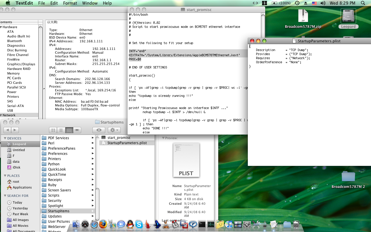

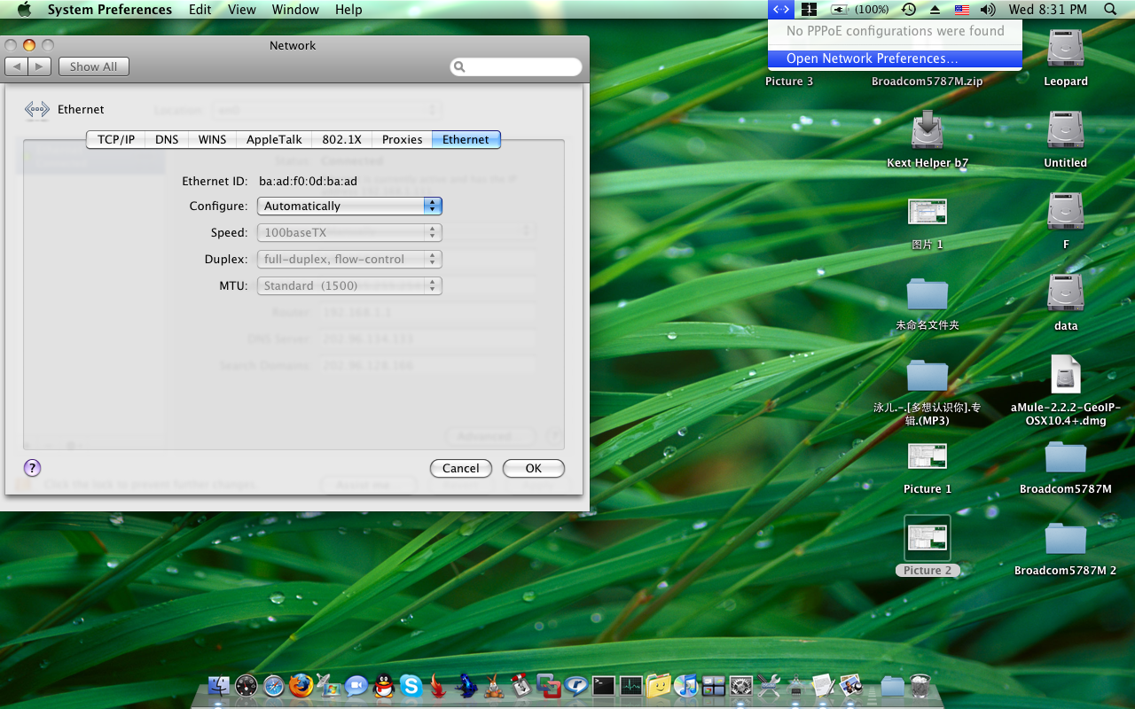

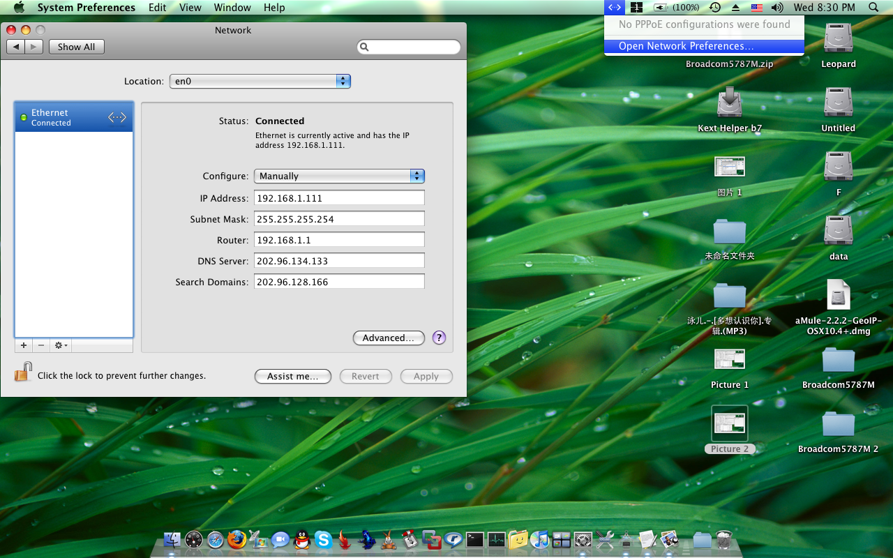

qzl722 Posted October 15, 2008 Share Posted October 15, 2008 I install the 5787M.kext sucessfully, and get the mac address .and get a ip (192.168.1.111 from my router),but i can not get the interenet ,why?here are the pictures.,help.me...... Link to comment https://www.insanelymac.com/forum/topic/127903-broadcom-bcm5787mbcm5784m-a-solution/page/3/#findComment-931201 Share on other sites More sharing options...

qzl722 Posted October 16, 2008 Share Posted October 16, 2008 hmm, i can check but i can't test, it gave kernel panic before because of a wrong value in buffer size, maybe there is another routine still unpatched around.Man, you don't get an address from your router, you set it manually, as your pics show. are you sure that address is correct?, your router hasn't a DHCP server? what happen if you let the lan card get the address automatically? try to ping your router from a terminal window, try also to type ifconfig and look if the promiscuous mode is enabled en0: flags=8863<UP,BROADCAST,SMART,PROMISC,RUNNING,SIMPLEX,MULTICAST> mtu 1500 if not enabled the lan will not work!!! if the set_promisc script fail, you can try to force promiscuous mode using the terminal command "sudo tcpdump" then open another terminal and try again the ifconfig. thx,very much ,i do as you say ,i work!!!!!!!!!!!!!!!thx. but one problem,when i you skype to voice chat ,the skype crash ... Link to comment https://www.insanelymac.com/forum/topic/127903-broadcom-bcm5787mbcm5784m-a-solution/page/3/#findComment-933010 Share on other sites More sharing options...
