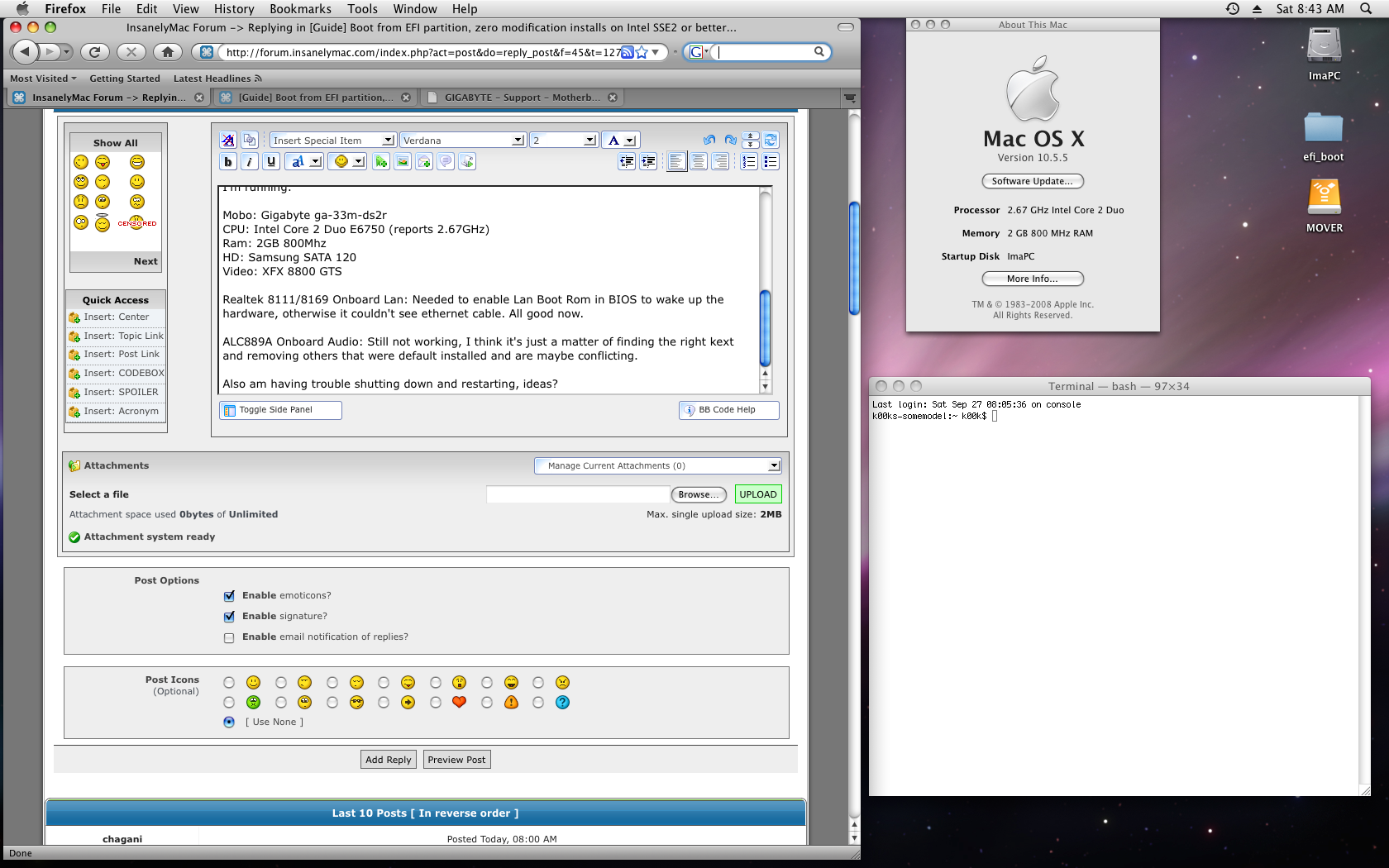

k00k Posted September 27, 2008 Share Posted September 27, 2008 Here's my first message on these forums, and if it's a sign of things to come, this is a beautiful place I had never attempted to install any OSx86 project, I always had a MacBookPro, so I didn't really need to. I left my job and had to give the MacBookPro back to them, so I've been waiting for the new ones to come out and got tired of waiting. In any case, decided to try Munky's guide on the first page and whaddya know, I installed, updated, and am typing this message from 10.5.5! Granted, I have some decent *nix and Darwin experience, but didn't really need it. But I never knew anything about kexts, etc. Just read through these forums last night. So, just wanted to say thanks to all that made it possible. Great efforts all around! Just need to figure out which kexts are overkill and I can remove from the EFI partition and then get my sound working. I used the generic.iso from here: http://forum.insanelymac.com/index.php?showtopic=113288 I'm running: Mobo: Gigabyte ga-33m-ds2r CPU: Intel Core 2 Duo E6750 (reports 2.67GHz) Ram: 2GB 800Mhz HD: Samsung SATA 120GB Video: XFX 8800 GTS (1680x1050 w/o even trying on first boot) Realtek 8111/8169 Onboard Lan: Needed to enable Lan Boot Rom in BIOS to wake up the hardware, otherwise it couldn't see ethernet cable. All good now. ALC889A Onboard Audio: Still not working, I think it's just a matter of finding the right kext and removing others that were default installed and are maybe conflicting. Got the audio working. In BIOS, Azalia codec is set to Auto. And I used the 2 kexts in this zip and installed them into /System/Library/Extensions as opposed to the EFI extensions folder as I couldn't get them to work in there. ALC889A kexts: http://rapidshare.com/files/51585161/alc889a.zip.html Still having trouble shutting down and restarting, ideas? Got shutdown working In BIOS, under power management, set HPET to 64bit and set shutdown delay to Instant. -k00k Link to comment https://www.insanelymac.com/forum/topic/127330-guide-boot-from-efi-partition-zero-modification-installs-on-intel-sse2-or-better/page/6/#findComment-908158 Share on other sites More sharing options...
munky Posted September 27, 2008 Author Share Posted September 27, 2008 k00k: congrats and welcome paranoid marvin: whats the last thing printed by -v ? did you have any previous version of chameleon installed? you need to remove any previous installed chameleon on any other partition. only easy way i know to do that is to repartition your disk. Link to comment https://www.insanelymac.com/forum/topic/127330-guide-boot-from-efi-partition-zero-modification-installs-on-intel-sse2-or-better/page/6/#findComment-908422 Share on other sites More sharing options...
