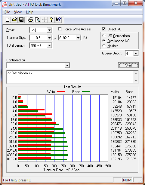

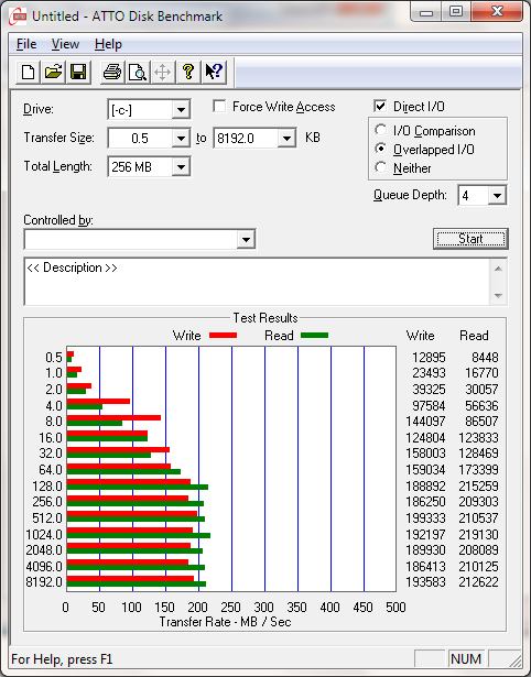

on3eighteen Posted November 2, 2010 Share Posted November 2, 2010 I've got a 15" MacBook Pro, mid 2009 (MacBookPro5,3) with the Nvidia MCP79. Just wanted to report success using the following method: ... Note: only do this with a MCP79! Normally, forcing a driver on hardware it doesn't expect is dangerous. However, in this case, it appears to be safe. I've found that Linux can use AHCI on MCP79 in legacy IDE mode, and this is why: http://fixunix.com/kernel/258426-patch-ahc...ler-ahci-c.html I have the Mid 2009 MBP too but cannot find out how to verify my chipset is MCP79. I assume since we both have the same model # it'd be the same but I wanted to be certain. Where in my Device Manager should I look? And were you able to install the Intel Rapid Storage Tech drivers after you got Windows to boot into ACHI mode? Any info is great info! Link to comment https://www.insanelymac.com/forum/topic/126089-howto-boot-macs-with-intel-chipset-in-ahci-win7-vista-xp-linux/page/8/#findComment-1575308 Share on other sites More sharing options...
johnsock Posted November 2, 2010 Share Posted November 2, 2010 I have the Mid 2009 MBP too but cannot find out how to verify my chipset is MCP79. I assume since we both have the same model # it'd be the same but I wanted to be certain. Where in my Device Manager should I look? And were you able to install the Intel Rapid Storage Tech drivers after you got Windows to boot into ACHI mode? Any info is great info! If you are operating in legacy mode, you are NOT operating in AHCI mode. You can have only one or the other. Just because you add device ID's to a driver INF file doesn't mean that you have changed the mode of operation of the controller. This linux kernel patch just allows the driver to recognize a controller that is running in legacy mode so that one driver can be used for both AHCI mode and legacy mode. Intel RST is made for Intel chipsets that are running in AHCI mode. The install will fail unless both of these conditions are met (Intel chipset & AHCI mode). The easiest way to tell what chipset you have is to look in System Profiler under Serial ATA. It will tell you what type of chipset is being used. As of now the only way to boot an MCP79 chipset Mac in AHCI mode is by booting OS X. Link to comment https://www.insanelymac.com/forum/topic/126089-howto-boot-macs-with-intel-chipset-in-ahci-win7-vista-xp-linux/page/8/#findComment-1575444 Share on other sites More sharing options...
on3eighteen Posted November 3, 2010 Share Posted November 3, 2010 I followed the steps from Zr40 for those w/ a mid-2009 MacBook Pro & the NVidia MCP79 chipset. Indeed the Microsoft IDE driver was replaced w/ the Microsoft Standard ACHI SATA! I noticed significant read performance improvement which was got in line w/ the specs of 275Mbps. However, the write performance remaining the same (~180Mbps) both before & after the change. The good news is that read performance, at least to me, is more important but I wanted to ask the group if there is a way to improve write performance. Attached is are 2 screenshots of the before & after the registry tweak along w/ the Device Manager tweak. Link to comment https://www.insanelymac.com/forum/topic/126089-howto-boot-macs-with-intel-chipset-in-ahci-win7-vista-xp-linux/page/8/#findComment-1575756 Share on other sites More sharing options...
