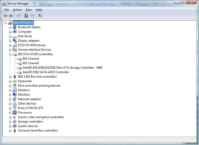

Espionage724 Posted October 26, 2009 Share Posted October 26, 2009 How could I tell if AHCI is enabled or not? And does it make a "noticeable" difference if enabled or not? Link to comment https://www.insanelymac.com/forum/topic/126089-howto-boot-macs-with-intel-chipset-in-ahci-win7-vista-xp-linux/page/5/#findComment-1311162 Share on other sites More sharing options...
ludacrisvp Posted October 27, 2009 Author Share Posted October 27, 2009 Some say that it does and some say that it doesn't, there were benchmarks posted of the difference in transfer speeds on the OnMac forums and they did show that under heavy disk use AHCI disks were better performers. To find out if you are on windows side I would open device manager and look under "IDE ATA/ATAPI Controllers" and see if anyone listed in there has AHCI in their name. Or if you are using more than 4 SATA devices you have to be in AHCI mode. Under OSX look in system profiler under SATA and it will tell you if you are using an AHCI controller. Link to comment https://www.insanelymac.com/forum/topic/126089-howto-boot-macs-with-intel-chipset-in-ahci-win7-vista-xp-linux/page/5/#findComment-1312320 Share on other sites More sharing options...
