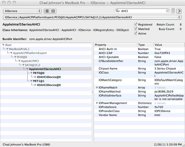

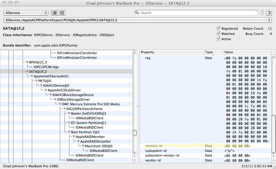

johnsock Posted March 3, 2011 Share Posted March 3, 2011 My laptop should be here by the end of this week I hope, or early next week. I can do some testing on it then. Kendall, I'll definitely take you up on that. I have another request for a screen capture from anyone who can help (thanks to JXavier for the last one!). Here is a capture from my 2010 MacBook Pro showing what info I need: The highlighted field indicates the stepping of the chipset that is present in on the motherboard. I'm trying to confirm that Apple is using the revised B3 stepping that does not suffer from SATA problems on the 3Gbps ports. Thanks everyone. I'm working on it! Link to comment https://www.insanelymac.com/forum/topic/126089-howto-boot-macs-with-intel-chipset-in-ahci-win7-vista-xp-linux/page/10/#findComment-1648305 Share on other sites More sharing options...
ludacrisvp Posted March 3, 2011 Author Share Posted March 3, 2011 Posted for user JXavier hopefully will help him with his new MacBook pro. Link to comment https://www.insanelymac.com/forum/topic/126089-howto-boot-macs-with-intel-chipset-in-ahci-win7-vista-xp-linux/page/10/#findComment-1648317 Share on other sites More sharing options...
