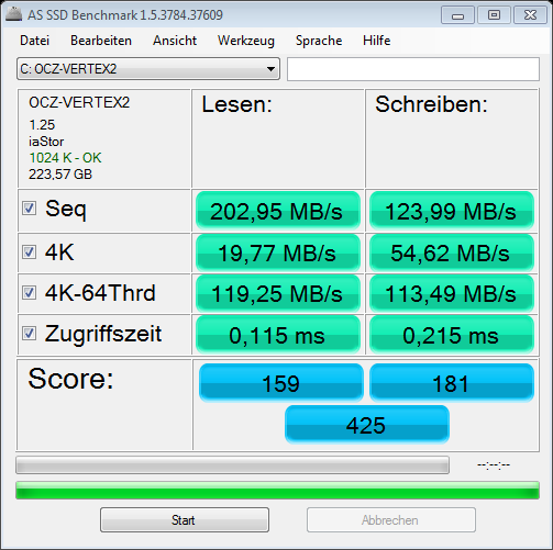

novarconda Posted January 1, 2011 Share Posted January 1, 2011 hello guys, at first: amazing work you all did here. past 2 days i got my 12-core mac pro working in ahci with the help of the enabler on an ocz-ssd. so far i was not able to switch the driver of the standard microsoft-ahci to intel matrix storage driver. i got ntoskrnl.exe-bluescreens in 124-error mode at systemstart, wich points to hardware-failure. stresstesting the hardware under standard microsoft ahci-mode shows no problems. yet i have no idea but the iastor.sys from intel causes the error. maybe there is other ways to rewrite the mbr on the windows7 hd. maybe it is the 64-bit-windows i use. two things left to say: machine does not awake from sleep (sometimes) and the windows7-startscreen stays 2 minutes and then it all goes well. its fine so far and i will stay tuned reading your comments and keep working the flaws to a minimum. best regards from germany Link to comment https://www.insanelymac.com/forum/topic/126089-howto-boot-macs-with-intel-chipset-in-ahci-win7-vista-xp-linux/page/9/#findComment-1612618 Share on other sites More sharing options...
gtelliott Posted January 4, 2011 Share Posted January 4, 2011 With my apologies, I am a bit unfamiliar with posting here, so I have previously sent this as a message to Johnsock, but post here in case any information is useful to others. My son has an early 2008 Mac Pro, updated with Snow Leopard and all updates thereto. We have installed Windows 7 64 bit on a 400 plus GB partition on a 1 TB hard drive in Bay 2, and Windows 7 has been fully updated. We also replaced one of the original optical drives with a multi-blu, connected via one of the ODD SATA ports on the motherboard. In order to recognize and use in Windows I have edited the registry (Start to 0), and have updated the driver for the SATA device found in IDE/ATA/ATAPI in the device manager to the Standard AHCI 1 driver. I then shut down computer, booted in OSX, and am prepared to do the MBR mods tonight (ran out of time). First question: There was also an "Ultra ATA" device above the SATA device in the IDE/ATA folder of device manager. . . should I have changed that driver to AHCI 1, as well? Second, is the AHCI Enabler (beta) program the latest version of that application? I have scoured the hundreds of entries since that Sept 2010 post to see, but did not see any. Thank you for any help and I am very thankful for the hardwork of those smarter than on this issue. Link to comment https://www.insanelymac.com/forum/topic/126089-howto-boot-macs-with-intel-chipset-in-ahci-win7-vista-xp-linux/page/9/#findComment-1614552 Share on other sites More sharing options...
johnsock Posted January 4, 2011 Share Posted January 4, 2011 hello guys, at first: amazing work you all did here. past 2 days i got my 12-core mac pro working in ahci with the help of the enabler on an ocz-ssd. so far i was not able to switch the driver of the standard microsoft-ahci to intel matrix storage driver. i got ntoskrnl.exe-bluescreens in 124-error mode at systemstart, wich points to hardware-failure. stresstesting the hardware under standard microsoft ahci-mode shows no problems. yet i have no idea but the iastor.sys from intel causes the error. maybe there is other ways to rewrite the mbr on the windows7 hd. maybe it is the 64-bit-windows i use. two things left to say: machine does not awake from sleep (sometimes) and the windows7-startscreen stays 2 minutes and then it all goes well. its fine so far and i will stay tuned reading your comments and keep working the flaws to a minimum. best regards from germany Guten Tag, I have heard of some others having issues with the latest Intel drivers running on Apple hardware, but I have been unable to replicate them on the hardware I have available. I'm not sure if it is something unique to the latest Mac Pro models (AHCI Enabler is untested on this model) or if the problem lies with the driver. The MBR modification is very basic and just reconfigures the chipset before booting Windows. It is possible that additional configuration is needed for the latest Mac Pro to work properly with the Rapid Storage drivers. If I ever get my hands on one, I'll definitely do some testing. I recommend trying an earlier version of the Intel drivers to see if that makes any difference. If I think of anything else I'll post it here. Link to comment https://www.insanelymac.com/forum/topic/126089-howto-boot-macs-with-intel-chipset-in-ahci-win7-vista-xp-linux/page/9/#findComment-1614573 Share on other sites More sharing options...
novarconda Posted January 4, 2011 Share Posted January 4, 2011 Guten Tag, I have heard of some others having issues with the latest Intel drivers running on Apple hardware, but I have been unable to replicate them on the hardware I have available. I'm not sure if it is something unique to the latest Mac Pro models (AHCI Enabler is untested on this model) or if the problem lies with the driver. The MBR modification is very basic and just reconfigures the chipset before booting Windows. It is possible that additional configuration is needed for the latest Mac Pro to work properly with the Rapid Storage drivers. If I ever get my hands on one, I'll definitely do some testing. I recommend trying an earlier version of the Intel drivers to see if that makes any difference. If I think of anything else I'll post it here. guten abend, i did just as you told and the bluescreens are gone (i cross fingers and knock on wood). the older drivers from intel (9.6) seem to run the machine like a bat out of hell. i will do some more testing later and give you the results. "good night and good luck" Link to comment https://www.insanelymac.com/forum/topic/126089-howto-boot-macs-with-intel-chipset-in-ahci-win7-vista-xp-linux/page/9/#findComment-1614940 Share on other sites More sharing options...
novarconda Posted January 5, 2011 Share Posted January 5, 2011 guten morgen, i just did a test with ssd-benchmark. seems to run fine so far. thanks for the help. Link to comment https://www.insanelymac.com/forum/topic/126089-howto-boot-macs-with-intel-chipset-in-ahci-win7-vista-xp-linux/page/9/#findComment-1615226 Share on other sites More sharing options...
