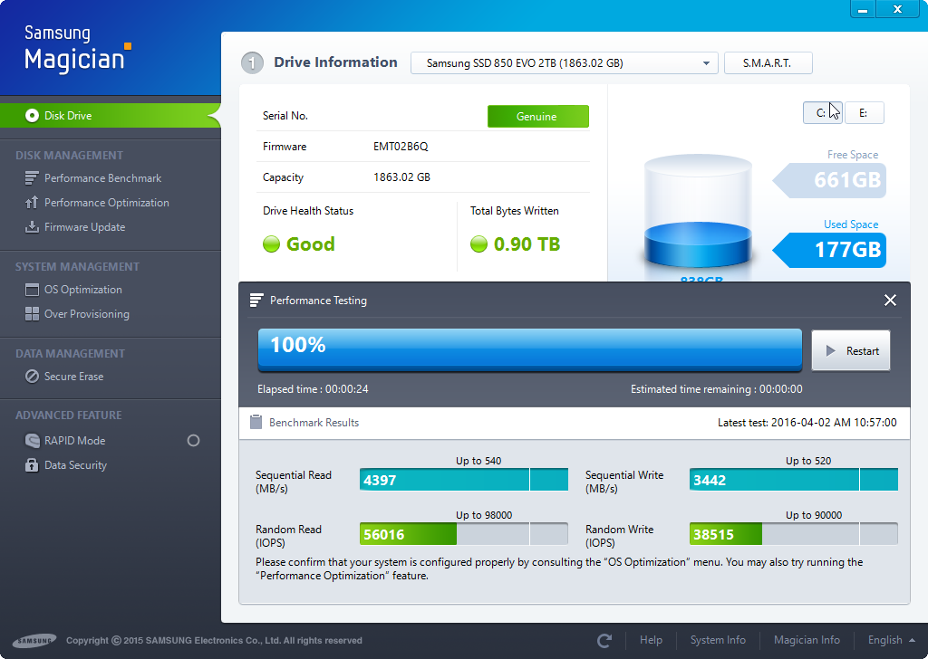

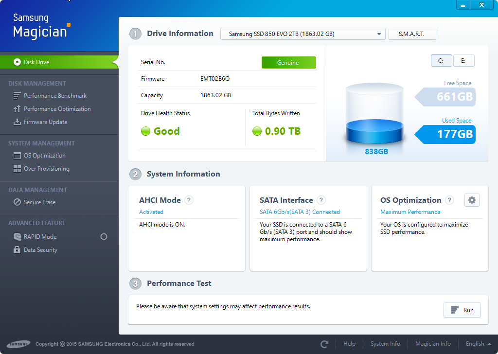

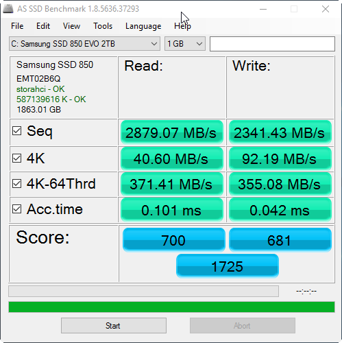

kbdi Posted April 2, 2016 Share Posted April 2, 2016 This is to confirm that I was able to successfully get Windows 10 on my late 2011 Macbook Pro running in AHCI mode! Link to comment https://www.insanelymac.com/forum/topic/126089-howto-boot-macs-with-intel-chipset-in-ahci-win7-vista-xp-linux/page/17/#findComment-2229721 Share on other sites More sharing options...
