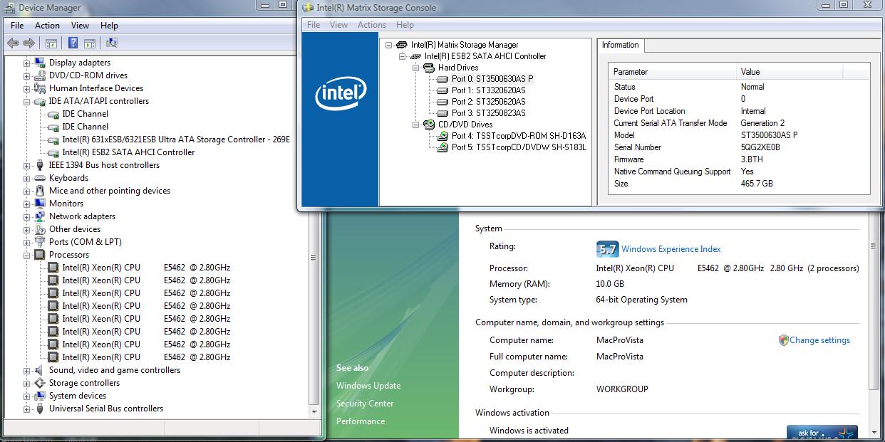

TallCoolOne Posted February 12, 2009 Share Posted February 12, 2009 Thanks for all this info, I finally got AHCI working in my Vista partition after many tries. I was trying with a GPT partition scheme drive and was not able to get it working, anytime i added the grub partition my windows would not boot anymore. Finally I tried with MBR and everything worked!...well almost everything... Now I have a different problem, my new blu-ray drive (LG BH08LS20) shows up now in Device Manager after getting AHCI working, but has a little exclamation next to it, and in the device status says "This device cannot start. (Code 10)". I searched around and found others with this error having various solutions like removing iTunes, deleting some LowerFilters and UpperFilters from a key in the registry, removing the device from device manager and resetting, etc...but nothing seems to fix it for me. I'm at a loss for what to do now, anyone have any ideas? I do have another DVD-R type device in the machine and that one works fine. I am running Vista Ultimate, and installed SP1 also hoping it would fix it, but nope.. thanks in advance.. Link to comment https://www.insanelymac.com/forum/topic/126089-howto-boot-macs-with-intel-chipset-in-ahci-win7-vista-xp-linux/page/2/#findComment-1078862 Share on other sites More sharing options...

TallCoolOne Posted February 14, 2009 Share Posted February 14, 2009 Make sure you have the latest Intel AHCI drivers installed (you should see a piece of software called "Intel Matrix Storage Manager" installed with those drivers) because the included with Vista ones really are horrible. Thanks ludacrisvp!!! This did it. I had installed the drivers from the InfInst.zip from your third post, but not the Intel AHCI ones because your directions said to skip that step if using Vista. Maybe update the steps for Vista to mention to make sure to install those drivers also on Vista after getting into AHCI mode. Thanks again for all your help! Link to comment https://www.insanelymac.com/forum/topic/126089-howto-boot-macs-with-intel-chipset-in-ahci-win7-vista-xp-linux/page/2/#findComment-1080047 Share on other sites More sharing options...

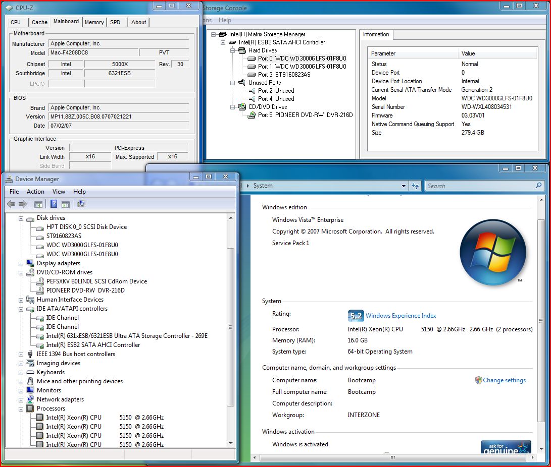

thalar Posted April 6, 2009 Share Posted April 6, 2009 I am apparently missing something because I absolutely can not get grub to load. I have been working on this for the past 4 days following ludacrisvp's instructions as well as some suggestions by others with no success. My setup is as follows: Early 2008 Mac Pro with two internal hard drives. The drive in bay 1 is Mac OS X only with Mac OS X 10.5.6 and all the most recent updates. The drive in bay 2 is Vista 64-bit only. The Vista drive has 2 partitions: the 200 MB partition that Bootcamp creates (/dev/sdb1) and the Vista NTFS partition (/dev/sdb2). I have managed to get the boot directory created on /dev/sdb1 with the grub directory inside that and the modified grub files inside that directory. My first command at the grub prompt is 'device (hd0) /dev/sdb' which just echoes the command. However, when I issue the command 'find /boot/grub/stage1' I receive 'Error 15: File not found'. If I proceed with the root command 'root (hd0,0)' the command is echoed. I then enter 'setup (hd0)' and receive "Error 17: Cannot mount selected partition'. I receive this error even if I have manually mounted the /dev/sdb1 partition using Terminal. Can anyone, please, tell me what I am doing wrong? I am using the 64-bit version of 8.04.2 of Ubuntu. The /dev/sdb1 partition is FAT32 but it does not mount automatically when I boot using the Ubuntu CD. I have to mount it in Terminal and I had to copy the boot directory to it using the 'sudo cp' command in Terminal as well. I don't know if this behavior is normal or not. I would greatly appreciate any help. Thanks! Link to comment https://www.insanelymac.com/forum/topic/126089-howto-boot-macs-with-intel-chipset-in-ahci-win7-vista-xp-linux/page/2/#findComment-1125344 Share on other sites More sharing options...

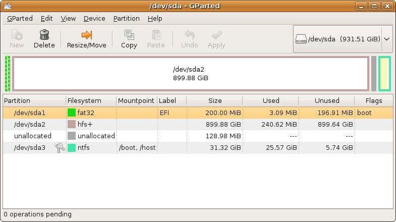

fridgeymonster3 Posted April 21, 2009 Share Posted April 21, 2009 @ludacrisvp... So, I'm too stuck at the find /boot/grub/stage1 command. I have a screenshot of gparted which I believe shows that I have a 200 MB partition at the beginning of the drive. Can someone please help with what the command line would be and whether my 200 MB FAT32 partition is on the beginning of the drive? Thanks! Link to comment https://www.insanelymac.com/forum/topic/126089-howto-boot-macs-with-intel-chipset-in-ahci-win7-vista-xp-linux/page/2/#findComment-1138174 Share on other sites More sharing options...

ludacrisvp Posted April 22, 2009 Author Share Posted April 22, 2009 I have tested the Vista loader modified MBR for Johnsock, I had to make some changes to his code so he will have to take a look at it to see why it needed to be changed to work for my Vista. We are hoping that it was just the difference because he is on original MP and I have MP 08. Driver installation for vista is really actually only a 3 step process. Change the registry key, reboot into OSX or Linux and flash the new MBR that he made, reboot into Vista and run the installation application for the Intel Matrix storage drivers. The forcing driver installs is only needed in XP because the registry cannot be modified to tell XP to look for AHCI mode controllers at boot. @fridgeymonster3 - we are currently working on a better solution that will avoid the GRUB loader and extra partitions. Yes, your EFI partition is the first one on the drive. Link to comment https://www.insanelymac.com/forum/topic/126089-howto-boot-macs-with-intel-chipset-in-ahci-win7-vista-xp-linux/page/2/#findComment-1139029 Share on other sites More sharing options...
mchaggis Posted April 22, 2009 Share Posted April 22, 2009 I got it working too, but using the 'original' MBR (good_ahci.mbr) from johnsock. I didn't do it exactly like in the post above though. Comparing the MBRs from 3 different Vista installs on different disks (johnsock's plus 2 of mine: one Bootcamp with OSX on the same disk; the other no Bootcamp, straight Vista) I found they were identical with the exception of the final 6 bytes (0x0 to 0x1B7 were identical). So I dd'd the first 0x1B8 (440 bytes) of johnsock's code onto /dev/diskX, not rdisk as suggested - when I umounted the disk in question /dev/rdiskX was no longer available. Is there a way to dd onto a mounted disk in MacOS? It told me the resource was unavailable until I umounted it. The first attempt gave a BSOD (but too fast to see the code). Before trying this I'd installed the AHCI driver as suggested. I then tried again with 'Last Good Conf' so the AHCI driver was no longer installed. This worked! It detected the AHCI devices at startup, then I loaded the Intel Storage Matrix driver and no complaints. ISM when opened shows a tree for the AHCI device with all my attached SATA drives underneath it, including NCQ enabled. I'm going to try it on the other disk (MacOS + Vista BootCamp) soon, but I'm going to get a problem dd'ing to the active disk. Is this why you use fdisk by any chance? If you're wondering, I used dd because I know exactly what it does - I wasn't sure if fdisk might try to overwrite the whole MBR with only 440 bytes of data and lose the bytes which seem to be unique per disk. More to come... Link to comment https://www.insanelymac.com/forum/topic/126089-howto-boot-macs-with-intel-chipset-in-ahci-win7-vista-xp-linux/page/2/#findComment-1139104 Share on other sites More sharing options...
mchaggis Posted April 22, 2009 Share Posted April 22, 2009 It seems to be working on my main disk now too. The process was similar, but this time I tried not installing the MS AHCI drivers before laying the patch. This resulted in a BSOD (no driver, I presume). I then had to re-lay the original MBR, boot back into Windows and install the MS AHCI drivers (I did it only 1 of the 2 SATA devices shown, the one with my HD attached to it). Then I re-relaid the patched MBR, booted into Windows and it detected the AHCI device. From then on it was plain-sailing, I just repeated the process for the second SATA controller. For some reason my 09 Mac Pro presents a 2-port SATA controller and a 4-port SATA controller separately, which is why I had to do it twice. For reference this time I laid the MBR patch using a linux LiveCD and dd. The patch was the 440 byte version I modified (by removing the last 6 bytes), rather than the 446 byte original patch from johnsock. The main stumbling block seems to be Windows drivers, and getting everything set up in the right order so Windows knows to use the right one after you transition to AHCI mode. Edit: I've since realised that the '2-port SATA controller' has not been picked up as SATA/AHCI, it still seems to be operating in legacy mode. I presume the original code was written to enable one device which controls all 4 internal HD ports AND the 2 optical ports on the older Macs; wheras Apple seems to have put 2 controllers on the 09 Mac Pro - one for the internal bays and one for the optical ports. That sound plausible? This probably contributed to my BSOD problems when I tried to install it the second time - I may have installed the MS AHCI driver on the wrong one of the 2 available ports on my first attempt. Link to comment https://www.insanelymac.com/forum/topic/126089-howto-boot-macs-with-intel-chipset-in-ahci-win7-vista-xp-linux/page/2/#findComment-1139168 Share on other sites More sharing options...
