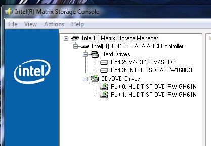

AtlantisX Posted August 23, 2013 Share Posted August 23, 2013 Hi All, I'd like to say thanks to all the posters regarding AHCI mode under Windows 7 on Mac Pros. I have AHCI working now with my 2010 Mac Pro 5,1 and I'm seeing a significant speed boost for my SSD dedicated to Windows 7 Enterprise 64-Bit. I did run into an issue though where the SATA ports for drive bays 3 and 4 do not show any drives attached. I'd like to be able to use all six ports if possible. Is there any way to enable those two ports or am I stuck in combo mode under AHCI with Windows 7? My Drives are: Optical Upper: Apple stock DVD burner Optical Lower: 4TB HGST Hard Drive (for non-boot use; HFS+) Bay 1: 1TB HGST Hard Drive (for non-boot use; NTFS) Bay 2: 512GB Samsung 840 Pro SSD (Windows 7 Enteprise 64-Bit Boot; NTFS) Bay 3: 1TB HGST Hard Drive (for non-boot use; HFS+) <<Does not show up under Windows 7>> Bay 4: 512GB Samsung 840 Pro SSD (MacOS X 10.8.4 Boot) <<Does not show up under Windows 7>> FYI (and unrelated to my Mac Pro post) - I've checked the 2012 MacBook Pro (Retina) and 2012 11" MacBook Air and found that both seem to have AHCI enabled by default under Windows 7 Enterprise 64 Bit... Both are using the same chipset for storage. Link to comment https://www.insanelymac.com/forum/topic/126089-howto-boot-macs-with-intel-chipset-in-ahci-win7-vista-xp-linux/page/15/#findComment-1940765 Share on other sites More sharing options...
ludacrisvp Posted August 23, 2013 Author Share Posted August 23, 2013 My 3,1 is able to use all 6 SATA ports in windows. Not sure why the 5,1 would be any different. I've run 8 internal drives off of my Mac in the past, 2 PATA, 6 SATA. Did you install the newer intel storage AHCI drivers or keep the stock Microsoft ones? Link to comment https://www.insanelymac.com/forum/topic/126089-howto-boot-macs-with-intel-chipset-in-ahci-win7-vista-xp-linux/page/15/#findComment-1940791 Share on other sites More sharing options...
AtlantisX Posted August 23, 2013 Share Posted August 23, 2013 I am using the Intel Storage Matrix v8.9 drivers. For the drives that show up (optical upper optical lower, bay 1 and bay 2), performace is better under AHCI. I do seem to recall that the SATA controllers are different in the 5,1 (ICH10R) vs. an older ESxxx controller but not sure if that matters in this case but I suspect it might in terms of patching the MBR. I did see a post somewhere (I can't seem to find it again) that mentioned a code change to the MBR patch to disable combined mode under the AHCI on the 5,1. I used patchedcode.bin to patch the MBR but not sure if it was the latest version floating around out there or not or if there is a version for ICH10R Mac Pros. Any thoughts? Link to comment https://www.insanelymac.com/forum/topic/126089-howto-boot-macs-with-intel-chipset-in-ahci-win7-vista-xp-linux/page/15/#findComment-1940801 Share on other sites More sharing options...
