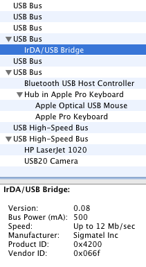

VaiOSX Posted March 6, 2006 Share Posted March 6, 2006 If your PC has Infrared built-in you can try this hack (it will probably work with an external USB Infrared receiver) This is the system profiler result for the USB IR receiver IR Receiver: Version: 1.10 Bus Power (mA): 500 Speed: Up to 12 Mb/sec Manufacturer: Apple Computer, Inc. Product ID: 0x8240 Vendor ID: 0x05ac (Apple Computer, Inc.) 8240 is Hexa, when you convert it to Decimal you'll get 33344 05ac is Hexa, when you convert it to Decimal you'll get 1452 You must check in Windows or Linux for the Vendor and Product ID of your IR receiver. Then go to this website and convert it (don't type 0x in the value to convert) http://www.easycalculation.com/hex-converter.php Then, edit the Info.plist inside AppleIRController.kext and replace it with the decimal numbers you just converted. <key>idProduct</key><integer>33344</integer> <key>idVendor</key> <integer>1452</integer> in the terminal you must type sudo chmod -R 755 /System/Library/Extensions/AppleIRController.kext sudo chown -R root:wheel /System/Library/Extensions/AppleIRController.kext sudo kextcache -k /System/Library/Extensions and Voilà ! You can now restart and check with the tiny remote controller. Link to comment https://www.insanelymac.com/forum/topic/11197-using-the-frontrow-apple-remote-controller/ Share on other sites More sharing options...

Krazubu Posted March 2, 2008 Share Posted March 2, 2008 This kext is designed for built-in IR receivers (which mean directly linked with the mobo). So it should work for built-in IR receivers, but not with USB ones that require a totally different driver. Link to comment https://www.insanelymac.com/forum/topic/11197-using-the-frontrow-apple-remote-controller/#findComment-651199 Share on other sites More sharing options...
mtotho Posted March 2, 2008 Share Posted March 2, 2008 @krazubu, Oh. I am gonna try an apple remote in an hour or so.. i am getting one soon. Is there a chance it will work.. my usb device is detected as "P5W DH Remote". Is there a kext for the usb ir remote i can edit? thanks the apple remote didnt work. Link to comment https://www.insanelymac.com/forum/topic/11197-using-the-frontrow-apple-remote-controller/#findComment-651316 Share on other sites More sharing options...
