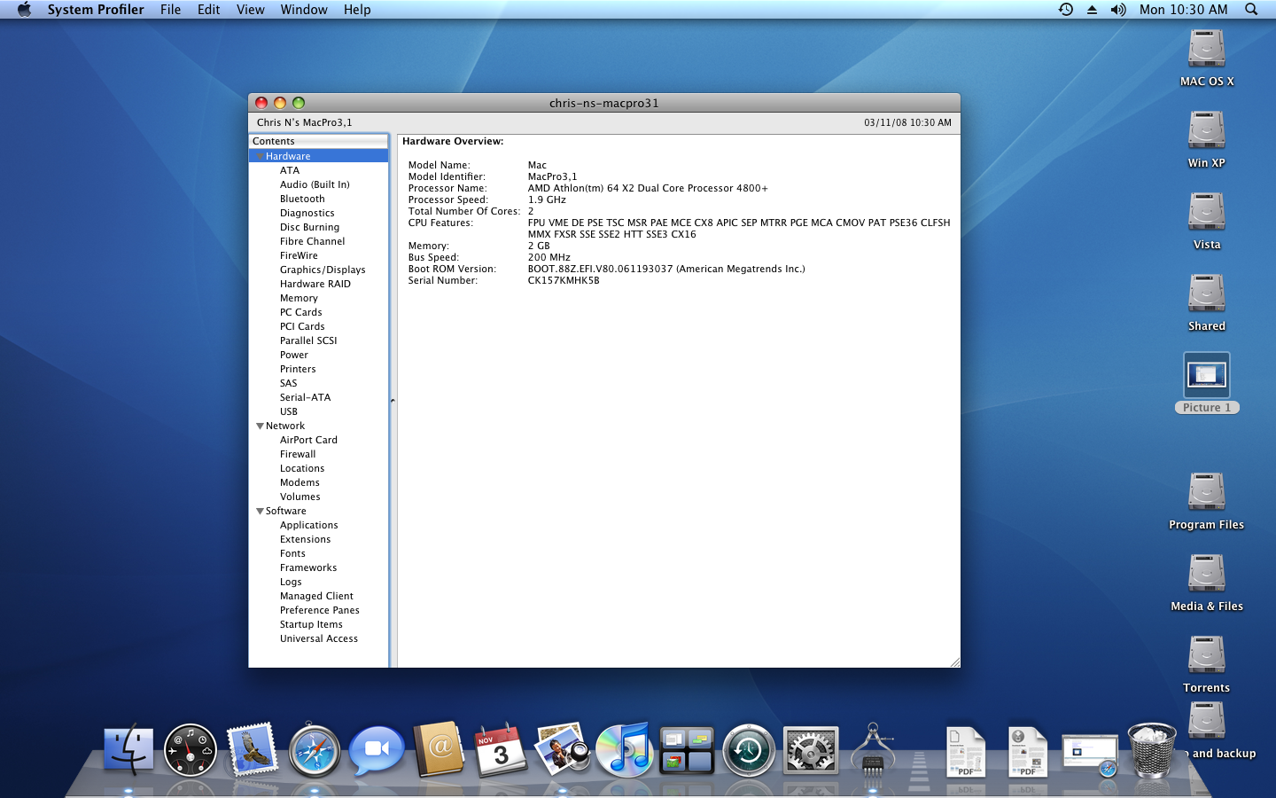

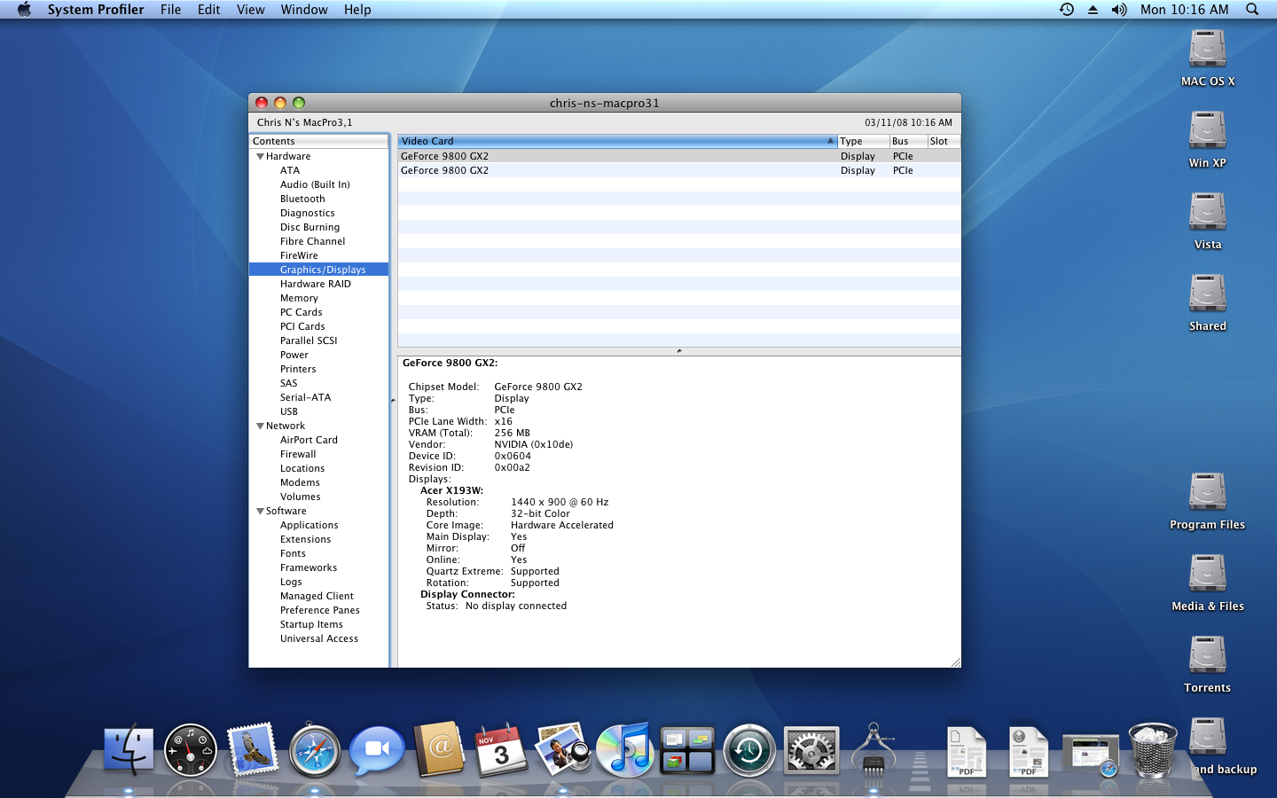

qualsiasi Posted August 29, 2008 Share Posted August 29, 2008 UPDATE: i got it working guys here's a snapshot of it This is very nice, congratulations So you got it working with leo4all? witch mobo you belong? Link to comment https://www.insanelymac.com/forum/topic/110366-how-to-make-9800gx2-work-in-mac-leopard-1055-qeci-enabled-works-on-nvidia-mbs-only/page/4/#findComment-872858 Share on other sites More sharing options...

Azamic Posted September 28, 2008 Author Share Posted September 28, 2008 How is it working with 10.5.5 ? Does it need a nvidia motherboard to work or any motherboard can use this "guide" ? Japhex I recently updated to 10.5.5 using the combo update from apple website and still have my GX2 working in tip top condition. Caution: This guide may not yield results for non-nvidia motherboards, so please proceed at your own risk. Link to comment https://www.insanelymac.com/forum/topic/110366-how-to-make-9800gx2-work-in-mac-leopard-1055-qeci-enabled-works-on-nvidia-mbs-only/page/4/#findComment-909218 Share on other sites More sharing options...
