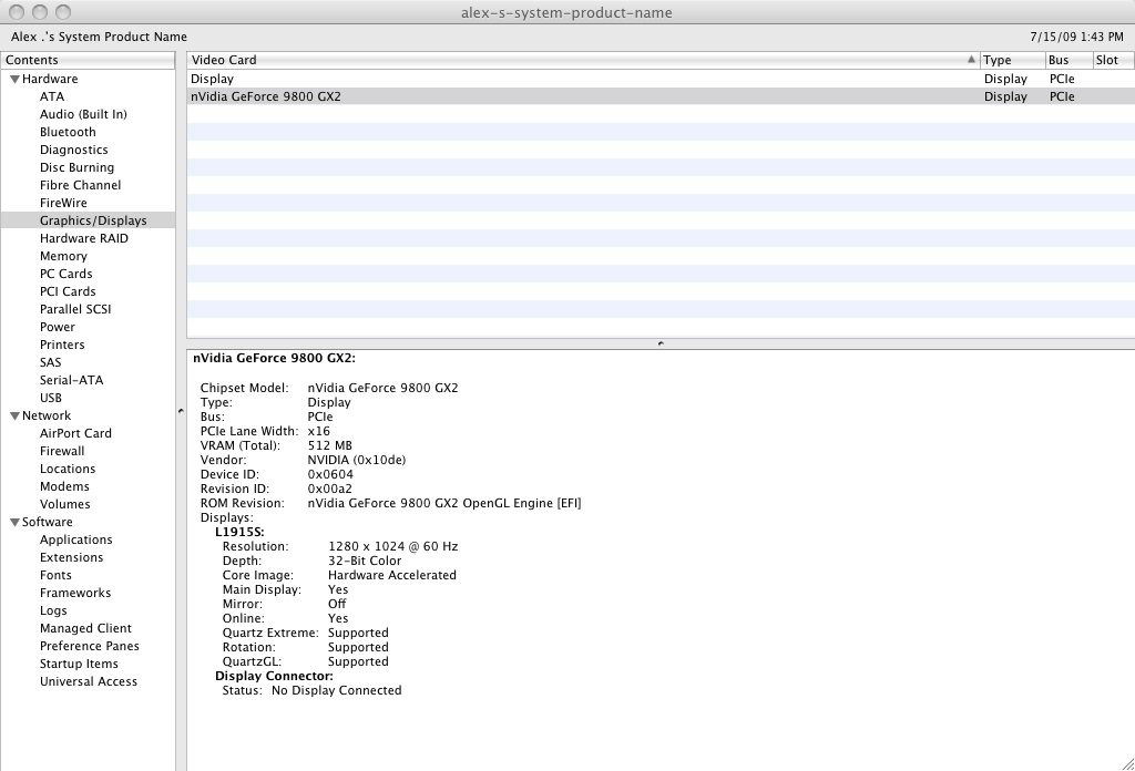

(_Alex_) Posted July 14, 2009 Share Posted July 14, 2009 Woooow! I did it!! It works with hardware accelerated I can't believe it!! Ffosilva you are the man! Just one problem, I have only one card recognized because I don't know how to add 2 gfx card strings into apple.com.Boot.plist. (9800gx2 has 2 gfx cards embedded) MB> ABIT IP35 RAM> 4X1Gb DDR800 G.Skill GFX> Asus nvidia Gforce 9800 GX2 OS> Vista SP2 64bits & Leopard 10.5.7 Link to comment https://www.insanelymac.com/forum/topic/110366-how-to-make-9800gx2-work-in-mac-leopard-1055-qeci-enabled-works-on-nvidia-mbs-only/page/5/#findComment-1200435 Share on other sites More sharing options...
ffosilva Posted July 15, 2009 Share Posted July 15, 2009 alex, post your pci address got on gfxutil. on my computer, gfxutil detected pci address PciRoot(0x1)/Pci(0x1,0x0)/Pci(0x0,0x0)/Pci(0x2,0x0)/Pci(0x0,0x0). I found the another board by changing '2' to '0' and used same strings for it. 2nd board is on PciRoot(0x1)/Pci(0x1,0x0)/Pci(0x0,0x0)/Pci(0x0,0x0)/Pci(0x0,0x0) on my case. I think you take the address that gfxutil detected and change only the bold values. PciRoot(0x1)/Pci(0x1,0x0)/Pci(0x0,0x0)/Pci(0x2,0x0)/Pci(0x0,0x0) PciRoot(0x1)/Pci(0x1,0x0)/Pci(0x0,0x0)/Pci(0x0,0x0)/Pci(0x0,0x0) if you have 2, create another key using 0, and vice versa. Link to comment https://www.insanelymac.com/forum/topic/110366-how-to-make-9800gx2-work-in-mac-leopard-1055-qeci-enabled-works-on-nvidia-mbs-only/page/5/#findComment-1200921 Share on other sites More sharing options...
(_Alex_) Posted July 15, 2009 Share Posted July 15, 2009 Hello, Gfxutil returns the following: DevicePath = PciRoot(0x1)/Pci(0x1,0x0)/Pci(0x0,0x0)/Pci(0x2,0x0)/Pci(0x0,0x0) Also under Windows I've found this): PCIROOT(0)/PCI(0100)/PCI(0000)/PCI(0200)/PCI(0000) PCIROOT(0)/PCI(0100)/PCI(0000)/PCI(0000)/PCI(0000) I used OSx86 Tool utility to add EFI strings from my gfx card, the real problem is that I have no idea how does it work to insert strings for both gpus. I only managed to insert once at a time so, is there any other software to accomplish this easier? This is my Property List File (plist) <?xml version="1.0" encoding="UTF-8"?> <!DOCTYPE plist PUBLIC "-//Apple//DTD PLIST 1.0//EN" "http://www.apple.com/DTDs/PropertyList-1.0.dtd"> <plist version="1.0"> <dict> <key>PciRoot(0x1)/Pci(0x1,0x0)/Pci(0x0,0x0)/Pci(0x2,0x0)/Pci(0x0,0x0)</key> <dict> <key>@0,compatible</key> <string>NVDA,NVMac</string> <key>@0,device_type</key> <string>display</string> <key>@0,name</key> <string>NVDA,Display-A</string> <key>@1,compatible</key> <string>NVDA,NVMac</string> <key>@1,device_type</key> <string>display</string> <key>@1,name</key> <string>NVDA,Display-B</string> <key>NVCAP</key> <data> BAAAAAAAAwAMAAAAAAAABwAAAAA= </data> <key>NVPM</key> <data> AQAAAAAAAAAAAAAAAAAAAAAAAAAAAAAAAAAAAA== </data> <key>VRAM,totalsize</key> <string>0x20000000</string> <key>device_type</key> <string>NVDA,Parent</string> <key>model</key> <string>nVidia GeForce 9800 GX2</string> <key>name</key> <string>display</string> <key>rom-revision</key> <string>nVidia GeForce 9800 GX2 OpenGL Engine [EFI]</string> </dict> </dict> </plist> ⁃ And this is the hexadecimal EFI String (device-properties), what I really inserted into my apple.com.Boot.plist file 7a02000001000000010000006e0200000d00000002010c00d041030a010000000101060000010101 60000000101060000020101060000007fff04000e0000004e00560050004d0000002000000001000 00000000000000000000000000000000000000000000000000220000005600520041004d002c0074 06f00740061006c00730069007a006500000008000000000000201c0000006400650076006900630 65005f00740079007000650000000f0000004e5644412c506172656e740e0000006e0061006d0065 000000b000000646973706c617922000000400030002c006400650076006900630065005f0074007 007000650000000b000000646973706c617922000000400031002c00640065007600690063006500 f00740079007000650000000b000000646973706c6179100000006d006f00640065006c0000001b0 00006e5669646961204765466f72636520393830302047583220000000400031002c0063006f006d 0700061007400690062006c00650000000e0000004e5644412c4e564d616314000000400030002c0 6e0061006d0065000000120000004e5644412c446973706c61792d4114000000400031002c006e00 1006d0065000000120000004e5644412c446973706c61792d4220000000400030002c0063006f006 00700061007400690062006c00650000000e0000004e5644412c4e564d6163100000004e00560043 04100500000001800000004000000000003000c00000000000007000000001e00000072006f006d0 2d007200650076006900730069006f006e0000002f0000006e5669646961204765466f7263652039 8303020475832204f70656e474c20456e67696e65205b4546495d How do I change the plist file to content both GPU cores of my 9800GX2? And, how to convert it to hexadecimal? OSx86 Tools did it for me automatically. Link to comment https://www.insanelymac.com/forum/topic/110366-how-to-make-9800gx2-work-in-mac-leopard-1055-qeci-enabled-works-on-nvidia-mbs-only/page/5/#findComment-1201284 Share on other sites More sharing options...
ffosilva Posted July 16, 2009 Share Posted July 16, 2009 You will use this property list: <?xml version="1.0" encoding="UTF-8"?> <!DOCTYPE plist PUBLIC "-//Apple//DTD PLIST 1.0//EN" "http://www.apple.com/DTDs/PropertyList-1.0.dtd"> <plist version="1.0"> <dict> <key>PciRoot(0x1)/Pci(0x1,0x0)/Pci(0x0,0x0)/Pci(0x2,0x0)/Pci(0x0,0x0)</key> <dict> <key>@0,compatible</key> <string>NVDA,NVMac</string> <key>@0,device_type</key> <string>display</string> <key>@0,name</key> <string>NVDA,Display-A</string> <key>@1,compatible</key> <string>NVDA,NVMac</string> <key>@1,device_type</key> <string>display</string> <key>@1,name</key> <string>NVDA,Display-B</string> <key>NVCAP</key> <data> BAAAAAAAAwAMAAAAAAAABwAAAAA= </data> <key>NVPM</key> <data> AQAAAAAAAAAAAAAAAAAAAAAAAAAAAAAAAAAAAA== </data> <key>VRAM,totalsize</key> <string>0x20000000</string> <key>device_type</key> <string>NVDA,Parent</string> <key>model</key> <string>nVidia GeForce 9800 GX2</string> <key>name</key> <string>display</string> <key>rom-revision</key> <string>nVidia GeForce 9800 GX2 OpenGL Engine [EFI]</string> </dict> <key>PciRoot(0x1)/Pci(0x1,0x0)/Pci(0x0,0x0)/Pci(0x0,0x0)/Pci(0x0,0x0)</key> <dict> <key>@0,compatible</key> <string>NVDA,NVMac</string> <key>@0,device_type</key> <string>display</string> <key>@0,name</key> <string>NVDA,Display-A</string> <key>@1,compatible</key> <string>NVDA,NVMac</string> <key>@1,device_type</key> <string>display</string> <key>@1,name</key> <string>NVDA,Display-B</string> <key>NVCAP</key> <data> BAAAAAAAAwAMAAAAAAAABwAAAAA= </data> <key>NVPM</key> <data> AQAAAAAAAAAAAAAAAAAAAAAAAAAAAAAAAAAAAA== </data> <key>VRAM,totalsize</key> <string>0x20000000</string> <key>device_type</key> <string>NVDA,Parent</string> <key>model</key> <string>nVidia GeForce 9800 GX2</string> <key>name</key> <string>display</string> <key>rom-revision</key> <string>nVidia GeForce 9800 GX2 OpenGL Engine [EFI]</string> </dict> </dict> </plist> Link to comment https://www.insanelymac.com/forum/topic/110366-how-to-make-9800gx2-work-in-mac-leopard-1055-qeci-enabled-works-on-nvidia-mbs-only/page/5/#findComment-1201459 Share on other sites More sharing options...
ffosilva Posted July 16, 2009 Share Posted July 16, 2009 Are attached device properties in both formats: hex and plist. I modified it to work with your configuration. Archive.zip Link to comment https://www.insanelymac.com/forum/topic/110366-how-to-make-9800gx2-work-in-mac-leopard-1055-qeci-enabled-works-on-nvidia-mbs-only/page/5/#findComment-1202064 Share on other sites More sharing options...

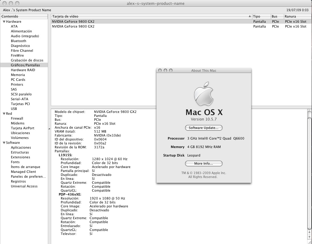

(_Alex_) Posted July 17, 2009 Share Posted July 17, 2009 Are attached device properties in both formats: hex and plist. I modified it to work with your configuration. We should change the topic title [HOW TO]: Make 9800GX2 work in Mac Leopard 10.5.7! QE/CI Enabled! (WORKS ON INTEL M/Bs) YEAAAH!!!! Both gpus detected! Ffosilva thank you very much for your support! and also to this forum for been there when I needed So for the rest of the people still trying to get this gfx card to work under intel chipset motherboards, these are the steps: 1. Install 10.5.7 Leopard OS (I'm using iAtkos v7) 2. Extract kexts from NVIDIA Gforce 285 Retail Mac Driver Installer (http://www.evga.com/support/drivers/) using Pacifist and copy all of them to the Extensions folder (no needed to add ID vendor/device) 3. Generate Gfx strings for Gforce 9800 GX2 and add the strings into the file apple.com.Boot.plist as hexadecimal data (I used the files from Post #121 uploaded by ffosilva) 4. Repair permissions and restart using -f command the first time only I put this screenshot of everything working in my abit IP35 motherboard Intel ICH9 and Asus Gforce 9800 GX2 graphic card. And now... is there any support for ps2 keyboards on leopard 10.5.7 or only usb is supported? Link to comment https://www.insanelymac.com/forum/topic/110366-how-to-make-9800gx2-work-in-mac-leopard-1055-qeci-enabled-works-on-nvidia-mbs-only/page/5/#findComment-1202713 Share on other sites More sharing options...
