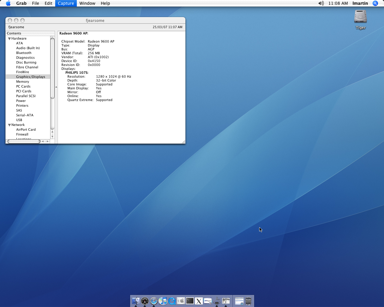

gambl0r Posted March 25, 2007 Share Posted March 25, 2007 To get this working with an AGP 9600 PRO 256mg (device id = 4150) and a CRT monitor: 1. Apply largos patch 2. Acquire Callisto_b008 3. Remove /System/Library/Extensions/Callisto* 4. Follow instructions included with Callisto_b008 (the main part is correcting the EDID section in Callisto.kext/Contents/Info.plist so it matches your monitor EDID) 5. Profit. Link to comment Share on other sites More sharing options...
