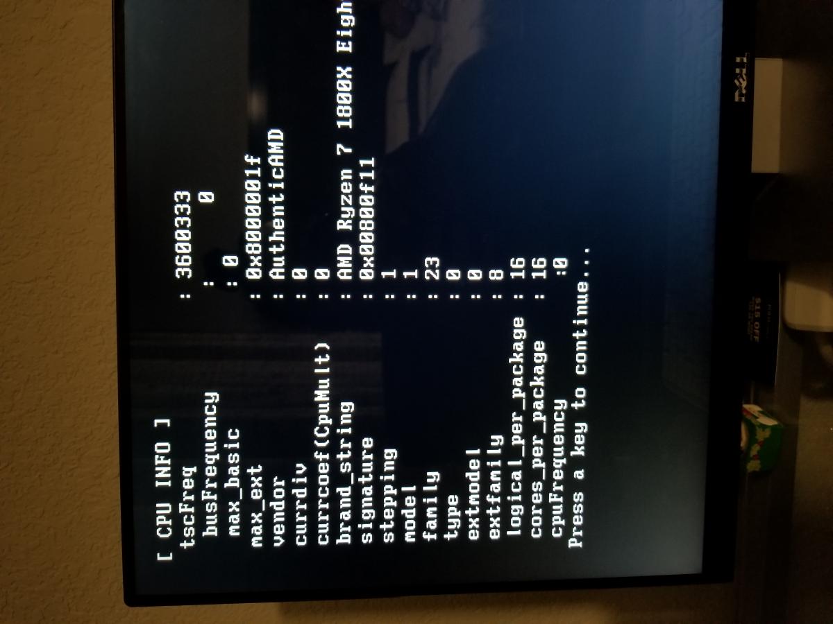

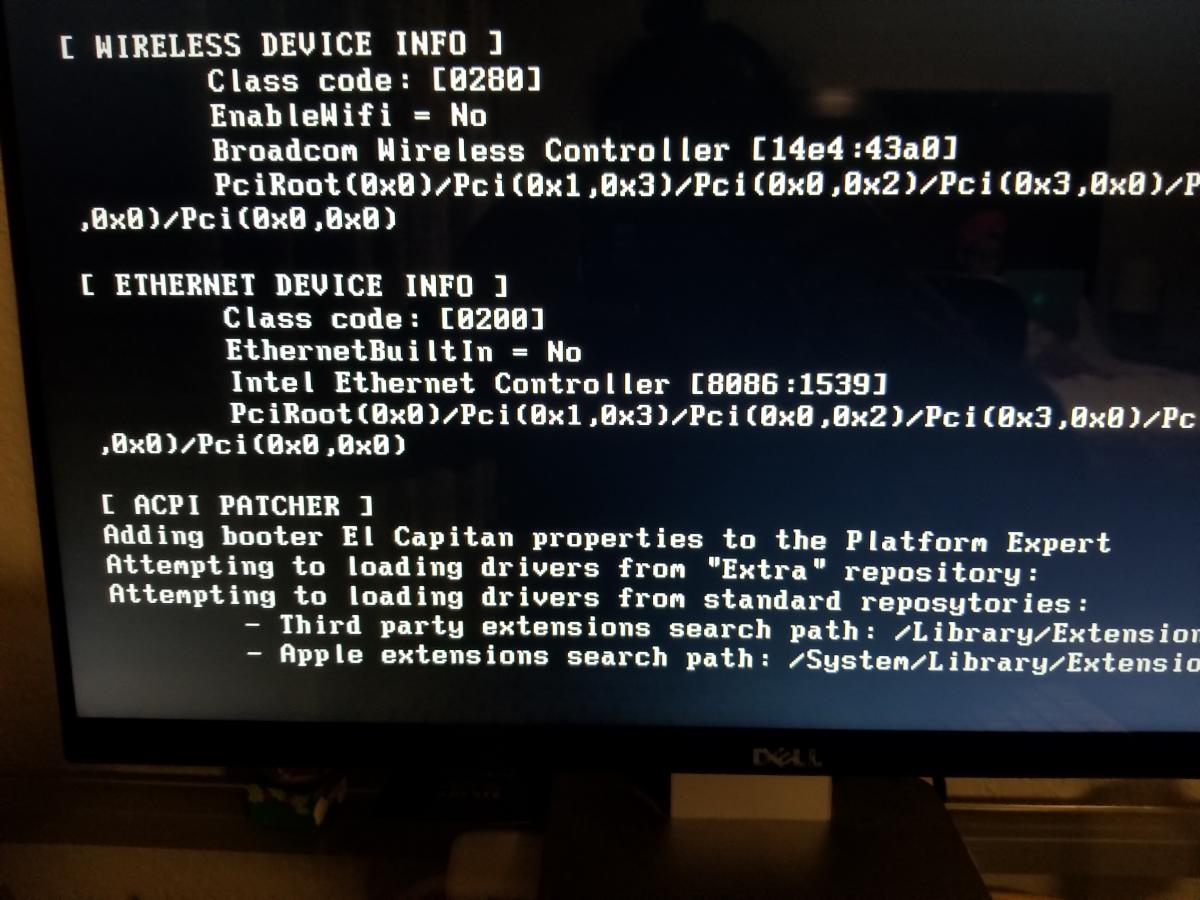

Ok to sum up so far, the new Kernel and other files work great!    I cannot get the new boot test zip to boot correctly      Using the original Boot and the new kernel and other files has allowed me to overclock my Ryzen 7 1700 to 3800 MHz with stability.    3900MHz crashes at boot up, I have stock fan system.
With original boot file I need to add busratio=(38 or whatever my CPU bios setting is) or I get the 1/2 performance or frequency issue.  see pics.     Notice the RX 480 compute benchmarks as well.   It affects both the CPU and Graphics cards the same way, 1/2 performance level.
machdep.tsc.frequency: 3800118979
GigamaxxRyzenSierra2s-MacBook:~ gigamaxxryzensierra2$

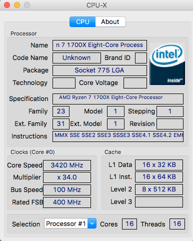

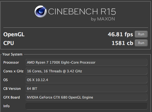

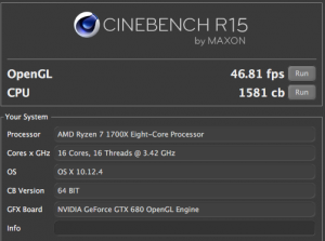

I got a little different solution to fix my previous issues:
BIOS setting: 100.60000 x 34 (=3420 Mhz)
Boot: Bronya Boot (Chameleon 2.3svn (svn-r2667 Bronya) [2017-05-07 04:40:10])
(booted by 2017-04-27 version will get lower test score in Cinebench R15)
Boot Args: dart=0 colors=32 kext-dev-mode=1 -v npci=0x3000 PCIRootUID=1 busratio=35
Kernel: [Darwin Kernel Version 16.5.0: воскресенье,  7 мая 2017 г. 19:48:57 (MSK); root:xnu-3789.51.2/BUILD/obj/RELEASE_X86_64]
Timer runs within tolerable difference from actually normal reference (about secs slower)
Performance is the best I have got up to now !
Stability is very very good !

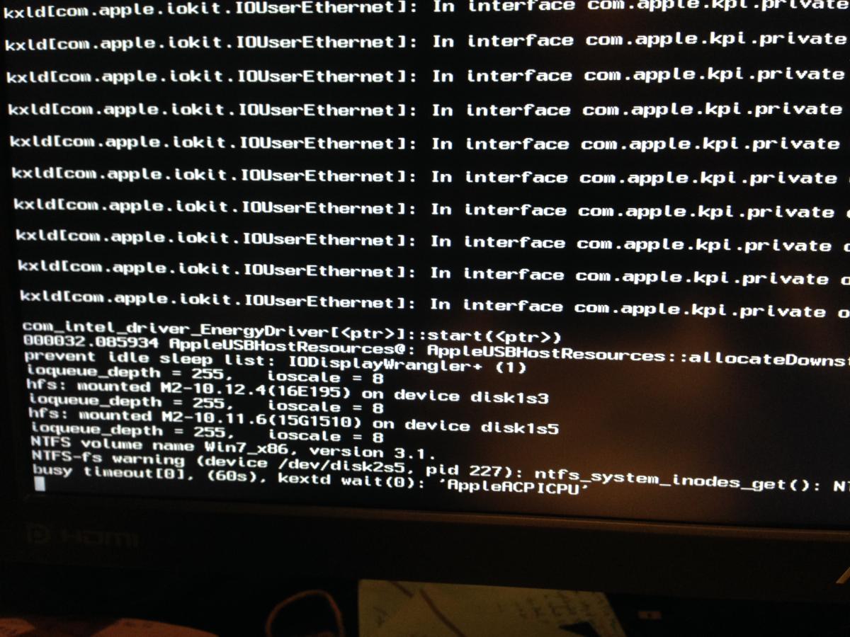

The only bug is this new kernel always slow down around busy timeout related to AppleACPICPU which means longer time to login desktop during booting.
1700X-3420Mhz.txt

2. Booting time is a little bit long, esp. slow down around busy timeout(0) 60 sec, AppleACPICPU ........ during booting.

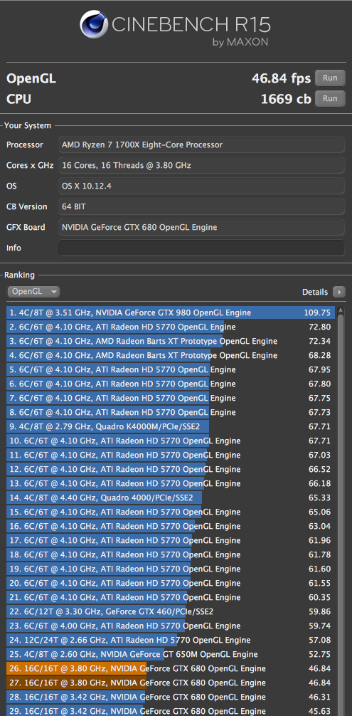

The timer issue can be fixed by BIOS setting changed to 3800 Mhz (=100.0000 x 38)

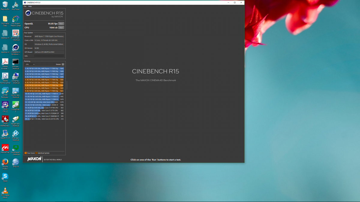

Your newest kernel can get correct machdep.tsc.frequency and get better testing scores than 3420 or 3500 Mhz by Cinebench R15.
Ths is the first time I got Cinebench R15 CPU testing score in Mac OS X was greater than it in Windows with the same hardware.
1700X-3800Mhz.txt

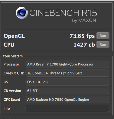

Unfortunately I cannot get proper frequency results with the new rc4 kernel, I will do more tests. The problem is that I always get a lower benchmarks scores compared to Win (1700CB) - Mac (about1500CB, never hit 1600) (same settings in bios).
Of course I adjusted the busratio=x according to my nominal cpu freq (eg. 38 for 3800 - 36 for 3600, etc.)

i have a kernel_task process that slow down my system and explain the low cb score. I have to understand why. I'll try to apply new kernel again.

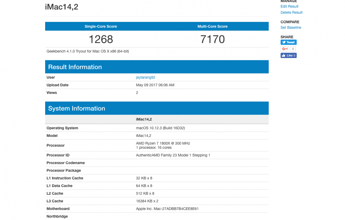

 @jaytaragan : I do not know if we should rely on his results?

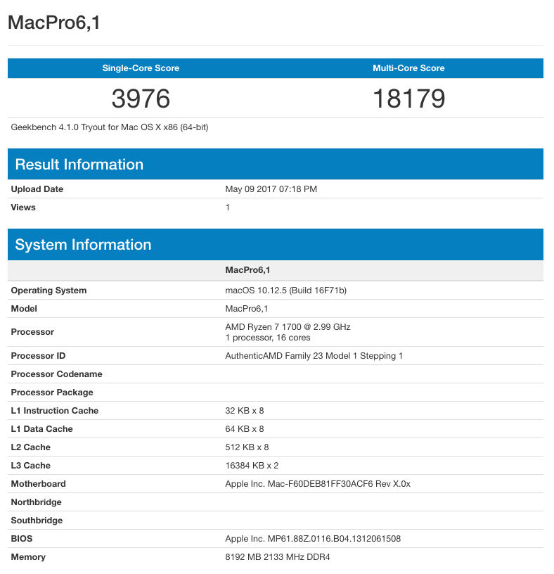

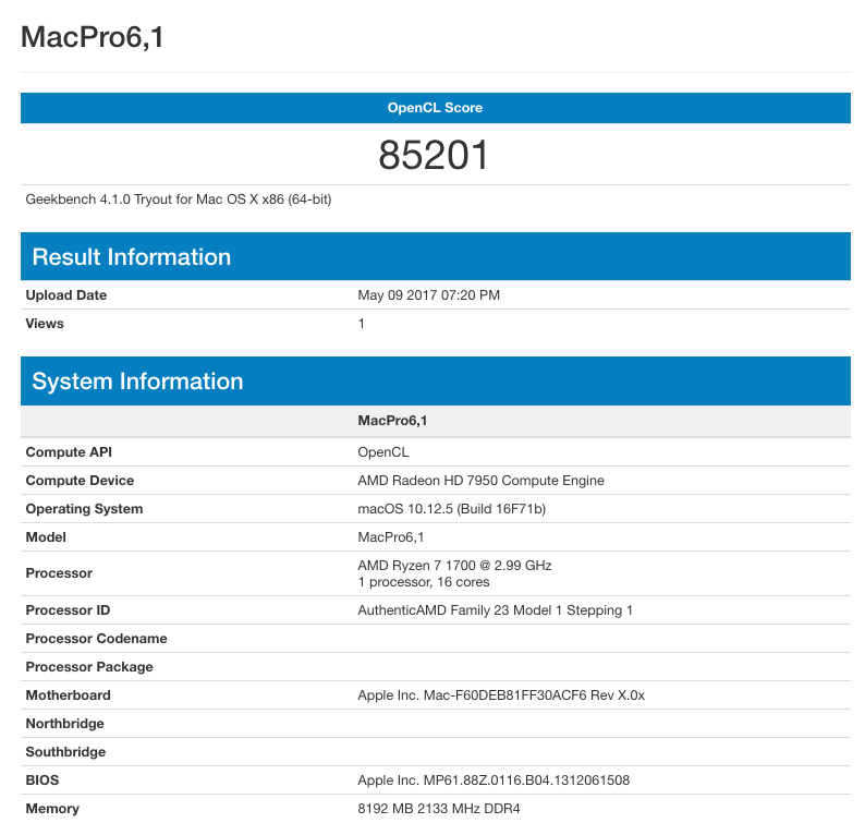

My result :
