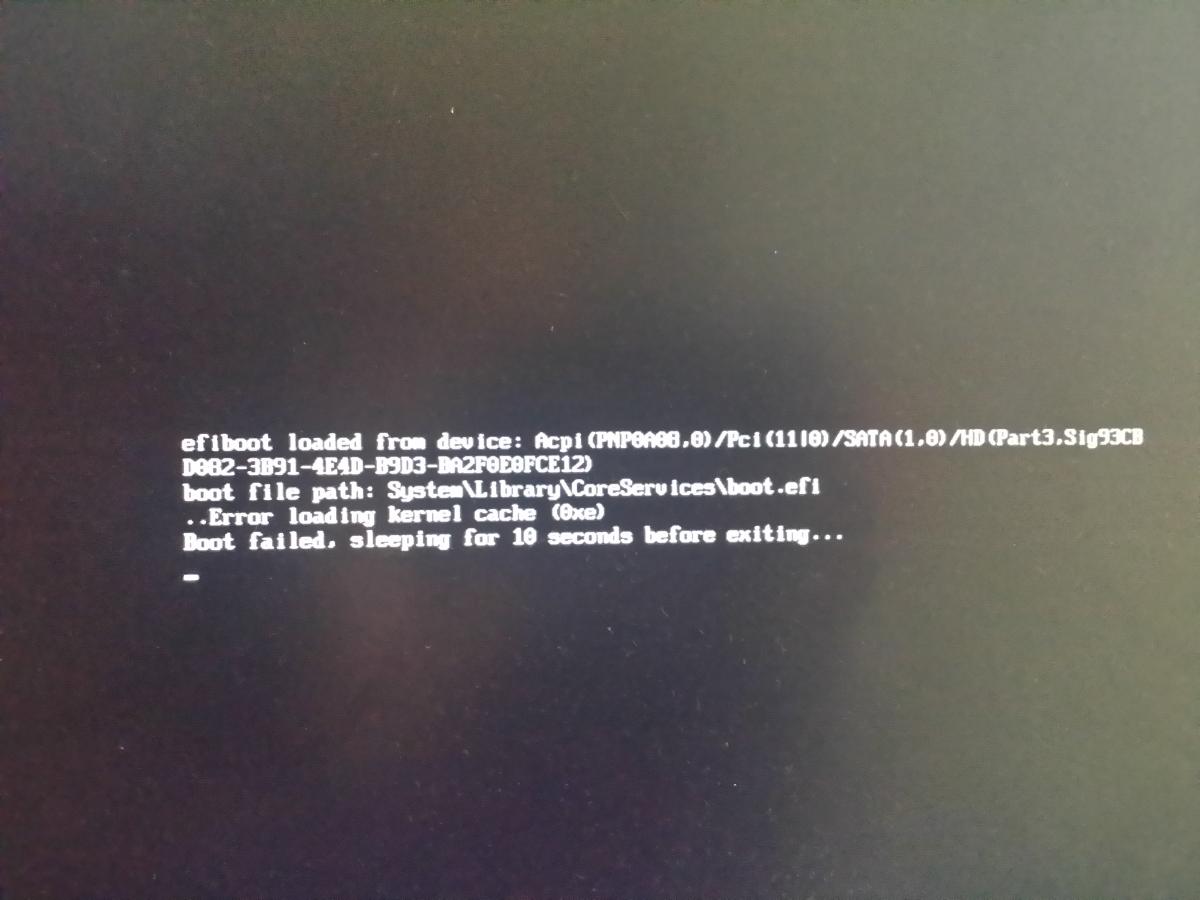

I had it set to 1920x1080 in the config.plist but it's not supported so it was defaulting to 800x600. I set it to 1280x800 in config.plist and voila! Its at least a much better resolution... Unfortunately it is still not full screen as I still have black borders around the whole loader.
EDIT* Oh, I've forgotten to mention, the mouse does not work in the loader. I have read that this is a pretty common issue though. It will move around if I click wildly though.. so it's at least seeing some kinda input.

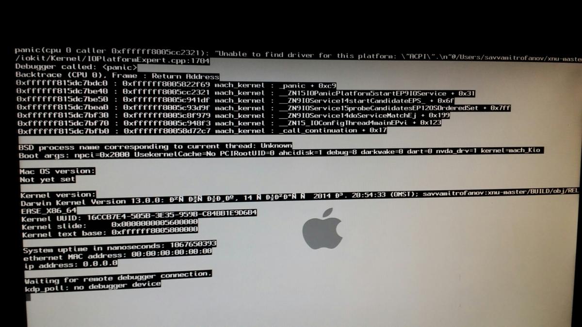

Hi Slice, now I have installed on one of my HDD Mavericks 10.9 and Clover. As a test kernel I taken the last kernel by KIO.
I've used in this test your last Clover data that you have uploaded.
Now the system stuck in kernel panic, see the image
This panic corresponds to bad patched DSDT.
What should I do in your opinion?
You write I should boot without DSDT.aml. But the DSDT.aml is modified to fit on my system, so far my system ran perfectly with it. Or perhaps I have you misunderstood?
What should I do in your opinion? <br />You write I should boot without DSDT.aml. But the DSDT.aml is modified to fit on my system, so far my system ran perfectly with it. Or perhaps I have you misunderstood?
if u have your own dsdt.aml then disable dsdt fixes in config.plist
