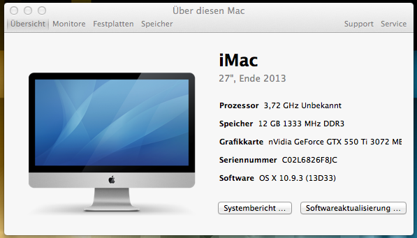

1. Software Info:
System Version: OS X 10.9.2 (13C62)
Kernel Version: Darwin 13.0.0
Boot Volume: Mac OSX 10.9.1 test
Boot Mode: Normal
Computer Name: mein’s iMac
Secure Virtual Memory: Enabled
Time since boot: 14 minutes
2. Hardware Info:
Model Name: iMac
Model Identifier: iMac14,2
Processor Name: 6-Core Intel Xeon
Processor Speed: 3,72 GHz
Number of Processors: 1
Total Number of Cores: 6
L2 Cache (per Core): 512 KB
L3 Cache: 72 KB
Memory: 12 GB
Bus Speed: 800 MHz
Boot ROM Version: IM141.0118.B00
SMC Version (system): 1.30f3
