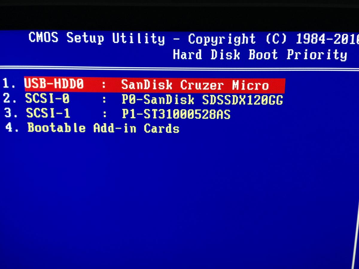

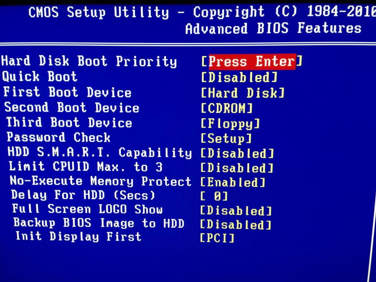

Indeed it could be a BIOS setting also....when your machine is POSTing with only your FAT32 Clover USB plugged in,
  • press <Del>
  • set your BIOS to use optimised defaults first
  • then change hard disk operation mode from IDE to AHCI
  • HPET mode set to 64 bit
  • In the boot order section of your BIOS (it may be in "Advanced BIOS Features" under "Hard Disk Boot Priority"), set your FAT32 Clover USB as the first option (use + key to move it up to the top)
  • Press F10 to save BIOS settings & reboot
Cross fingers and hope you see the Clover menu.  For a non uefi boot, there is usually a 10-20 sec wait before it appears....

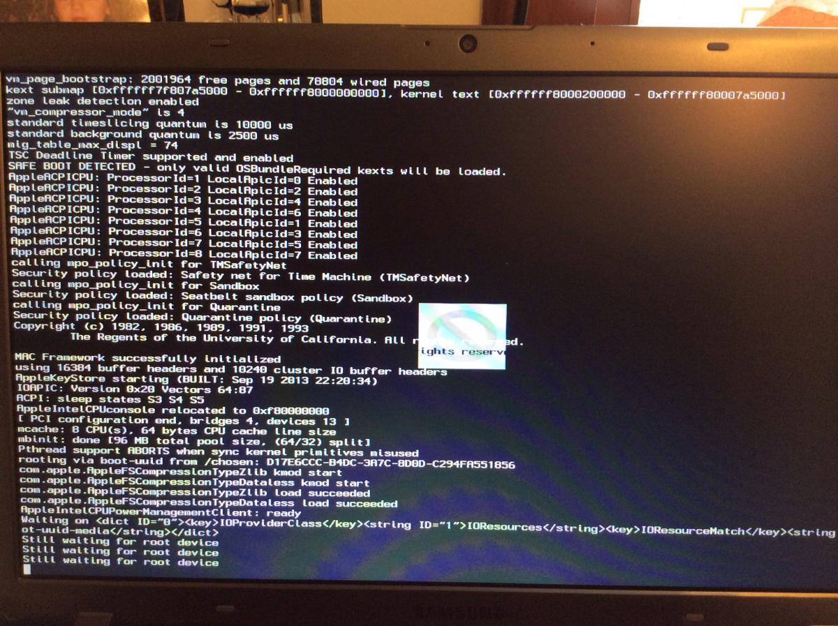

Hello to all. I created a USB stick with Clover by following the guidance. I have successfully efi partition and the partition contains the installer ch Maverick. I boot from usb and launch the installation of Maverick but always freezes and I can not continue. can you help me? This is my notebook http://www.samsung.com/it/consumer/pc-peripherals-printer/notebook/essential/NP350V5C-S08IT-spec
