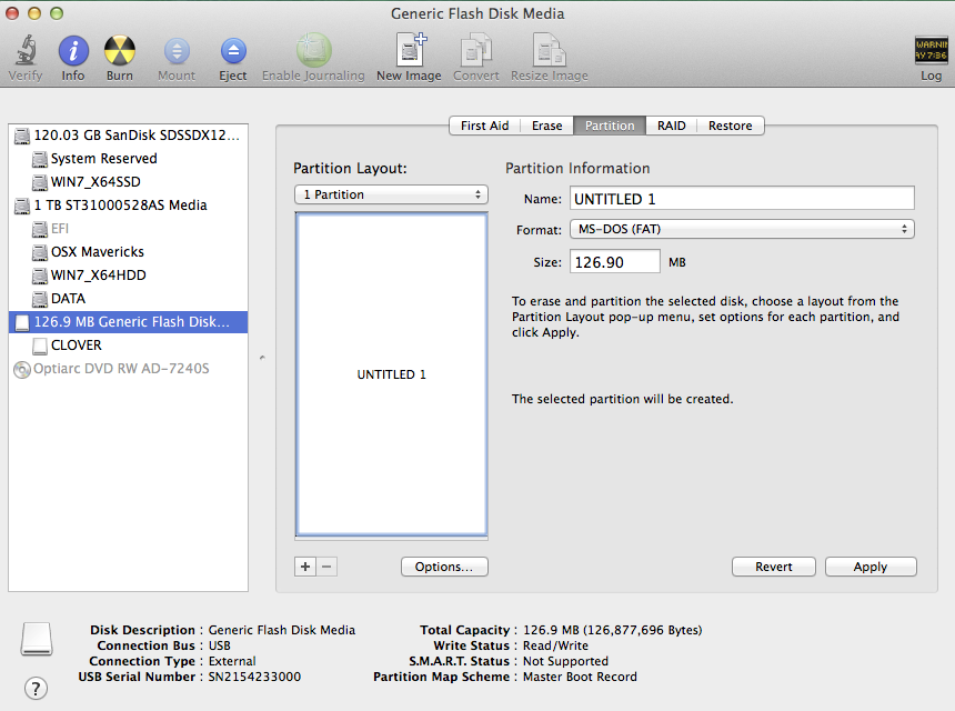

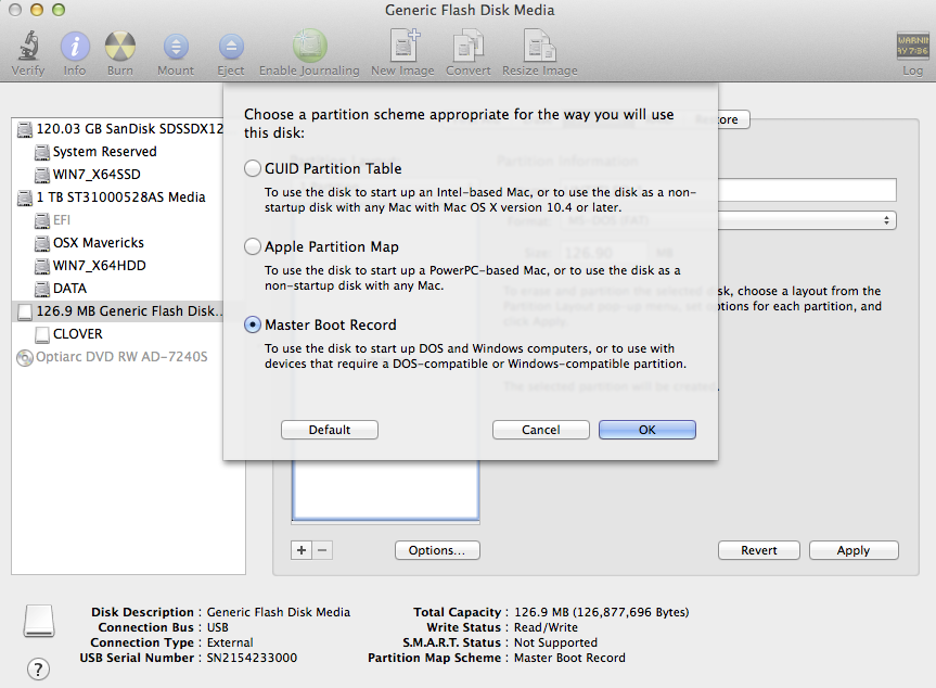

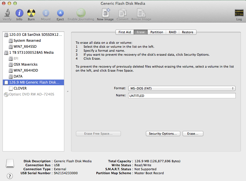

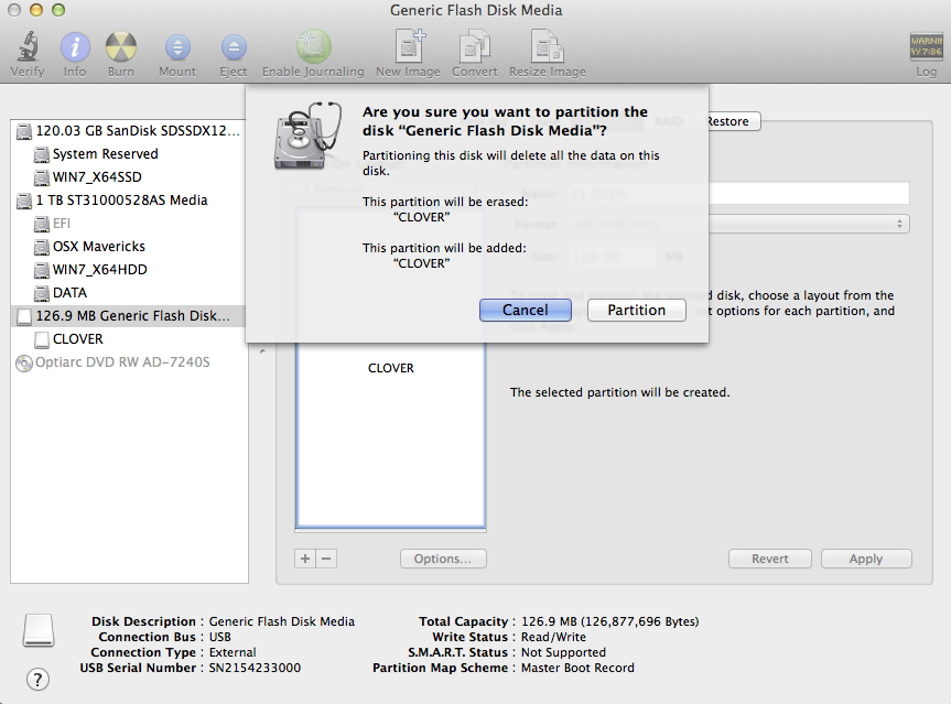

@mac09hack

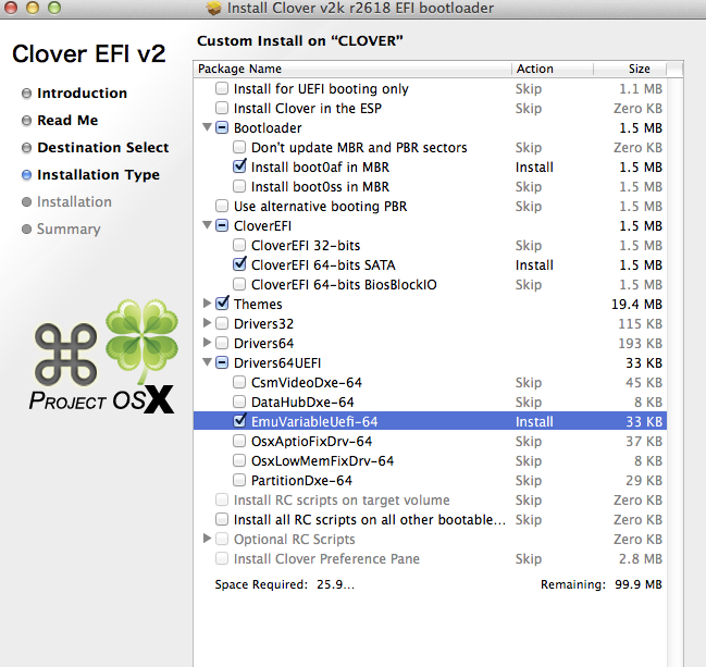

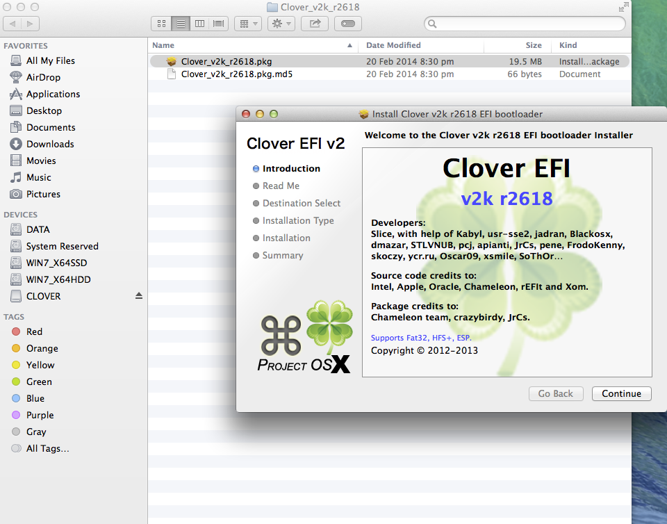

Make sure the EFI partition is unmounted and then run Clover_v2k_rxxxx.pkg targeting the HFS+ partition on the USB ie the partition "CLOVER" if following BatcOuntrY's guide.  Can you post the full output from Clover_Install_Log.txt?  If you try to run the installer while the EFI partition is mounted, you will get a failure message :wallbash: !!!

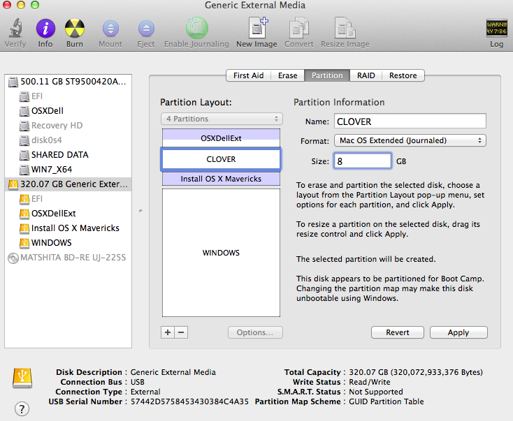

Step 1 Format the USB drive using GUID partition scheme.  NB Even though we are selecting to create 1 partition "CLOVER" only, in reality 2 are made (an EFI partition is automatically created when we choose GUID).
Attached File  Screen Shot 2014-01-11 at 11.27.02 am.png   158.38KB   28 downloads
Attached File  Screen Shot 2014-01-11 at 11.30.05 am.png   32.16KB   18 downloads
Step 2 in his guide is optional (no need to format the newly created EFI partition on the USB drive) - so no need to actually use terminal for the install.

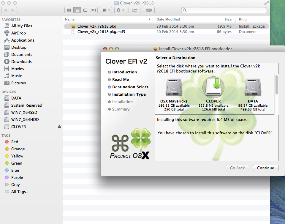

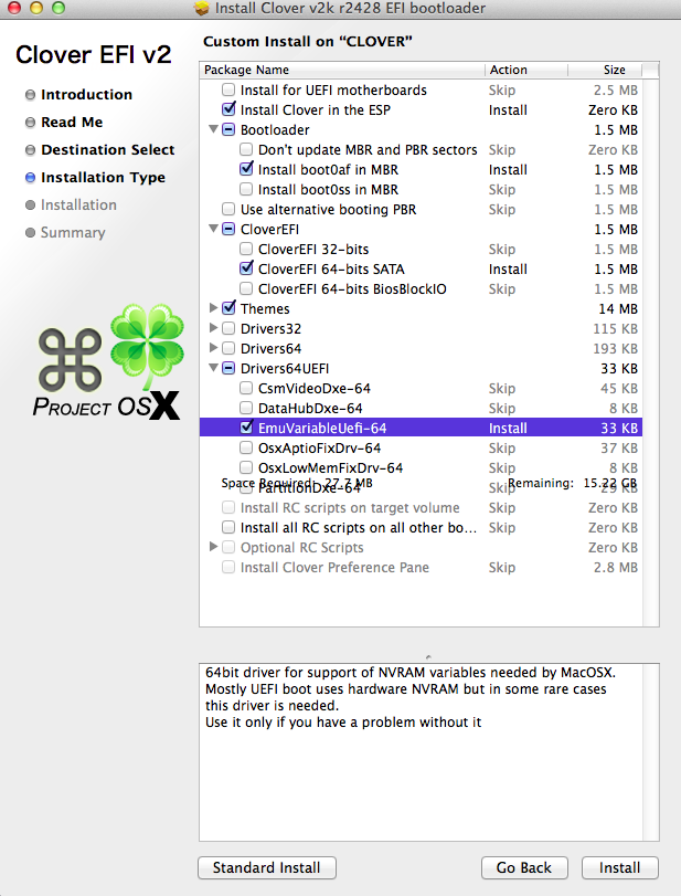

Step 3 Install Clover to the USB drive
Attached File  Screen Shot 2014-01-11 at 11.33.35 am.png   152.34KB   25 downloads
Attached File  Screen Shot 2014-01-11 at 11.35.35 am.png   150.33KB   26 downloads
Attached File  Screen Shot 2014-01-11 at 11.39.11 am.png   124.84KB   20 downloads
Output from Clover_Install_Log.txt

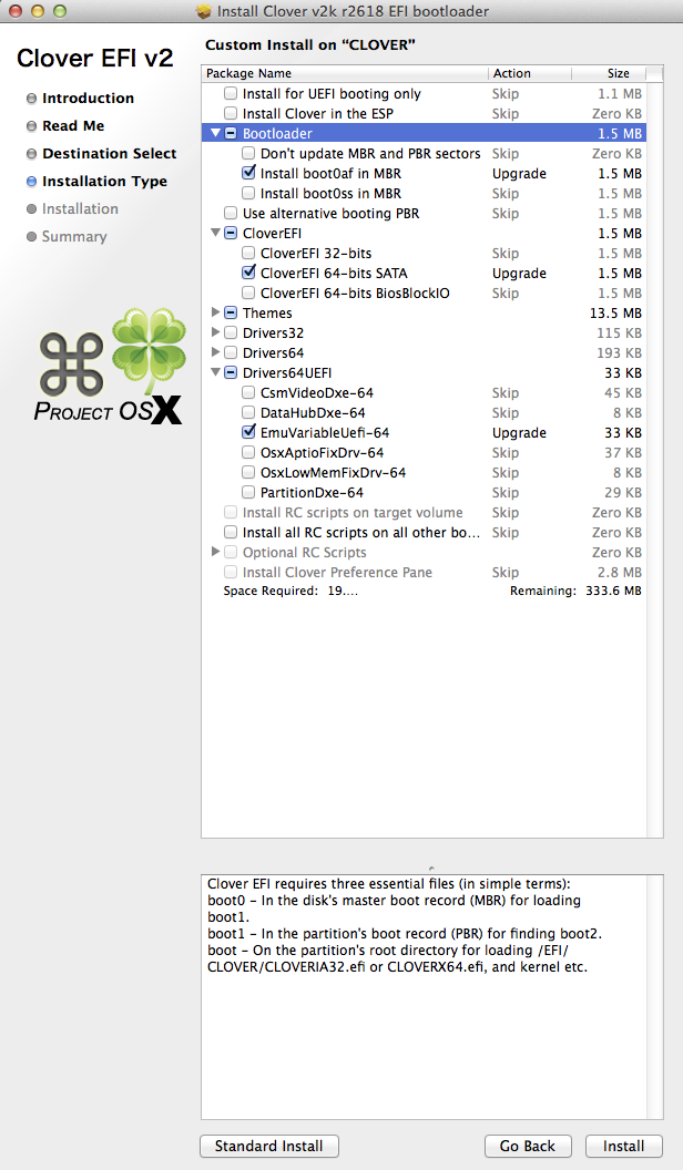

I'm having the exact same issue on the same OS, 10.6.8. I'm using an 8GB flash drive which I used on my first hackintosh years ago, with Chameleon installed in ESP. The point being, if it worked for Leopard, it should work for Mavericks.
To go over my exact steps (I used SkylineOSX's guide, which is largely derived from rockinron's Chameleon guide in addition to this thread):
1.) Format USB drive using Disk Utility, with GUID layout and 1 HFS partition
2.) Restore OS X Base System onto USB drive
3.) Rename USB drive label to something simple (i.e. "mav")
3.) Copy Packages folder from Install ESD into /System/Installation on USB drive
4.) Run Clover installer (latest I've tried is r2482, earliest is r2114), select USB drive with following options checked:
  • Install for UEFI booting only
  • One theme
  • All of Drivers64UEFI except for CsmVideoDxe

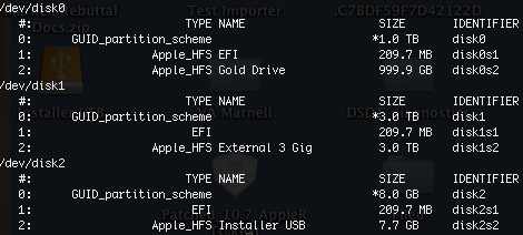

The install fails, with the log showing the output of diskutil list:
(truncated for formatting)
/dev/disk1
   #:                       TYPE NAME                    SIZE       IDENTIFIER
   0:      GUID_partition_scheme                        *8.0 GB     disk1
   1:                  Apple_HFS EFI                     209.7 MB   disk1s1
   2:                  Apple_HFS mav                     7.7 GB     disk1s2
Can't find volume with the name /Volumes/mav
I chuckled a bit when I first read this error log, since the script only needs to look up one line  :D
If I could figure out how to install Clover manually into ESP for UEFI booting, I'd be happy to install it myself. It can't be any worse than installing Chameleon manually, right?

There seems to be a compatibility issue with the Clover pkg installer and Snow Leopard that prevents installation into the EFI partition (?failure to mount EFI by the installer)  eg if you tick "Install in ESP", running the installer in OSX 10.6.8:
post-846696-0-74459000-1399708616_thumb.
post-846696-0-07825800-1399708651_thumb.
You get the following in Clover_Install_Log.txt
Clover EFI installer log - Sat May 10 17:26:31 EST 2014
Installer version: v2k r2652 EFI bootloader
/dev/disk2
   0:      GUID_partition_scheme                        *16.4 GB    disk2
   1:                        EFI                         209.7 MB   disk2s1
   2:                  Apple_HFS CLOVER                  16.1 GB    disk2s2
Can't find volume with the name /Volumes/CLOVER
You will have to either
  • Install Clover to the HFS+ partition rather than the ESP/EFI partition
  • install Clover manually see wiki on how to do this
  • upgrade to OSX 10.7+  and run the installer there

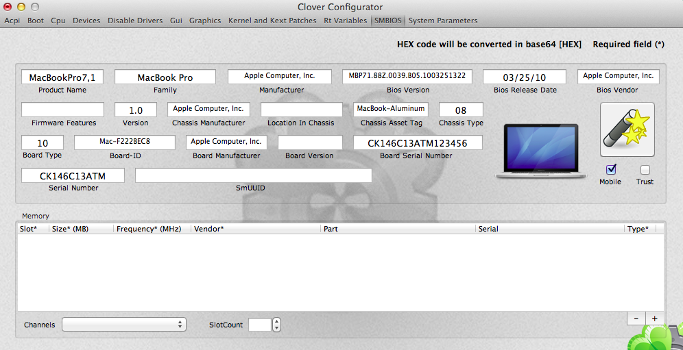

@Imothep77,
Pls read the Clover wiki re SMBIOS.

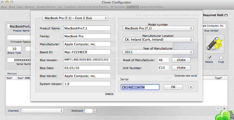

You can use Clover Configurator.app to help configure your Clover config.plist.  Open BatcOuntrY's sample config.plist and in the SMBIOS tab, click the magician's wand to choose a SMBIOS which most closely matches your hardware eg MBP 7,1 with core 2 duo processor.
Attached File  Screen Shot 2014-02-04 at 10.42.19 pm.png   231.54KB   7 downloads
Attached File  Screen Shot 2014-02-04 at 10.44.08 pm.png   286.87KB   7 downloads
You might like to try the sample config.plist below which enables ATI injection and the "Shrike" framebuffer for your 4670....

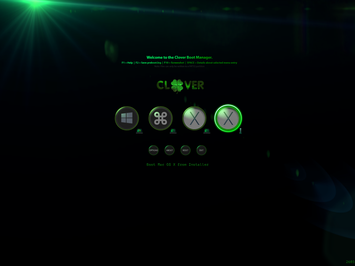

Used your config.plist ; I didn't copy my DSDT.aml into the EFI partition for now.
Booting from Clover with injected kexts is now working and I get the "Welcome" screen (at - oh my God - the correct resolution!!!) but I'm still unable to use neither my touchpad nor my keyboard. Will try to load a voodoo kext and see what it gives.

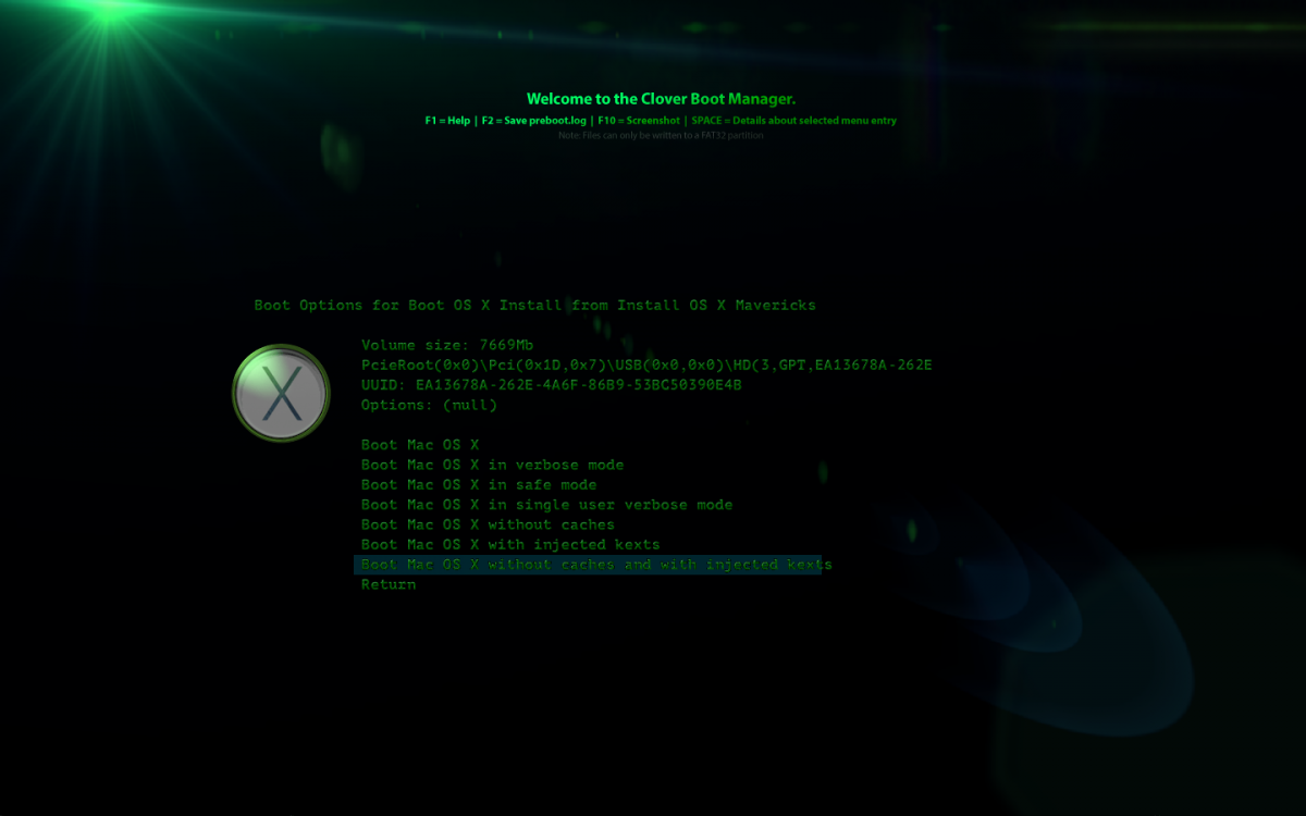

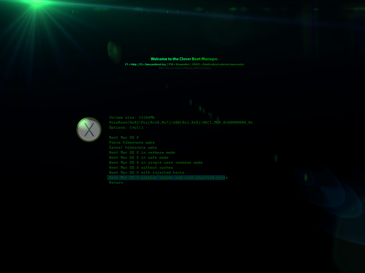

Hey...
Installed Clover to my laptop's HDD, was working fine but still I needed to hit space and then choose "boot without cache with kexts injected".
So I tried to continue and follow this guide:
http://www.insanelym...e-true-gpt-ssd/
I installed the kexts (same as the ones I had on my USB "EFI/Kexts/10.9/" directory) to S/L/E using KEXT Wizard
I also renamed my boot folder in my HDD EFI partition as suggested in the above guide.
Now when I boot from my HDD, I get an error at boot, Clover is not even loaded...
I tried to boot from the USB using the standard boot without cache with kexts injected but it freezes on an all grey screen until it displays some glinches...
I'm stuck now and trying to manually remove kexts from the HDD. and rename back my boot folder to "boot"... using the USB installer.
The problem was due the renamed boot folder - must have misunderstood the statement on the other guide.
I used the USB installer again (Terminal --> mounted the USB/EFI partition --> renamed to 'boot') and restarded.
NOW: Mavericks booting without even hitting a key!!
Will try to resolve my audio / WiFi issues now, if someone has ideas, please drop them here.
--EDIT
Still no luck with audio when everybody says it's working... :shock:
For me it is only able to play sound through one of my airplay compatible devices but not through the speakers ; no entry device detected either.
Sound now working!!! I just used Clover configurator to change my SMBIOS settings... to MacBookPro 5.5 (instead of 7.1)

I just tried the Clover method and it failed to install Clover. I have tried several methods and so far, non of them are working. Help from someone would be so much appreciated. Ready to pull my hair out and I don't have much of that left these days.....
I am wondering, which Clover boxes I can check and which boxes I should never check? If I don't click customize and I just install Clover, it installs. But, I can't start on that USB without a crash. I have tried Insanely Macs DD script (my old go to fav) and Tony M and MyH and Clover and now, clover here on this thread. I just cant get it to work ... why? Can anyone, PLEASE, be of any help here?
Looking at your hardware signature (I assume it is a GA-EX58 mobo) you should have no problems running Mavericks.  The fact that you have tried so many methods and failed suggests a faulty USB drive &/or operator error (note some USB drives can't boot) &/or BIOS incompatibility with booting GUID USB....
It is important if you don't fully understand what you are doing to follow the BatcOuntrY's guide EXACTLY (don't mix and match install methods).  Only tick the Clover install options as shown in post #22.  You DO need the customized options for this to work....
Attached File  Clover Install Options.png   150.33KB   7 downloads

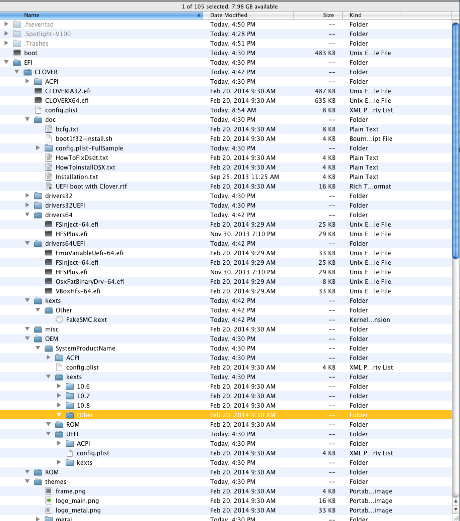

In the attached GAEX58.zip file
  1. config.plist--->put into EFI/CLOVER folder
  2. HFSPlus.efi--->put into EFI/CLOVER/drivers64 & EFI/CLOVER/drivers64UEFI
  3. FakeSMC.kext--->put into EFI/CLOVER/kexts/Other & delete 10.6-10.9 folders*
* removing /EFI/kexts/<version> subfolders will allow you to inject FakeSMC.kext from /EFI/kexts/Other for all OSX versions.
With my provided config.plist, you will not need a DSDT/SSDT since it utilizes Clover's ability to patch the native DSDT in BIOS and generate P&C states to enable speed step.

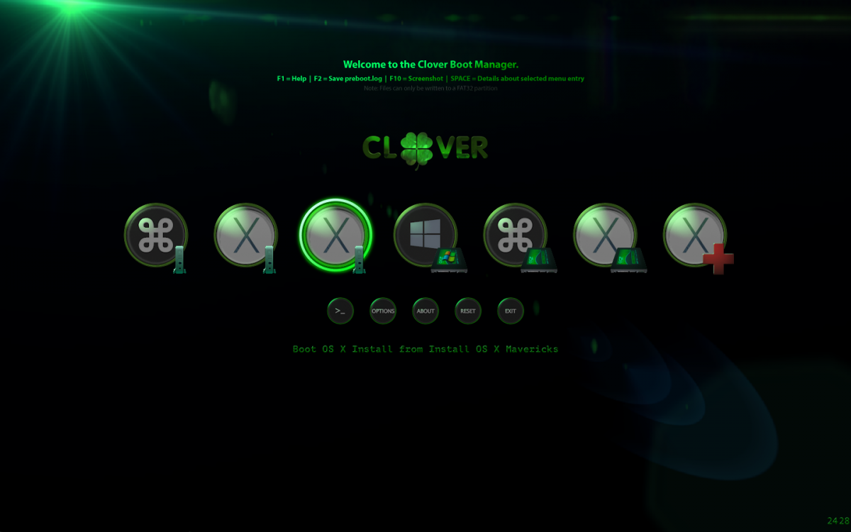

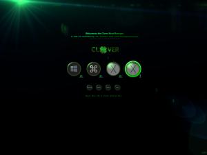

  • Press <F12> to access your boot menu as your computer POSTs and choose your USB stick (sometimes listed as USB-HD) to boot it
  • At the Clover Main Menu you should see....
Attached File  Clover Main Menu.png   279.23KB   4 downloads
To install Mavericks (step 6 of BatcOuntrY's guide), select Boot OS X install from Install OS X Mavericks and hit the spacebar....
then from the menu choose Boot Mac OS X with injected kexts and hit enter.
Attached File  Install OS X Mavericks.png   233.73KB   1 downloads

@ZoroLives,
An alternative to using a USB is to create an 8GB installer partition on a spare GUID partitioned hard drive (can be external USB) named "CLOVER" using disk utility....
format the partition as HFS+.....
and follow the same directions from BatcOuntrY's guide (substituting any references to the USB with the name of your installer partition).
After installing the Clover bootloader into the hard drive's EFI partition, you can then boot the Mavericks installer from the installer partition.
Edit
It is easier to create an installer partition on your working HD if your existing partitions are HFS+
Attached File  Create 8GB Installer Partition.png   134.93KB   2 downloads
I recommended a spare HD since installing Clover to your working HD will overwrite your existing chameleon settings......if you do something wrong, you may not be able to boot.......safety first: - get a spare hard drive for backups and experimentation :).
