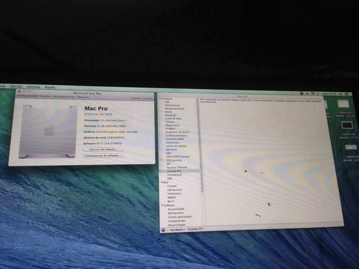

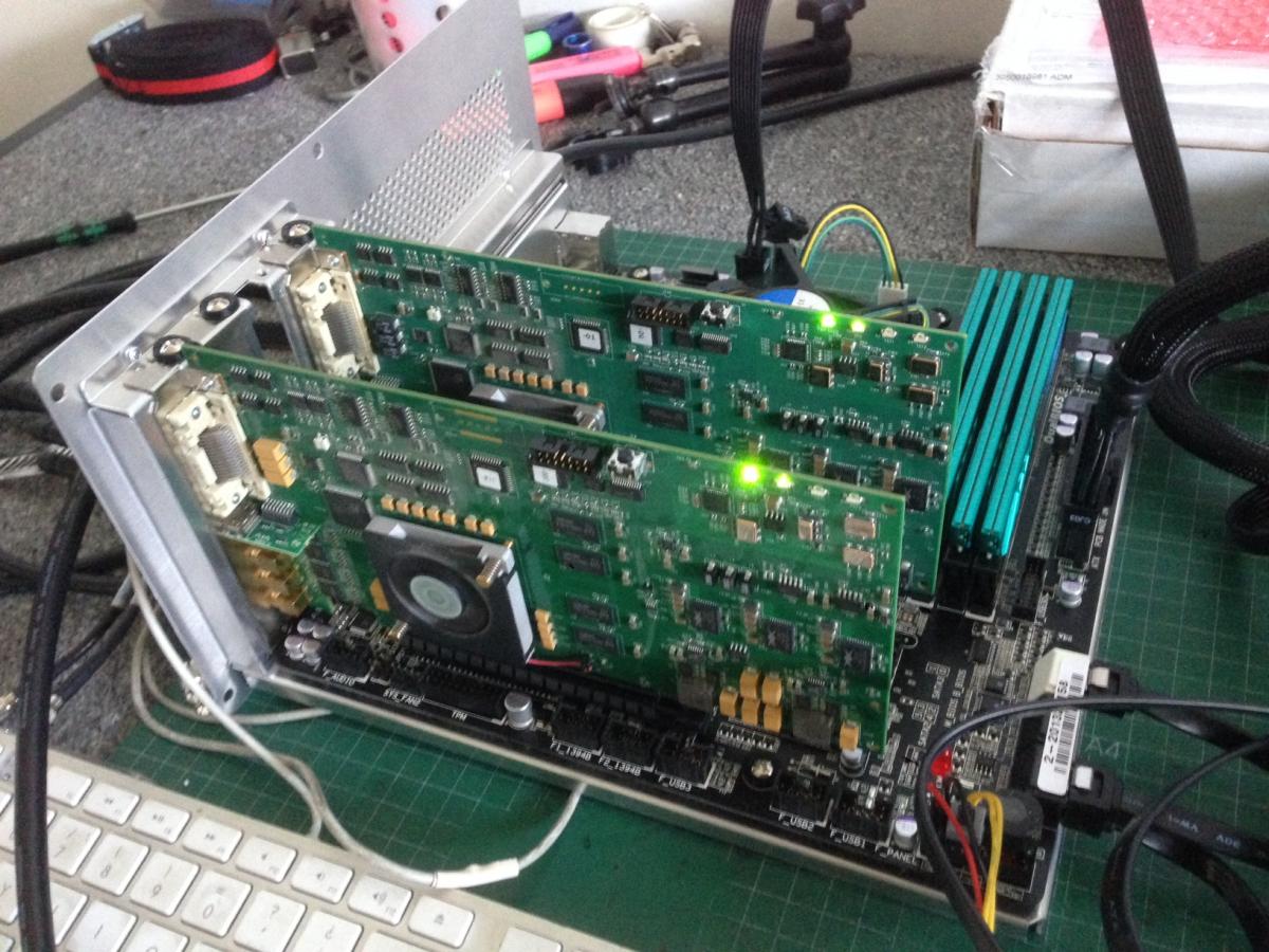

Has anyone been able to connect to another mac pro w/this motherboard using back to my mac?  Interestingly enough I can connect to both of my mac pros from actual laptops.  I just can't have them connect directly to each other. (Note: I did change the serial number of both, but not the baseboard serial number)
My system works without any problem with both graphics card I've got and without them (HD4000) and wifi (Dlink 556) but I find a strange behaviour in PCI.
I've tried to use 2 Kona 3G cards in the 2 16x slots and I've lost every PCIe cards, Kona's are 4x cards.
I can use the Sapphire+Dlink+ one Kona 3G and everything works fine.
I can use the 680+Dlink+one Kona 3G and everything works fine.
I can use the HD4000+Dlink+ one Kona 3G either in Slot 1 or in Slot 2 and everything works fine.
but
If I plug 2 Kona 3G and the Dlink the system doesn't recognize any PCI card (I lose the wifi also), anyone knows why? I've tried the (few) possible settings for PCI and nothing change. I've tried also without the Dlink with the same result.
You didn't specified the position of the setup.
Before we begin you should know the correct slot count, Slot 1 is the slot close to CPU and Slot 4 the farest.
So IMHO, to use 2 of them, you need to use onboard HD4000 and put one card in Slot 1 and second in Slot 4.
Do not use yet PCIe x1 slots and tell me if the system works with those 2.
My bad, cards are in slot 1 & 4 with the Dlink556 in slot 3. I attach some pics. In this configuration is not working.
