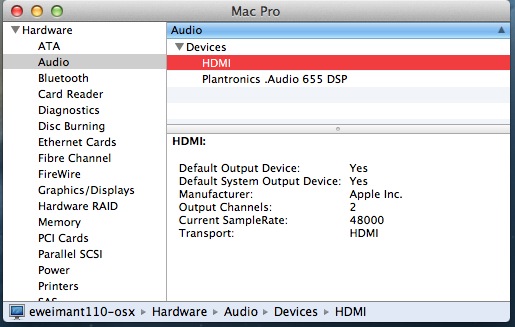

WOW!!! Finally got HDMI audio working !!! :king:
Actual problem was on my framebuffer. So with corrected framebuffer the process might work :afro:
Thank you very much Lord Kamina :euro: for easy & simple guide and your co-operation.

AppleHDA.kext/Contents/Plugins/AppleHDAController.kext/Contents/Info.plist
Corrected path ^^
Grabbed my dev id via lspci
osx:~ ludacriscp$ lspci |grep Audio
01:00.1 Audio device: ATI Technologies Inc Unknown device aa58
Changed mine to this:
<key>IOClass</key>
<string>AppleHDAController</string>
<key>IOPCIPrimaryMatch/key>
<string>0xaa581002</string>
<key>IOProviderClass</key>
<string>IOPCIDevice</string>
Then I added this to my DSDT:

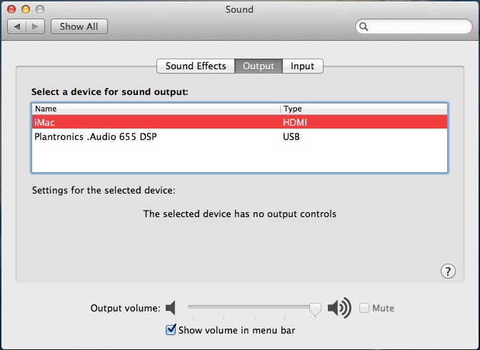

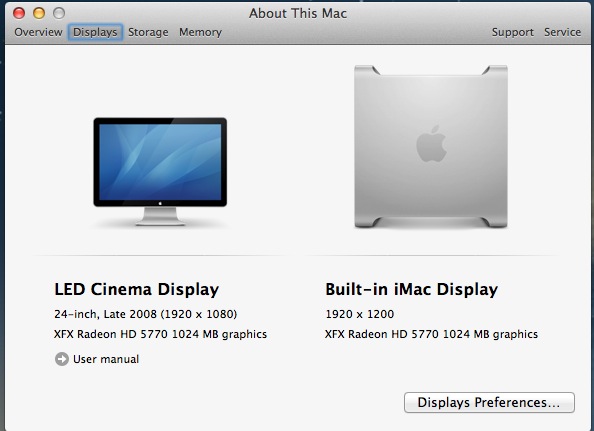

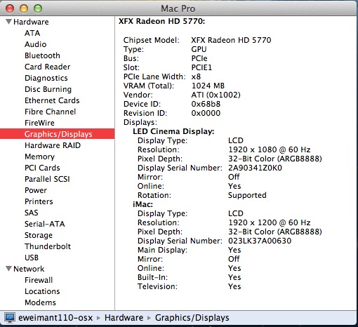

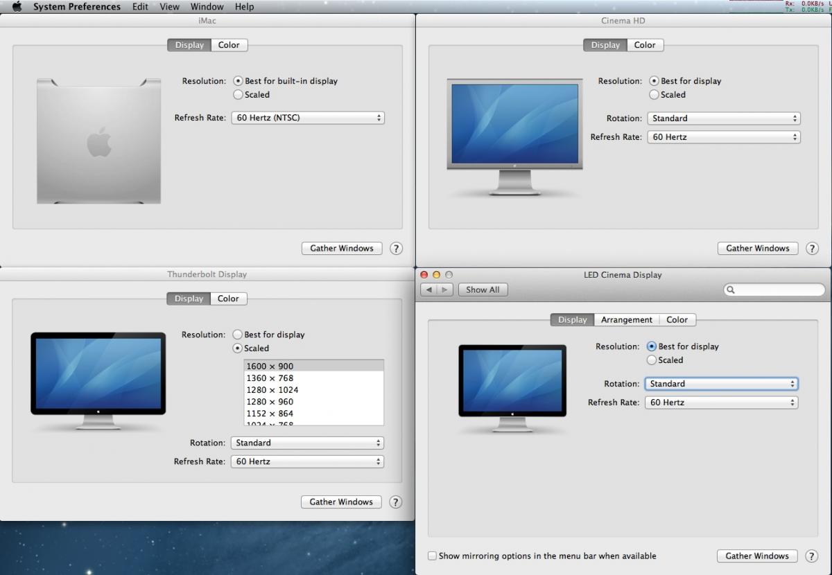

At this same time I changed how my main HDMI display is reported.
The 'MacPro' that I'm using (Dell) I have a Hanns-G 28" HDMI display 1920x1200 that I have the Mac thinking is an iMac.
I used FixEDID http://www.insanelymac.com/forum/topic/290130-fixedid-v19-application-to-generate-overrides-automatically-for-apple-displays/?p=1927455
Along with DarwinDumper http://www.insanelymac.com/forum/topic/282794-darwindumper/?p=1852685
To make the displays what I wanted them to be.
