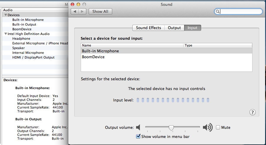

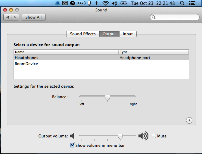

Checked........
No input/output, Also not working Headphone.
No entry on system preference :( .

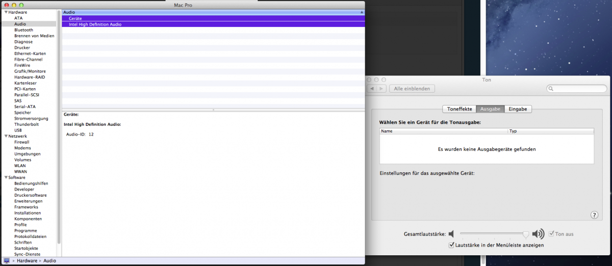

should look good on pinconfig, verbs' speaker, to identify better.
Seen from your previous picture, speaker icon show up, but transparent ...
seem a sign that the speaker is not on the correct node (but the rest is fine).
If you want you can try to change Platforms.xml.zlib, the node 19 to 20 and try again.

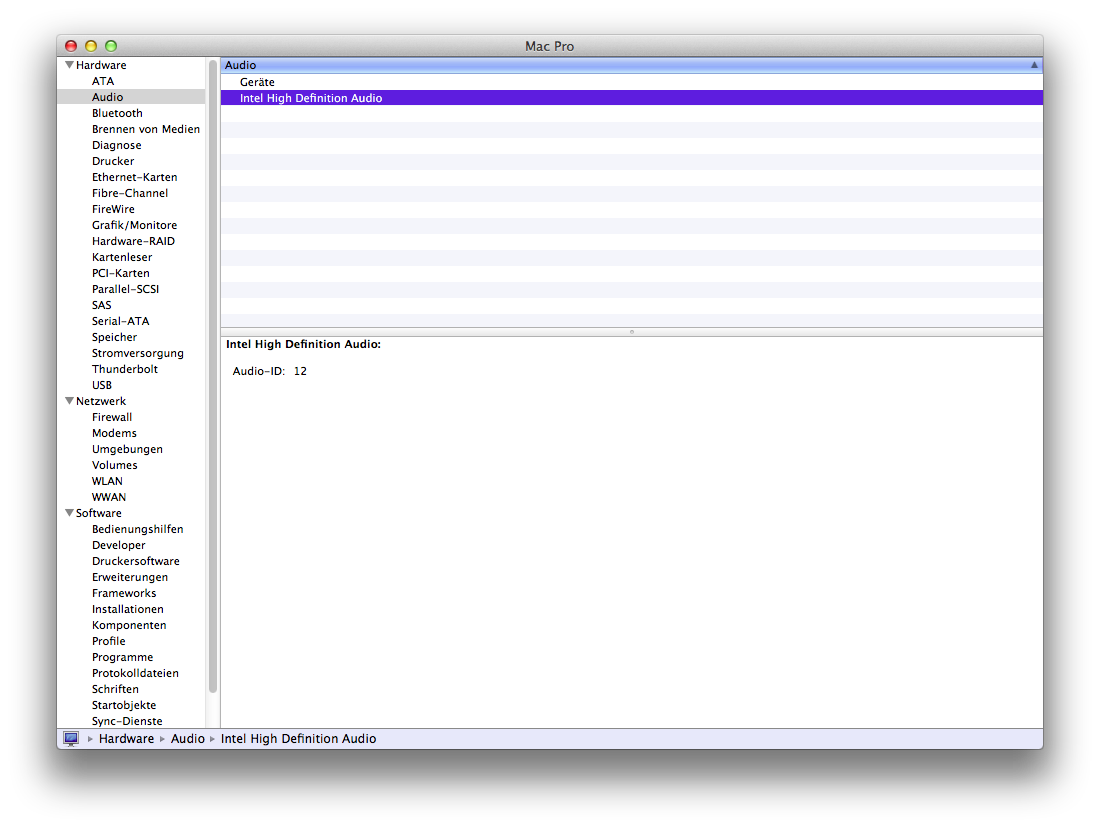

Sorry for your audio codec, I wanted to give it a try, but unfortunately it is very difficult from a distance.
Only "layout 12" show up in System Profiler, may not be good ... the layout12.xml (or binary patch...mmmh)

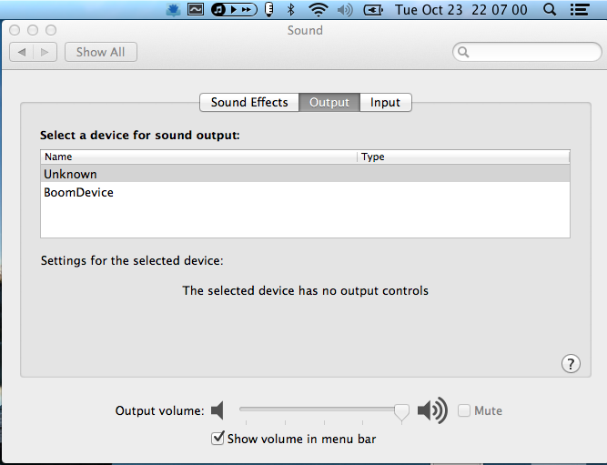

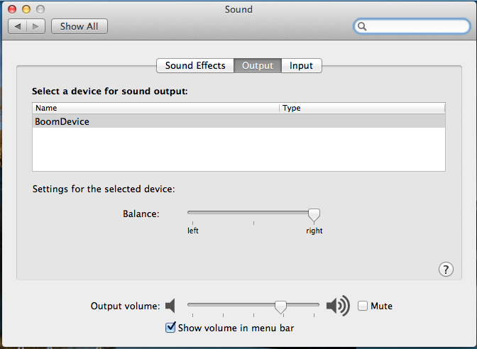

Both of kexts same results. No sound at all !!!!
in/out, headphones none.

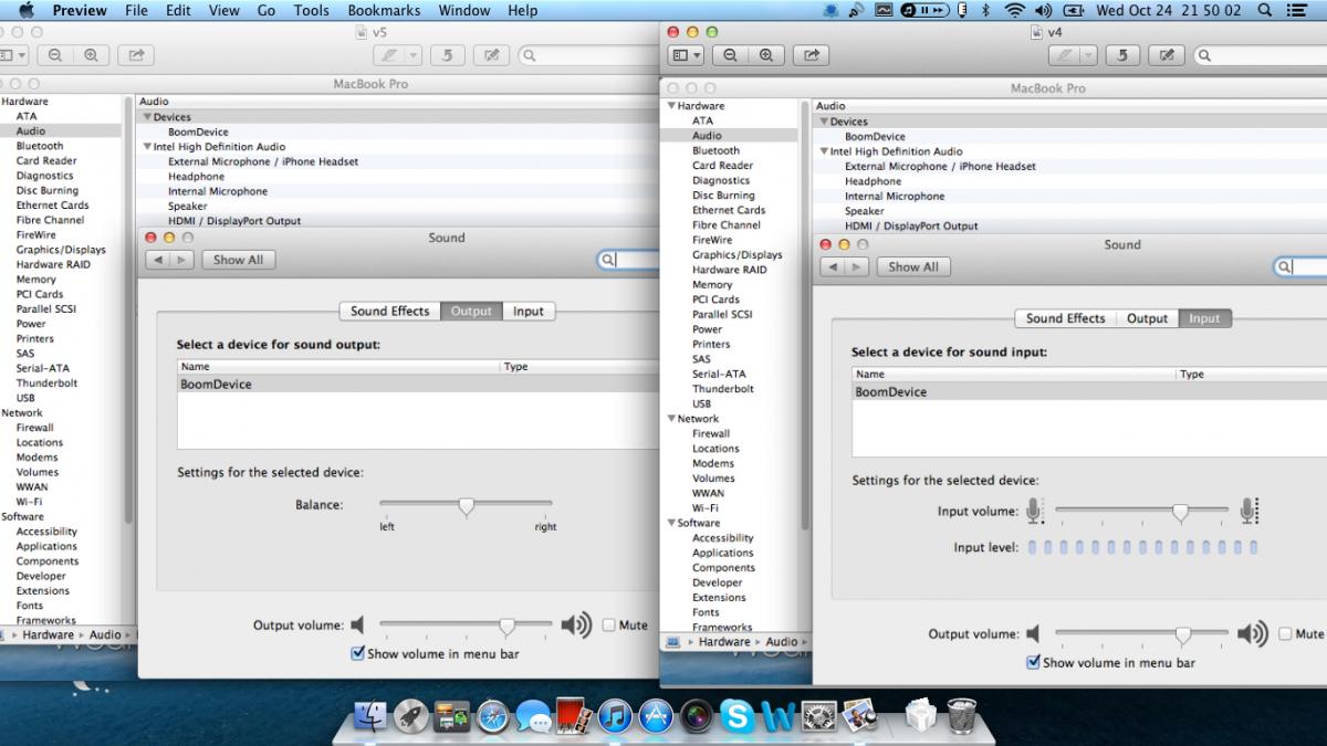

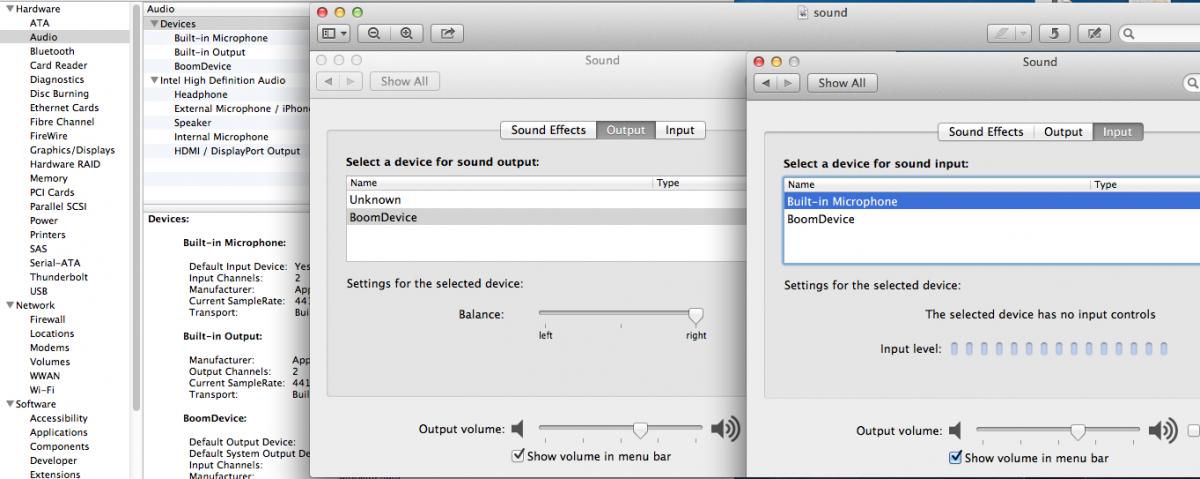

Edit: I can confirm you that your previous kexts (AppleHDA v1 + v2) for 10.7.4 works on my 10.8.2, but no input/mic.
:hysterical: Really?
then I can not understand why :hysterical:.....edit are the same of 1° kext tryed! (mmmh... v1 and v2 for 10.7.4 have different pinconfig for sure....I don't remember if are really..... for the 1° you tryed)
For Mic depends from pathmap into Platforms.xml (is not compressed in lion kext), so now you can try to change it. :wink2:
