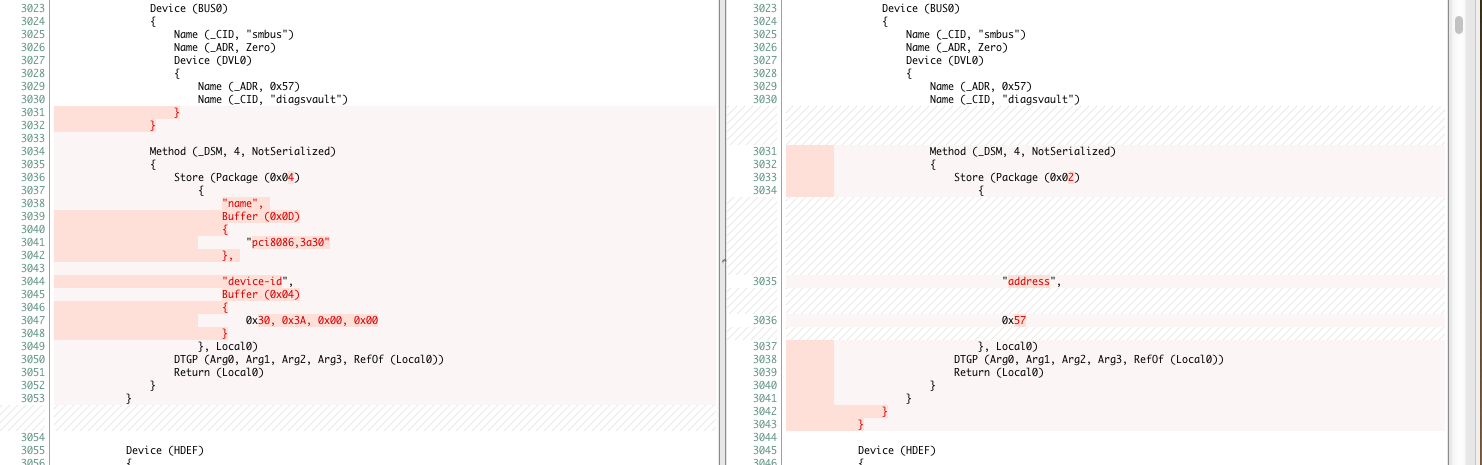

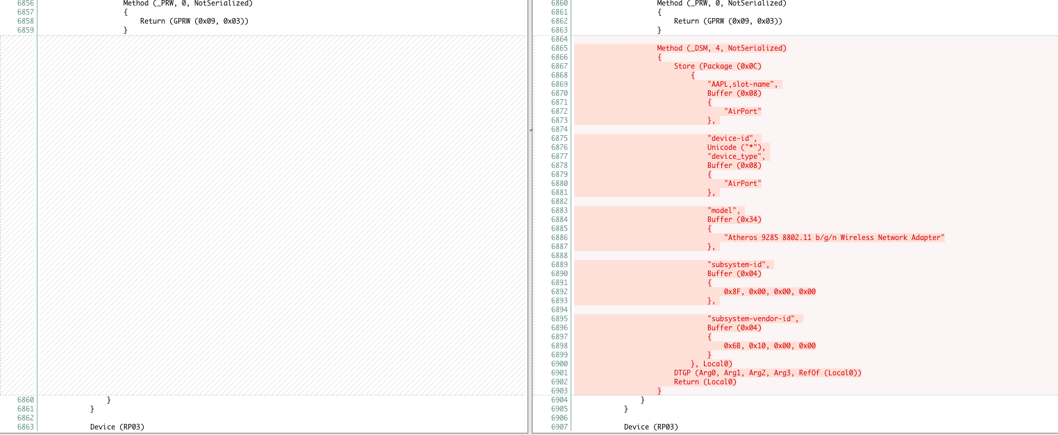

I am curious about a couple of the fixes. The Wifi looks goo but I am concerned about the Bus0 and OSI Darwin fixes:
Left Side isJeffC2009 original MaLdons patch and right side the newest MaLd0n patch you attached:
WIFI fix is for the Atheros is that the default Wifi card but looks fine:
BUS0 fix looks weird:
Not sure why there is address change for _OSI Darwin:

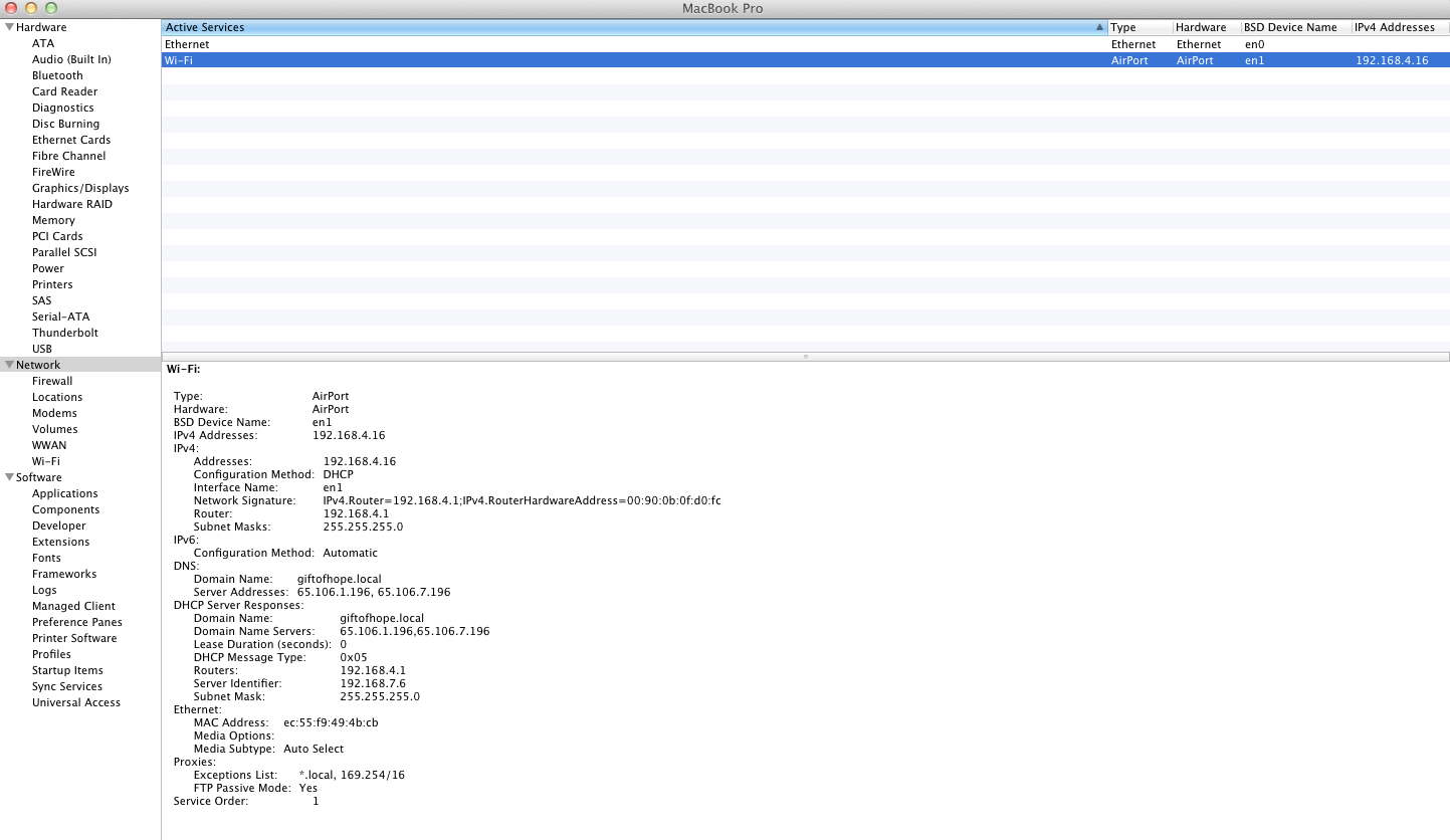

post screenshot SystemInfo/Devices too
MaLd0n, thanks for your help again!!! New dsdt works great without any kp. But I am still getting no locale

AR9285 FIX has a devicemergenub to fix that by andy vand
the unicode * means whoever was building the dsdt had atheros 2A device in the pc . so it says "hey * since its there already"
darwin code if Lequal Greater osid 07d6 it enables other features.
in your dell laptop set osid to make it think its vista 07d6 for Darwin then run screen display of brightness level. when changing it fn ^ or fn Down. but if the number is greater then it doesnt show the lil sun graphics. but if its 0x7d6 it shows on screen ( and what else would it enable ? power management ?)
EDIT:
bus0 .. its no need to add device id for mac pro ich10 if id of mobo is supported
