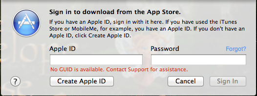

I have Mac OS X Lion Developer Preview 2 installed.
When opening the App Store and attempting to Sign In through the Store menu, the system responds with the message "No GUID is available. Contact Support for assistance." in red font.
Can anyone help me with this issue, please? I'll really appreciate it :)
Screen shot enclosed.

I had this problem as well,
getting "no guid is available contact support for assistance" when i try to sign in.
Solution:
remove the file
/Library/Preferences/SystemConfiguration/NetworkInterfaces.plist
then reboot.
This seems to be a network problem. I had to networks cards installed, one on board and the second one as a pci card.
The onboard network controller was assigned on en1, the pci card on en0. In fact I used the onboard controller on en1 as it support a 1000baseT connection. To solve this I
1. Plugged of the pci network card
2. Restart
3. I deleted the interfaces in System Preferences
4. I deleted NetworkInterfaces.plist in /System/Preferences/SystemConfiguration
5. Restart
6. Add the onboard controller as en0
7. Voilà: AppStore works
As I don't need the pci network controller (was for mere installation necessities as the onboard controller needs special kext driver) I didn't reinstall the card but I guess it's save to do it as it would be configured on en1 now.

I had this problem today, after updating my system to 10.6.8
I solved it by injecting extra ethernet EFI code in "com.apple.Boot.plist" using EFI Studio.
Hope this helps other ppl.

if none of them work for you, try this.  This solution worked for me.
I went into my com.apple.Boot.plist in /Extra/
and added this key
<key>EthernetBuiltIn</key>
<string>Yes</string>
Then I deleted my network interfaces in Network System Prefs,
THEN deleted my .plist file in /Library/Preferences/SystemConfiguration/NetworkInterfaces.plist
THEN i rebooted.  and when I came back to LION I went into System Prefs / Networking and clicked the (+) and added my card.
what was different this time was it added "Ethernet" as "Ethernet"  where before it was adding it at "Ethernet Device (en0)"
So i knew something had changed...   sure enough, i run app store and BOOM! connected and able to download and purchase software.
Fixed it for me too with no glitches and the second monitor working fine (Thanks MaLd0n!).

Thanks Paulo & ZURIE... your fixed work for me too ;)
And just a quick note for all of you who are struggling too, I initially after the update did all that deleting the Network Interfaces in Network Prefs/deleted the NetworkPreferences.plist stuff & rebooting & then re-added the Network Interfaces stuff but none of it worked ! So then I tried what Paulo said of just adding EthernetBuiltIn to my com.apple.Boot.plist in /Extra/ & it worked straightaway !!
BUT as an afterthought, I then decided to restore a backup that I had made just BEFORE updating to 10.6.8, and again ran the update & when that was all finished I just made the changes to com.apple.Boot.plist WITHOUT having to do ANY of that deleting Network Interfaces/NetworkPreferences.plist stuff, and it worked straightaway !!
So for me & hopefully others, I proved that you just have to make the changes to the Boot.plist and the AppStore should work again !!
