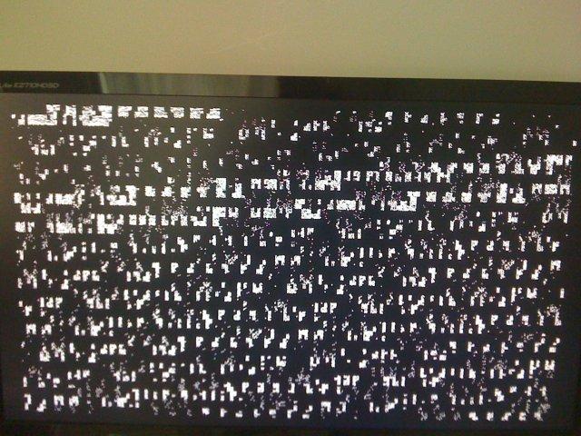

Thanx mucha for the great guide.
I got all resolutions and QE/CI on my laptop with HD4650 [9480:1002].
I've modded a shrike personality with
02 00 00 00 40 00 00 00 09 01 00 00 12 01 00 07
10 00 00 00 10 00 00 00 00 01 00 00 00 10 01 06
00 08 00 00 00 02 00 00 00 01 00 00 20 01 02 01
But I still have a problem with internal monitor. I can see desktop and mouse, but desktop has a lot of vertical lines.
It looks like 1 line is normal the next one is corrupted.
Maybe someone knows how to solve this issue?
I'm using 10.6.6 SL with original ATI kexts.
Laptop: hp pavilion dv7 2130ef
CPU: Intel Q9000
Ram: 4GB
Video: ati radeon hd4650

The only difference is
02 00 00 00 40 00 00 00 09 01 00 00 12 [color="#FF0000"]00[/color] 00 07
and I have 01, but it does not matter because I have this issue both with 00 and 01.
The strange is that screenshots are normal. Here is a sample.
dv7 has native resolution 1600x900. maybe this cause a problem.
#257
Misha Vakulich
Misha Vakulich
    InsanelyMac Protégé
  • Members
  • Pip
  • 9 posts
finally it works
changed the Shrike personality to
02 00 00 00 40 00 00 00 09 01 00 00 02 02 00 07
and fixed the issue with monitor according this guides
http://www.insanelym...howtopic=208410
http://www.insanelym...p;#entry1362685
Now I have 1600x900 with full qe/ci on my internal display.
laptop: hp dv7 2130 with ATI HD4650 [1002:9480]
#258
