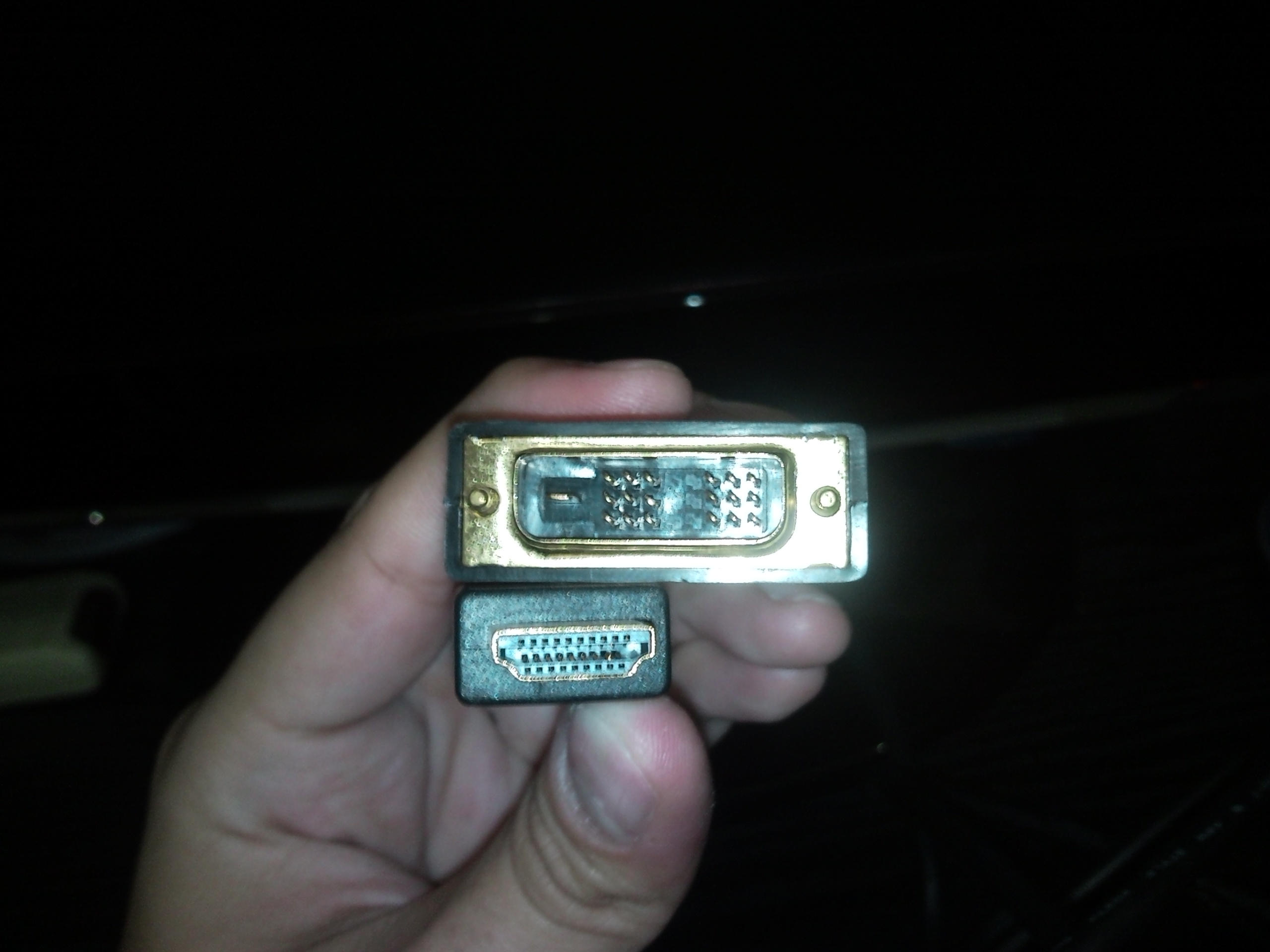

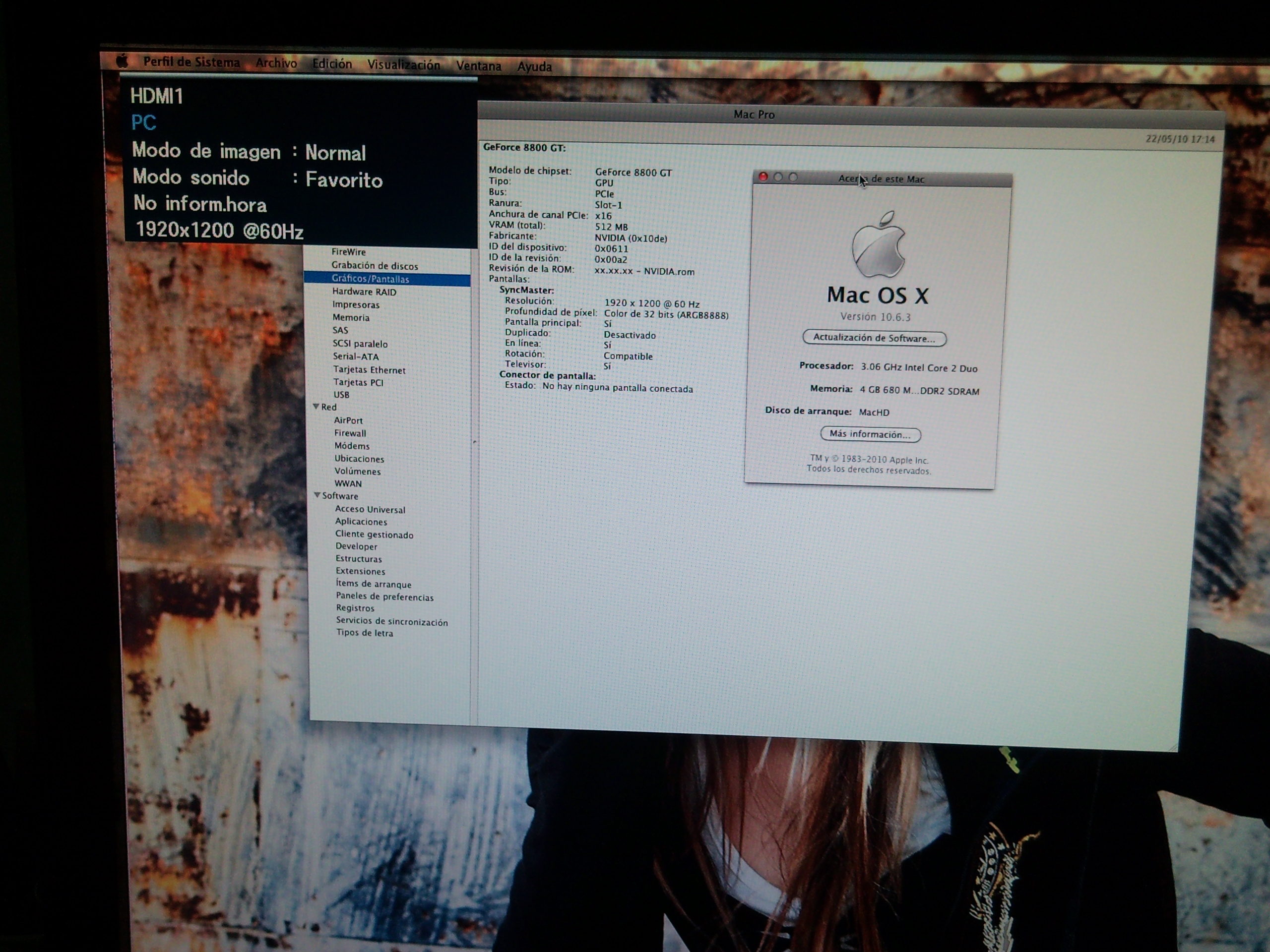

Umm...I just plugged a DVI adapter into my tv and used a dvi cable! Didn't need to buy a new card or any bullcrap like that. Still got digital too so bam.
#60
Posted 12 May 2010 - 08:21 PM
Jammol: Just to verify:you were having this problem before using the adapter, and now you're not?
