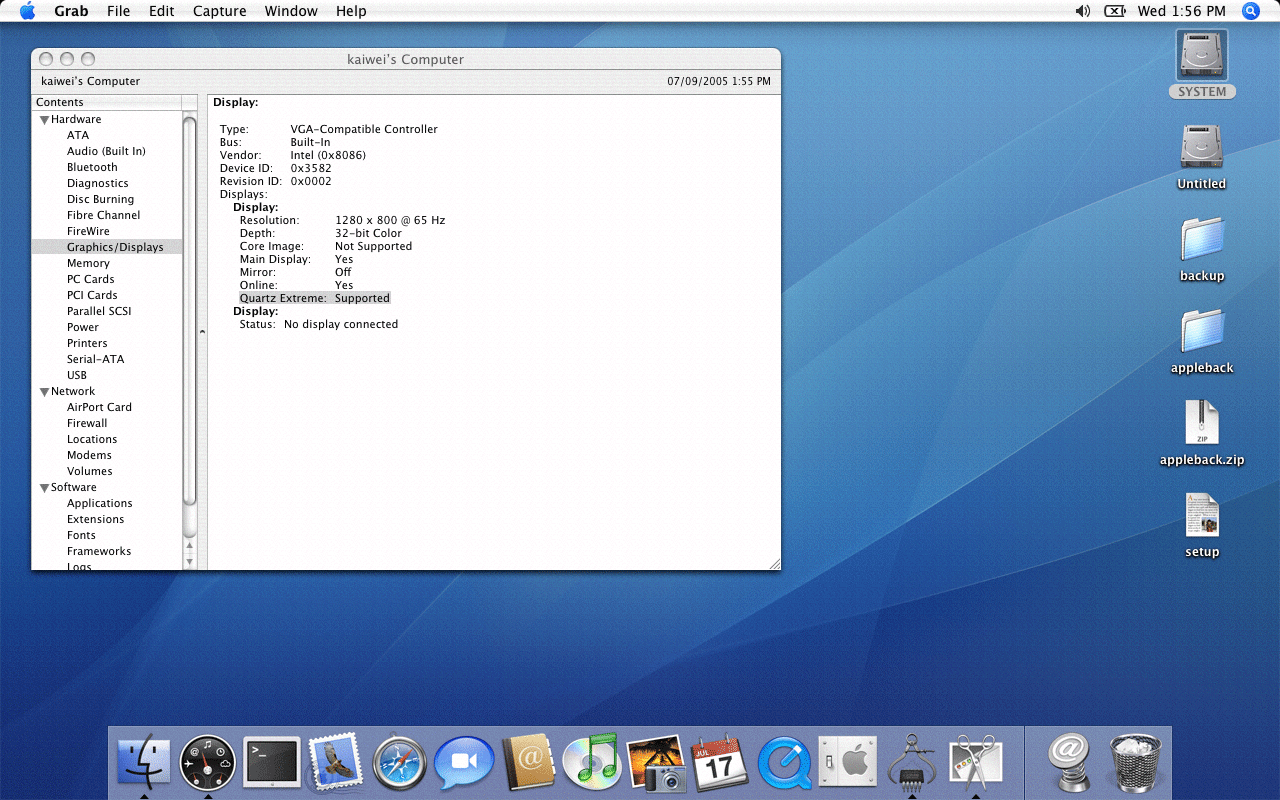

YUP. Got it working on my Dell 700M under 855 with your files. The only thing I did was to change the plist.info to 3582 in the AppleIntelIntegrated.kext
THANKS! Eveything seems snappier now.

What I did was to edit the plist.info in AppleIntelIntegratred.kext to match my device ID as stated in many threads here on the board. That's all. I can get QE only if i boot into windows first then start OS X. Sigh.
