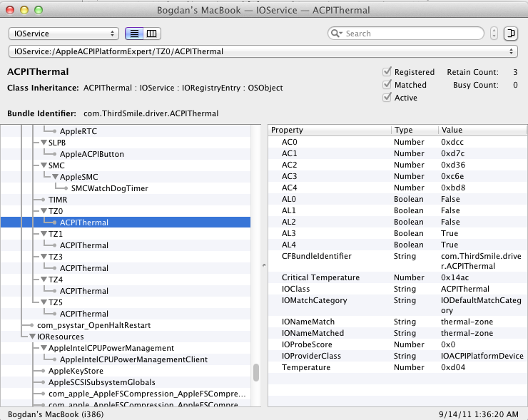

It didnt work. With the dsdt you edited the fan doesnt go on.
Here both IOREG:
Archive.zip
Here both IOREG:

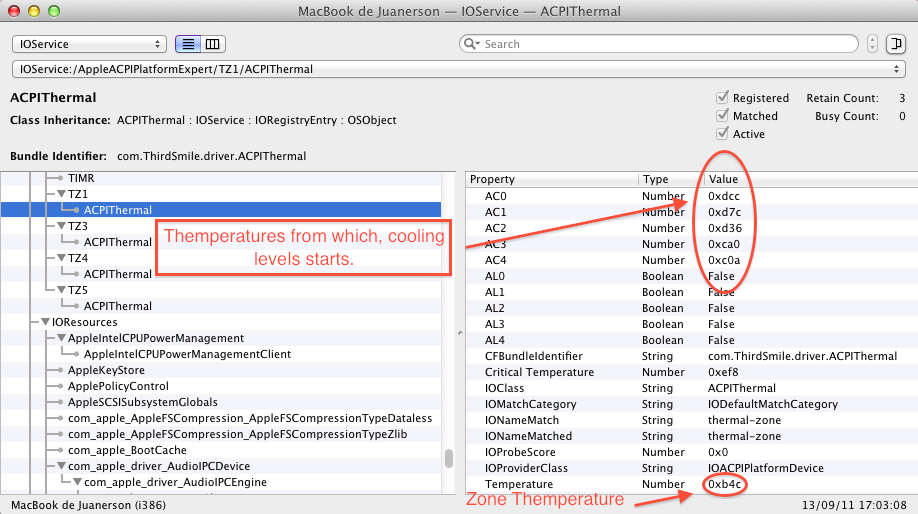

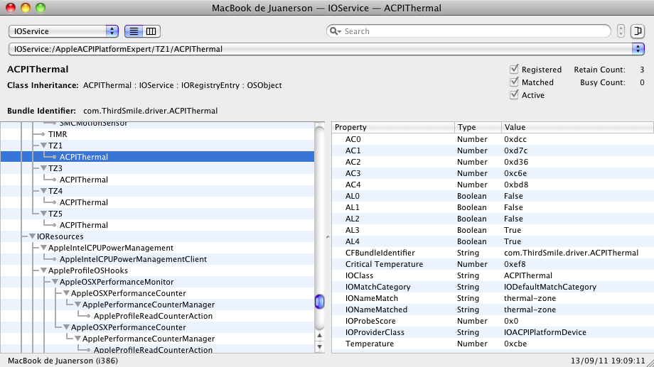

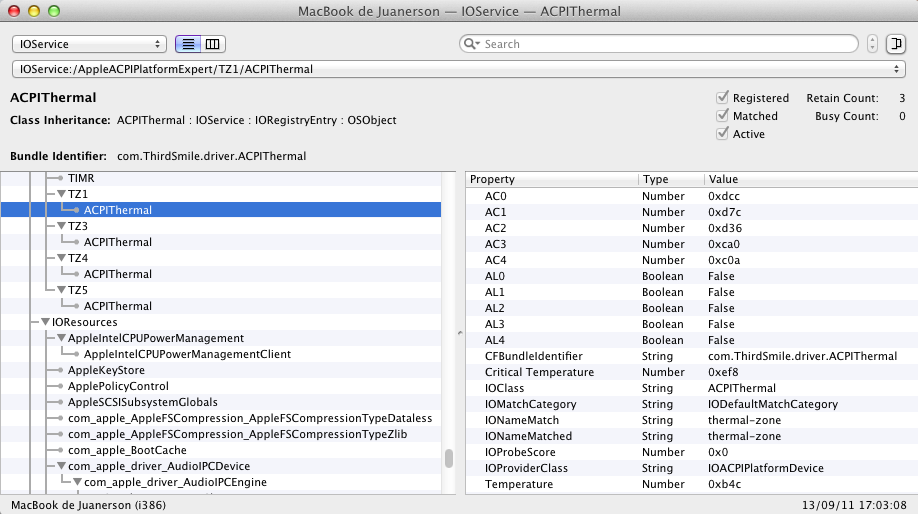

About first IOReg - _ACx methods failed(returned 0, so fan go to max speed) because of incorrect zones definition from different cpu.
About second IOReg
_ACx methods in TZ1 works correctly, but Temperature(returned from _TMP method) in zone is lower than first active cooling temperature - so fan runs at lowest speed (20%). Try to load cpu more, and if no change in temperature - than something incorrect in _TMP method(but i did know how - if AppleACPIThermal works, than it is correct).
Sorry. Same result as BlackCH here on Lion, not working because all ALx (0,1,2,3,4) show "False" in ioreg section TZ1. Instead of at least AL3 and AL4 should be "True"... IMHO that's the expected behavior, like AppleACPIThermal on Snow.

No, they can not be enabled because zone temperature(returned by _TMP method in TZ1) is to low.
For example my system:
Main problem why AppleACPIThermal not works is: _AL0 methods returns NULL when trying to evaluate them in driver - but they must return not empty list of devices.
I think that bug is in _TMP method in TZ1(seams that it returns not correct temperature).
