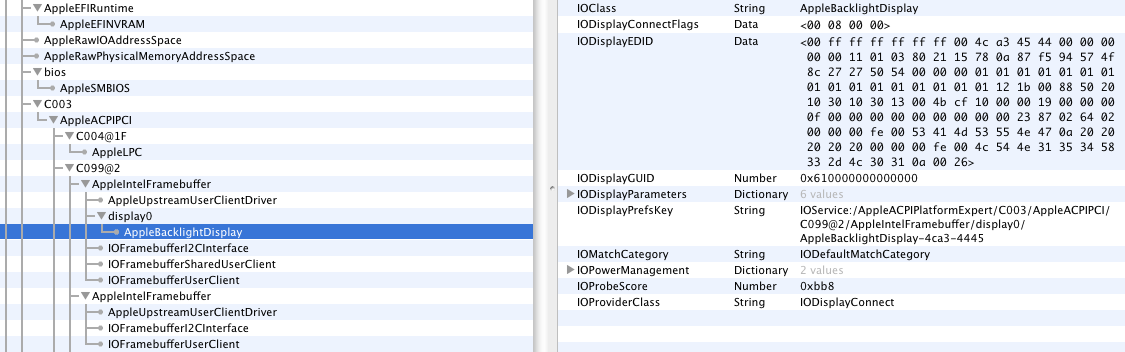

EDIT: Something that i've seen is that on mac dsdt's they inject EDID values while we don't (i guess). You can obtain your EDID values by using SwitchResX, selecting (in my case Unkown Monitor) and clicking on export EDID values.
Just look at this:

This shows that the part is a mate display (look at google). I'll try to inject the EDID values directly into DSDT, so that OS X recognizes my display correctly and so it does with the values that AppleIntelIntegratedFramebuffer asks for, as that post from projectosx said. (Thanks juanerson for pointing to it).
Please note that this is a potential way to solve our brightness issue but note that it will be different for each display. Just make sure the EDID is the same before copying the code.
BTW: Anyone knows how to post on projectosx.com? I've not managed to post there, it keeps saying i do not have enough privs.
EDIT: I added some values that were posted on the post juanerson said, no luck. Then i decided to start going value by value. Now i'm editing this post i've seen that adding EDID makes at least LCD values correctly.

I recommend everybody to add their EDID to their DSDT.

Then, How obtain and add my EDID and were exactly place it? One code example or link procedure-example? Please.

Este es el archivo que me da el SwitchXRes cuando exporto el EDID, como puedes ver ya te da exactamente los valores que tienes que poner en la dsdt.

     0  1  2  3  4  5  6  7  8  9  A  B  C  D  E  F
0  | 00 FF FF FF FF FF FF 00 32 0C 00 D6 00 00 00 00
1  | 00 10 01 03 80 21 15 78 0A B3 40 99 59 53 8D 27
2  | 25 50 54 00 00 00 01 01 01 01 01 01 01 01 01 01
3  | 01 01 01 01 01 01 BC 1B 00 A0 50 20 17 30 30 20
4  | 36 00 4B CF 10 00 00 19 00 00 00 00 00 00 00 00
5  | 00 00 00 00 00 00 00 00 00 00 00 00 00 FE 00 4C
6  | 47 50 68 69 6C 69 70 73 4C 43 44 0A 00 00 00 FE
7  | 00 4C 50 31 35 34 57 58 34 2D 54 4C 41 31 00 4D
<  00FFFFFF FFFFFF00 320C00D6 00000000 00100103 80211578 0AB34099 59538D27 25505400 00000101 01010101 01010101 01010101 0101BC1B 00A05020 17303020 36004BCF 10000019 00000000 00000000 00000000 00000000 00000000 00FE004C 47506869 6C697073 4C43440A 000000FE 004C5031 35345758 342D544C 4131004D	>
{  [b]0x00, 0xFF, 0xFF, 0xFF,  0xFF, 0xFF, 0xFF, 0x00,  0x32, 0x0C, 0x00, 0xD6,  0x00, 0x00, 0x00, 0x00,  0x00, 0x10, 0x01, 0x03,  0x80, 0x21, 0x15, 0x78,  0x0A, 0xB3, 0x40, 0x99,  0x59, 0x53, 0x8D, 0x27,  0x25, 0x50, 0x54, 0x00,  0x00, 0x00, 0x01, 0x01,  0x01, 0x01, 0x01, 0x01,  0x01, 0x01, 0x01, 0x01,  0x01, 0x01, 0x01, 0x01,  0x01, 0x01, 0xBC, 0x1B,  0x00, 0xA0, 0x50, 0x20,  0x17, 0x30, 0x30, 0x20,  0x36, 0x00, 0x4B, 0xCF,  0x10, 0x00, 0x00, 0x19,  0x00, 0x00, 0x00, 0x00,  0x00, 0x00, 0x00, 0x00,  0x00, 0x00, 0x00, 0x00,  0x00, 0x00, 0x00, 0x00,  0x00, 0x00, 0x00, 0x00,  0x00, 0xFE, 0x00, 0x4C,  0x47, 0x50, 0x68, 0x69,  0x6C, 0x69, 0x70, 0x73,  0x4C, 0x43, 0x44, 0x0A,  0x00, 0x00, 0x00, 0xFE,  0x00, 0x4C, 0x50, 0x31,  0x35, 0x34, 0x57, 0x58,  0x34, 0x2D, 0x54, 0x4C,  0x41, 0x31, 0x00, 0x4D[/b], 	}
Valid EDID block: checksum passed

Y la porción correspondiente del codigo del DSDT es este:
"AAPL01,EDID",
Buffer (0x80)
/* 0000 */ 0x00, 0xFF, 0xFF, 0xFF, 0xFF, 0xFF, 0xFF, 0x00,
/* 0008 */ 0x32, 0x0C, 0x00, 0xD6, 0x00, 0x00, 0x00, 0x00,
/* 0010 */ 0x00, 0x10, 0x01, 0x03, 0x80, 0x21, 0x15, 0x78,
/* 0018 */ 0x0A, 0xB3, 0x40, 0x99, 0x59, 0x53, 0x8D, 0x27,
/* 0020 */ 0x25, 0x50, 0x54, 0x00, 0x00, 0x00, 0x01, 0x01,
/* 0028 */ 0x01, 0x01, 0x01, 0x01, 0x01, 0x01, 0x01, 0x01,
/* 0030 */ 0x01, 0x01, 0x01, 0x01, 0x01, 0x01, 0xBC, 0x1B,
/* 0038 */ 0x00, 0xA0, 0x50, 0x20, 0x17, 0x30, 0x30, 0x20,
/* 0040 */ 0x36, 0x00, 0x4B, 0xCF, 0x10, 0x00, 0x00, 0x19,
/* 0048 */ 0x00, 0x00, 0x00, 0x00, 0x00, 0x00, 0x00, 0x00,
/* 0050 */ 0x00, 0x00, 0x00, 0x00, 0x00, 0x00, 0x00, 0x00,
/* 0058 */ 0x00, 0x00, 0x00, 0x00, 0x00, 0xFE, 0x00, 0x4C,
/* 0060 */ 0x47, 0x50, 0x68, 0x69, 0x6C, 0x69, 0x70, 0x73,
/* 0068 */ 0x4C, 0x43, 0x44, 0x0A, 0x00, 0x00, 0x00, 0xFE,
/* 0070 */ 0x00, 0x4C, 0x50, 0x31, 0x35, 0x34, 0x57, 0x58,
/* 0078 */ 0x34, 0x2D, 0x54, 0x4C, 0x41, 0x31, 0x00, 0x4D

@yusir:
Comprueba que el EDID que estas tratando de injectar no esta presente ya en el IOREG (si esta, quere decir que el OS ya lo esta leyendo y entonces no tiendria sentido injectarlo desde el DSDT):
EDIT:
GUys, for auto-sleep theres PleaseSleep.app; it will ensure the machine goes to sleep when it has to. In my experience also a fresh install can solve the problem. This issue is present also in real macs; I've readed reseting the PM settings also could bring the feature back
No he mirado si era la misma o no, pero realmente si inyecto el EDID MAC OS X me reconoce la pantalla perfectamente (por ejemplo, reconoce el Display Vendor y el Product ID entre otros).
Como ya he dicho, yo recomiendo inyectarla siempre y cuando sea la de la propia pantalla, inyectar valores erroneos podria causar un daño potencial en la pantalla así que ir con cuidado.

Bien quizas me deba explicar un poco. El EDID a mi me va mejor porque de muy vez en cuando mi pantalla se vuelve loca y empieza a mostrar cosas bastante raras (ya que el OS X no detecta siempre bien el EDID). Es por eso que se le inyecta por DSDT, para que no haya problemas con eso.
Aunque si no se inyecta el EDID, cuando salen tales problemas basta con simplemente reiniciar y listo.
