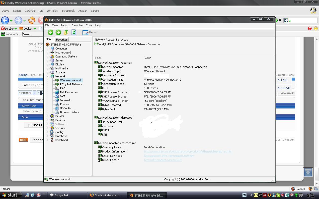

HUSEYIN Posted May 20, 2006 Share Posted May 20, 2006 HII my laptop is aspire 5612 dual core i installed 10.4.6 ist very fast .grafic card working, I have problem audio and wireles. wireles card.intel PRO 3945ABG this working? Link to comment Share on other sites More sharing options...

Perchik Posted May 31, 2006 Share Posted May 31, 2006 HII my laptop is aspire 5612 dual core i installed 10.4.6 ist very fast .grafic card working, I have problem audio and wireles. wireles card.intel PRO 3945ABG this working? Ok. I have a different laptop, but I have dual core, 10.4.6 with audio and wireless issues, and the intel pro 3945ABG set. I'm playing around with some things right now, I'll let you know what happens seeing as we've got the same thing in different cases lol (inspiron 6400) Ive actually also got a Broadcom 440x Any suggestions on how to get that to work would be appreciated Link to comment Share on other sites More sharing options...
