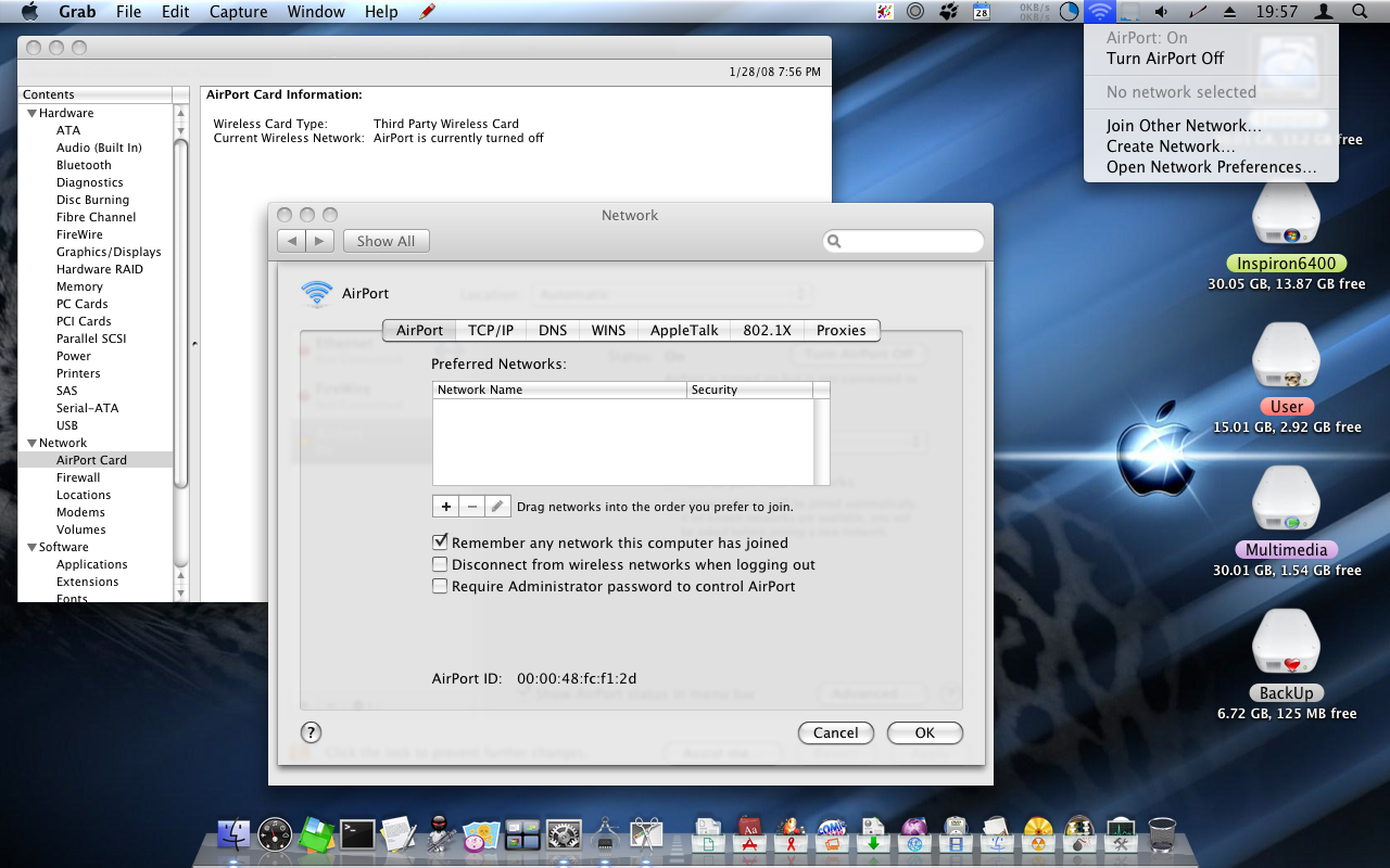

Hi all 3945 users.
Here is a capture of my screen with weird reports.
System Profiler - it says AirPort is OFF
AirPort Bar Menu - it says On (actually Turn AirPort Off any try to close it was not successfull).
Which is true from the two above?
Anyway the mini PCI-e card was recognized, that's a very big step ahead, and has an ID associated.
No results on test to phisical open (combination Fn+F2), led still closed (meaning INACTIVE, as the System Profiler and Network Utility reports).
