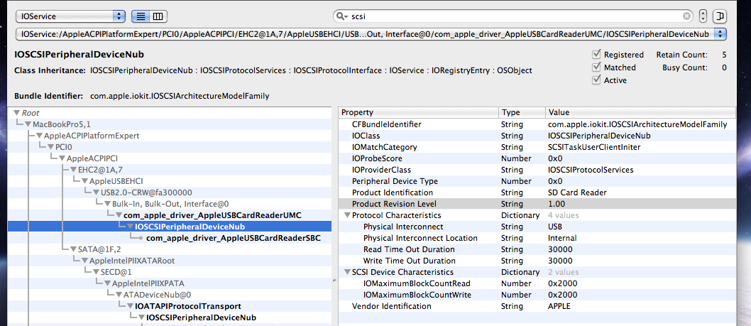

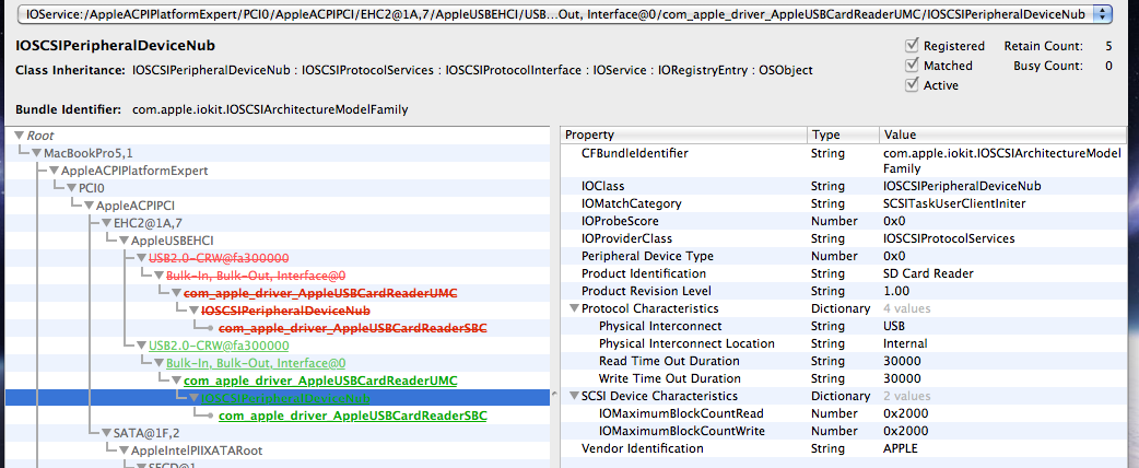

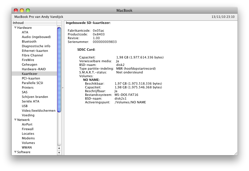

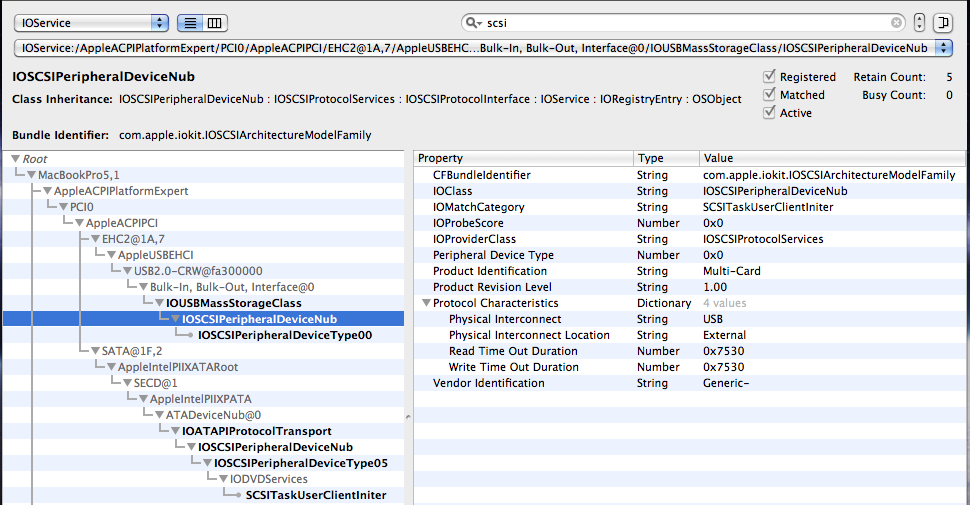

Andy Vandijck Posted November 13, 2010 Share Posted November 13, 2010 I have succeeded in making Apple's new driver for memory cards (since 10.6.5) working on any USB card reader (internal or external) Installation steps: first edit the plist and insert your card readers vendor and device id (where needed). The parts you need to edit for this step are: - Fake Apple Card Reader Device - Fake Apple Card Reader Interface - Fake Apple Card Reader UMC Inject - Fake Apple Card Reader SBC Inject - Any_Internal_SD_Card_Reader_1_00 You can use System Profiler for the vendor + product id's or IORegistryExplorer. The following are the id's you need to look up in IORegistryExplorer: - idVendor - idProduct If you use a text editor convert the id's to decimal with Calculator. Insert them in the idVendor and idProduct parts respectively Then we need to add the SCSI device id's to the following parts: - AnySDCardReaderAnySBC - Fake Apple Card Reader SCSI Inject For this you also need IORegistryExplorer (download below if you don't have it). Open IORegistryExplorer and next insert a memory card (SD/MMC/...) Look under the EHCI parts for finding the memory card host controller (will be green because of card insertion). Under the device look for the IOSCSIPeripheralDeviceNub entry (below the USB device) Click on this and look for: - Vendor Identification - Product Identification Change these in the Info.plist to the values you see there (Fake Apple Card Reader SCSI Inject + AnySDCardReaderAnySBC) Install the edited kext using Terminal or kext utility. Reboot and remove the memory card. After boot reinsert it and you should see a little SD memory card appearing for the SD card (cool) if you did it right and if you check System Profiler under Card Reader the device will be listed as Apple built-in Card Reader. Download for needed IORegistryExplorer tool: http://rapidshare.com/files/430687772/IORegistryExplorer.zip Download: http://rapidshare.com/files/430687534/AnyCardReader.kext.zip Here are some pictures on how it looks like on my computer. Forgot to mention: the default kext id's are for the memory card reader inside the Acer Aspire One D250. AnyCardReader.kext.zip 5 Link to comment Share on other sites More sharing options...

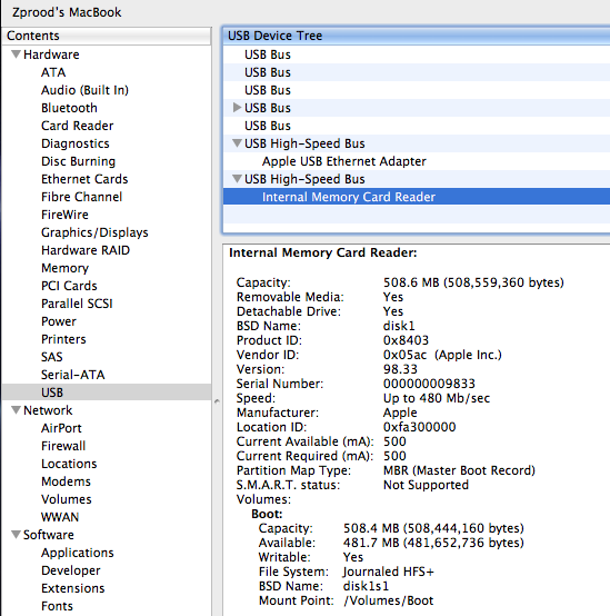

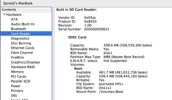

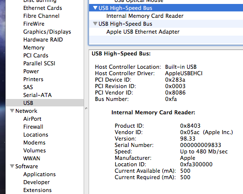

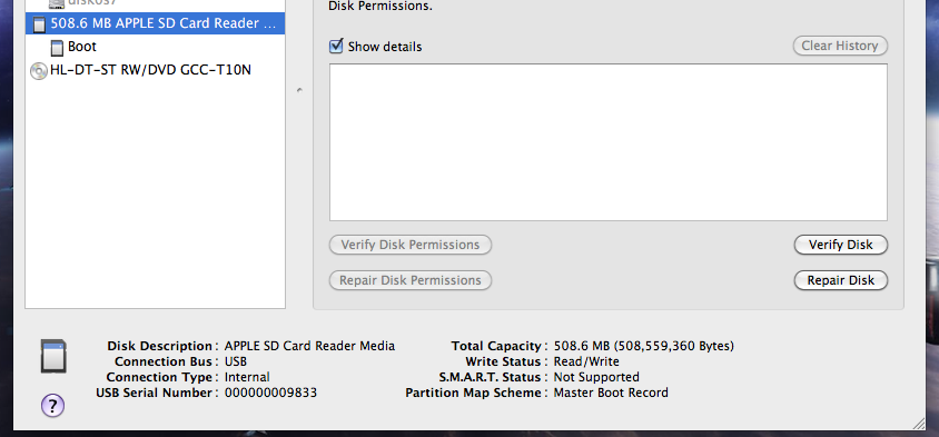

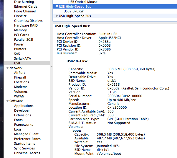

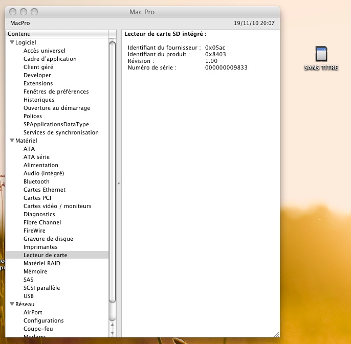

Zprood Posted November 15, 2010 Share Posted November 15, 2010 Yeah, I grap some picture, this is the state and phenomenon . 1, No AnyCardReader.kext, it work normal, just do not show info in the System Profiler and internal device . 2, A,) AnyCardReader.kext installed, not insert SD card before booting. B, ) But when I make computer sleep and wakeup, the card is mounted. see... 3, With SD card insert like above reply I post. Here is the dsdt file, I do some patches to make it can sleep.dsdt.aml.zip Link to comment Share on other sites More sharing options...

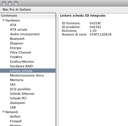

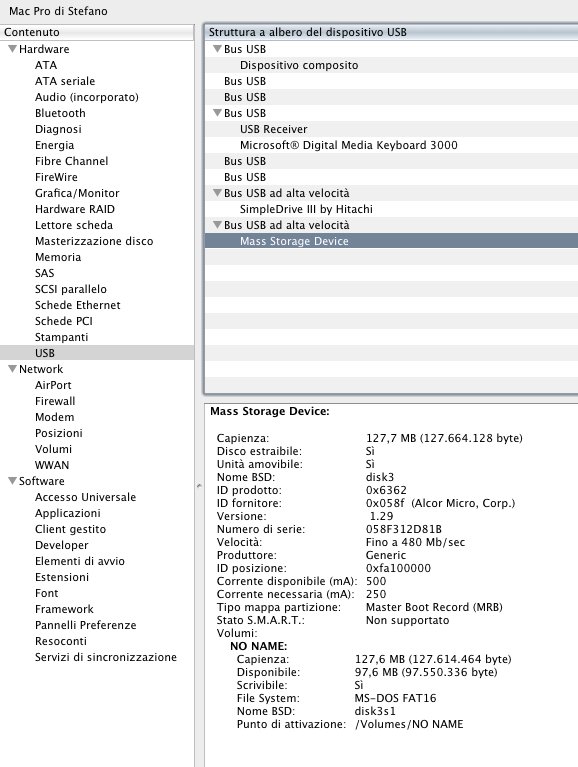

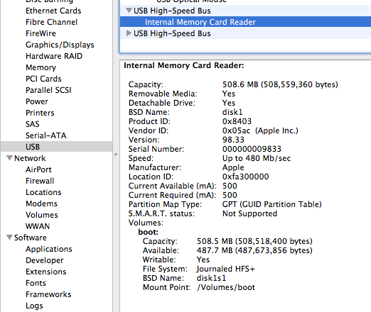

stefano.85 Posted November 15, 2010 Share Posted November 15, 2010 Hi guys, i hope i've correctly modified the plist file. This is what i've got with an sd inserted. I've installed the kext in E/E of my EFI partition p.s i've got a multi-card reader, is it possible to add support for other types of card in this kext? attached two screenshots of system profiler Link to comment Share on other sites More sharing options...

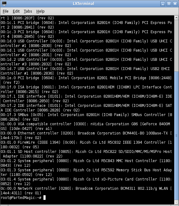

blakken Posted November 16, 2010 Share Posted November 16, 2010 How should I be able to do that if when I insert a Memory Card into the slot nothing happens? I don't have the slot recognized by the system. Into system profiler, it says I do not have a card reader installed at all. What should I do? Download some linux live edition (for instance ubuntu) and load it . Click the terminal and write under the shell the command "lspci -nn" without brackets you'll find the product Id and the Vendor Id of you card reader.Convert hexadecimal number found to decimal and insert it to kext as described above. Otherwise if you have windows installed check the system properties of the sd card ,there should be written as well. Link to comment Share on other sites More sharing options...
alexaffonso Posted November 17, 2010 Share Posted November 17, 2010 Download some linux live edition (for instance ubuntu) and load it .Click the terminal and write under the shell the command "lspci -nn" without brackets you'll find the product Id and the Vendor Id of you card reader.Convert hexadecimal number found to decimal and insert it to kext as described above. Otherwise if you have windows installed check the system properties of the sd card ,there should be written as well. blakken, I did what you said: downloaded PartedMagic, run the shell command and ended up with the following screen, with 4 different entries for Ricoh: I tried to use the first one, but I'm lost. I converted the number 1180:0822 to decimal, which gave me 4480:2082. Is this correct? What is the idProduct and idVendor? Should I use these numbers? I tried then, but no lucky. Could you help me again? Link to comment Share on other sites More sharing options...
quinielascom Posted November 17, 2010 Share Posted November 17, 2010 blakken, I did what you said: downloaded PartedMagic, run the shell command and ended up with the following screen, with 4 different entries for Ricoh: I tried to use the first one, but I'm lost. I converted the number 1180:0822 to decimal, which gave me 4480:2082. Is this correct? What is the idProduct and idVendor? Should I use these numbers? I tried then, but no lucky. Could you help me again? your internal card reader is not USB, is connected through PCI bus. Link to comment Share on other sites More sharing options...
