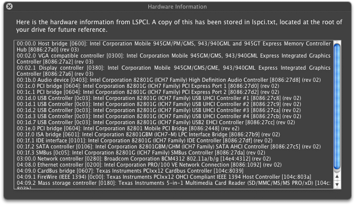

mschilling Posted January 4, 2009 Share Posted January 4, 2009 Can someone tell me what I have from this? Link to comment https://www.insanelymac.com/forum/topic/93241-how-to-get-the-scroll-working-for-synaptics-trackpads/#findComment-1026515 Share on other sites More sharing options...
