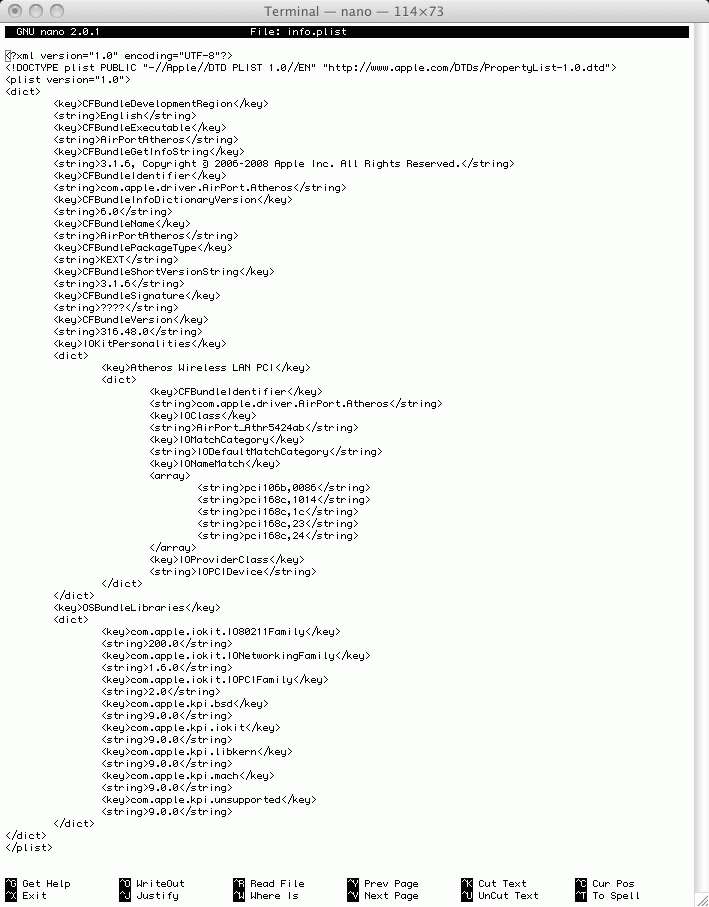

Thanks everyone. I feel like a midget asking giants here but...
for WiFi, I'm having issues. I have the Atheros card (windows tells me so)
Under: /System/Library/Extensions/IO80211Family.kext/Contents/PlugIns/AirPortAtheros.kext/Contents/info.plist
(btw, my install of OSX does not have a dot between IO802.11family.kext)
I have IONAMEMATCH rather than IOPCIMATCH... is this the same thing? I added the extra string to the IONAMEMATCH section instead but, alas, a no go.
Do I need to add another key called IOPCIMATCH?
Also, right now the little wifi light underneath the screen is not lit up. Does that make a difference. If it does, how do I go about turning it on (yes... the physical switch at the front of the laptop is in the "ON" position).
Thanks in advance for any help that you may be able to provide.

Adding it under IONameMatch is fine, you have the right file. The light will not ever light up, and OS X ignores the hardware switch for wifi (but not bluetooth).
