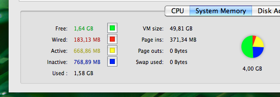

drunknbass Posted February 27, 2008 Share Posted February 27, 2008 ive built 2 badaxe 2 systems and they work great, but i wouldnt buy that mobo now.. i actually just bought an asus maximus and it works out of box 100% with kalaway 10.5.1 and guid efi vanilla i didnt know about that ram thing. thats wierd.. i have 8 gb and menu meters says 1700 used 6500 free but then activity monitor shows this im confuesd by inactive and free, also where do you check if leopard is running in 64 bit mode? Link to comment https://www.insanelymac.com/forum/topic/87311-ordering-my-hackintosh/#findComment-645307 Share on other sites More sharing options...

muitommy Posted February 29, 2008 Share Posted February 29, 2008 ive built 2 badaxe 2 systems and they work great, but i wouldnt buy that mobo now.. i actually just bought an asus maximus and it works out of box 100% with kalaway 10.5.1 and guid efi vanilla i didnt know about that ram thing. thats wierd.. i have 8 gb and menu meters says 1700 used 6500 free but then activity monitor shows this im confuesd by inactive and free, also where do you check if leopard is running in 64 bit mode? leopard is running in 64bit mode in default. what's wrong with your activity monitor's report?? inactive + wired + active = memory used free + memory used = 8G Link to comment https://www.insanelymac.com/forum/topic/87311-ordering-my-hackintosh/#findComment-648671 Share on other sites More sharing options...
